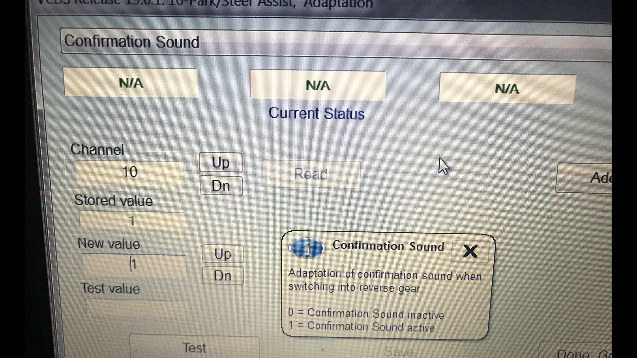

I was playing around with my car after fitting a new gateway this evening and it looks like you may be able to turn off the notification beep with VCDS.

Rather than turn it off completely you can lower the volume right down, this can be done from within the PDC (Park Distance Control) menu.
