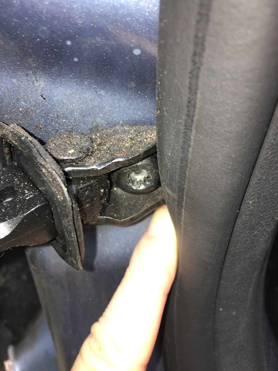

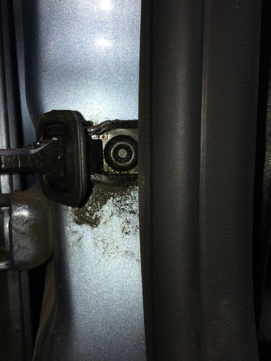

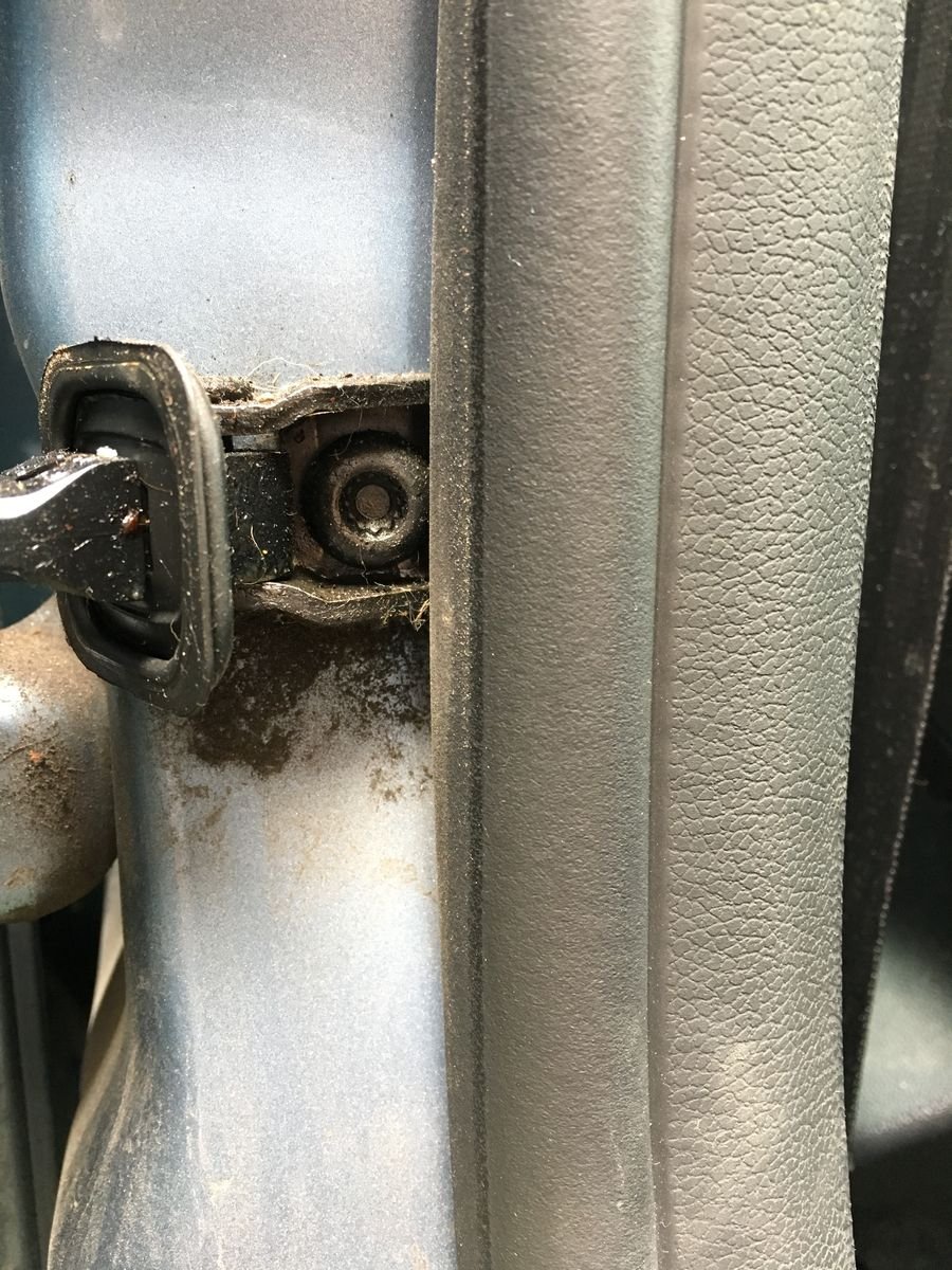

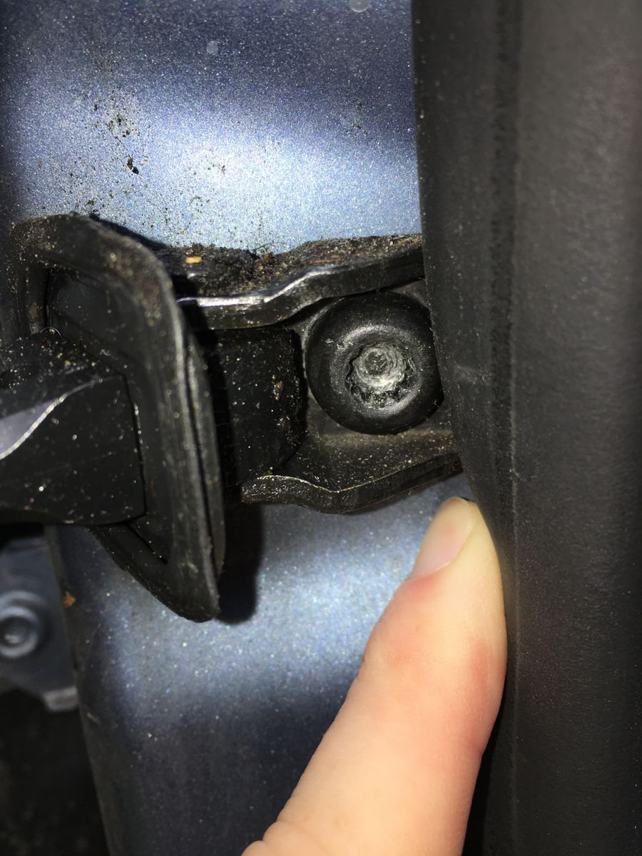

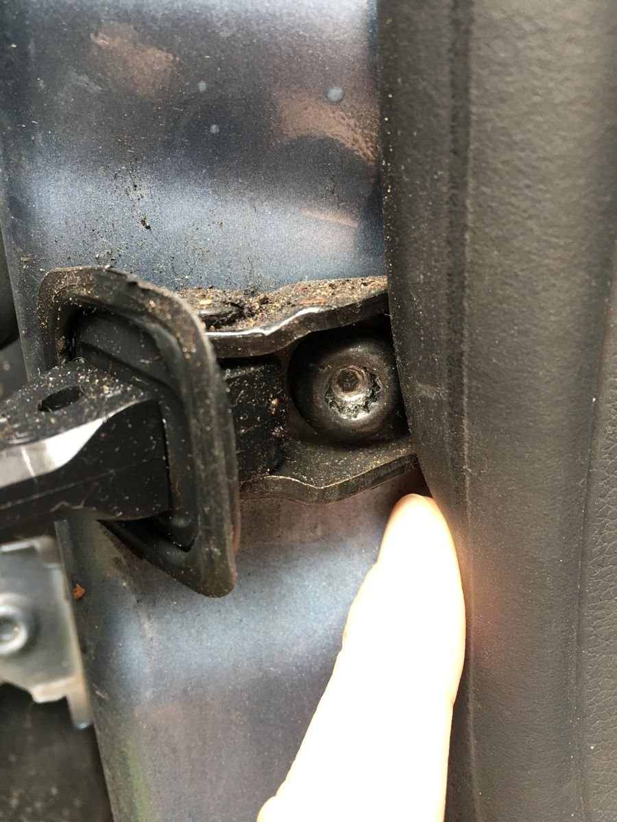

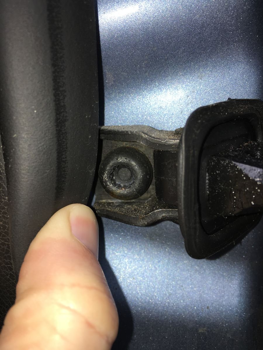

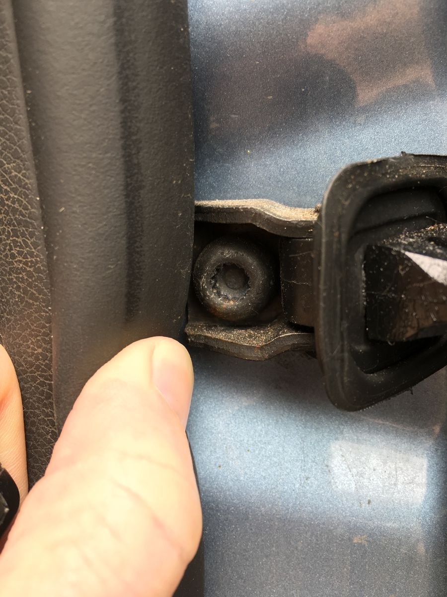

Hi Everyone,
I've attached some photographs, from the same screw in different locations in the car.
I just need to tighten the one on the passenger door, but I don't have the correct 'bit'.
I assumed it was a 'Torx' bit, but it seems to have lots more teeth than that.
I've tried all of the torx bits I have, but T40 is the biggest I have and that was still too small.
For the time being, I used a flathead screwdriver to get in their and make it 'tight enough', but I obviously don't want to damage the head.
What bit do I need?
Thanks,
Damian

It will be one of these  (from the advert)  Spline bits x 30mm and 75mm: M5, M6, M8, M10 and M12

M8 XZN bit, I think.
Thanks Wino,
Just ordered the set. Thanks again for the link nige8021!
The set worked perfectly!
Right tools for the job. 🙂
