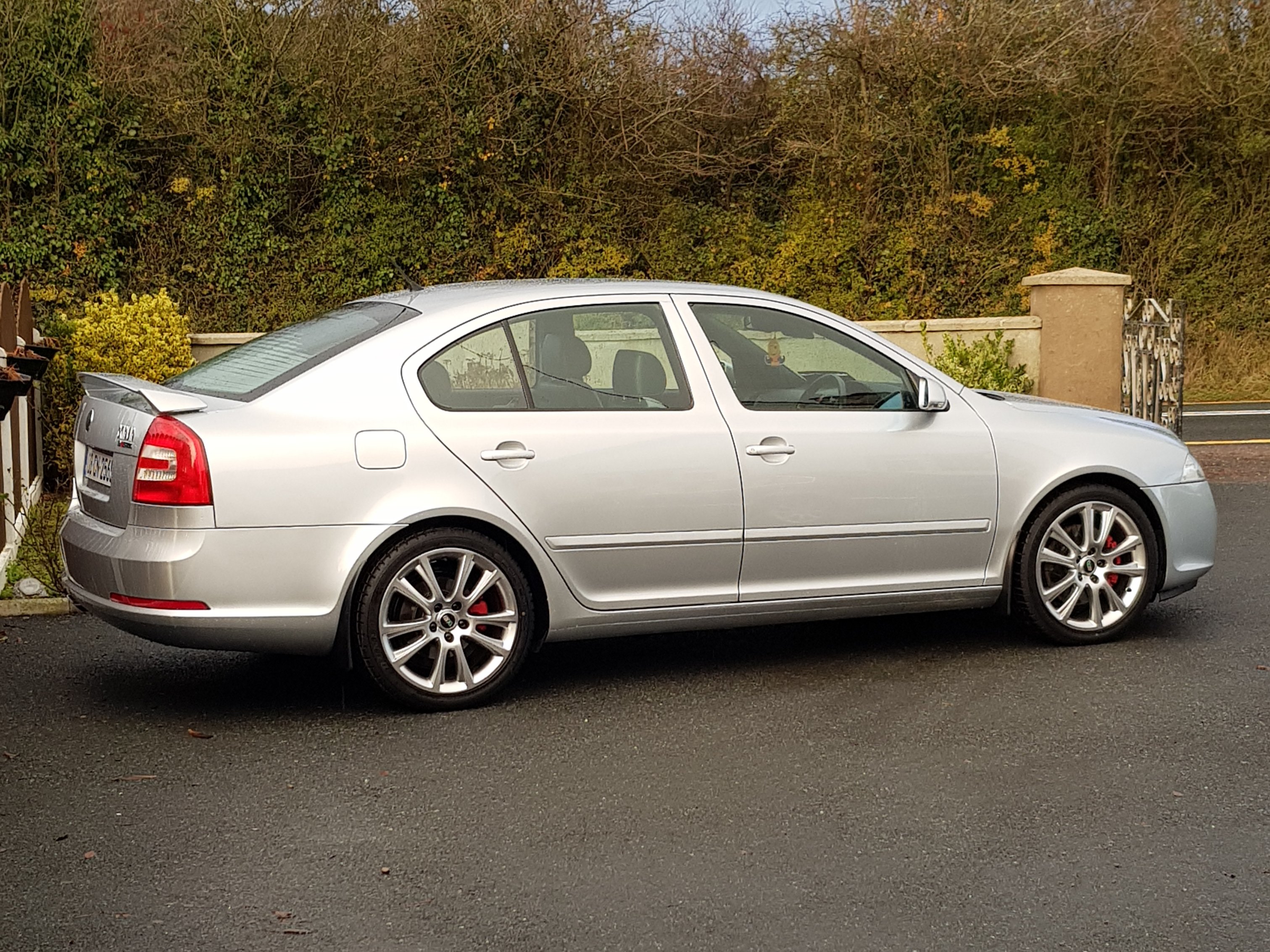

Fitted a H&R 35mm cup kit to my pre fl last year and find it very good. I was the same, didn't want to go very low and was thinking of uprated springs with standard shocks but glad I went with the H&Rs (from DPM) Only lowers around 15mm on an RS and to be honest if your current suspension is tired (like mine was) then it's probably already as low as what this kit will make it. Ride is super smooth on main roads and a little harsher on bad roads as you would expect but to me it's no worse than the standard RS. Feels tighter and a better drive in general. Pic to show it didn't slam the car.
