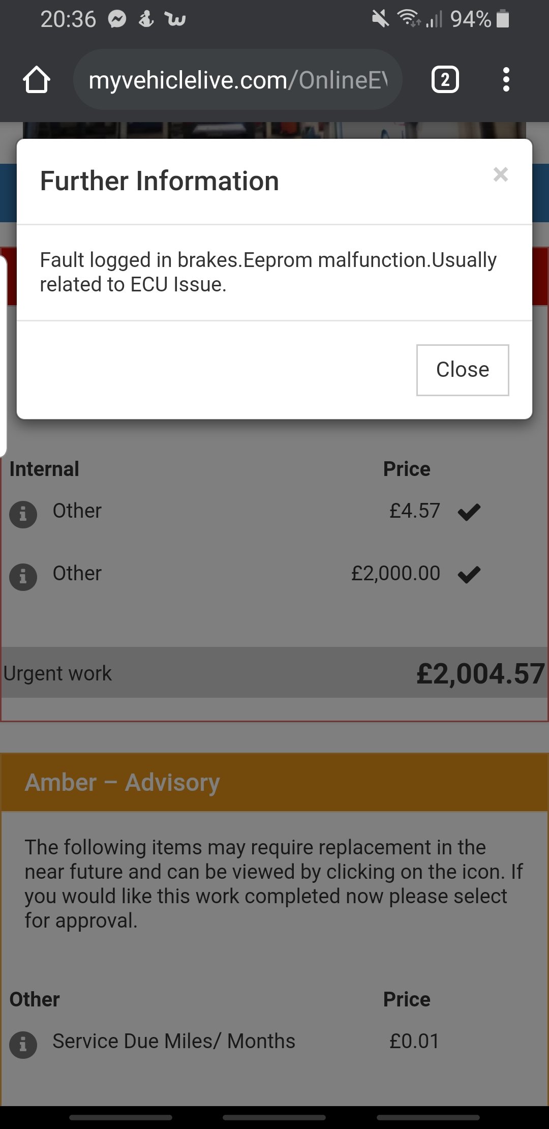

This is the fault that they sent me on their online.
But yes for an ABS module (or pump as the technician said) this is the cost all in. I am going to write to skoda UK about the cost.

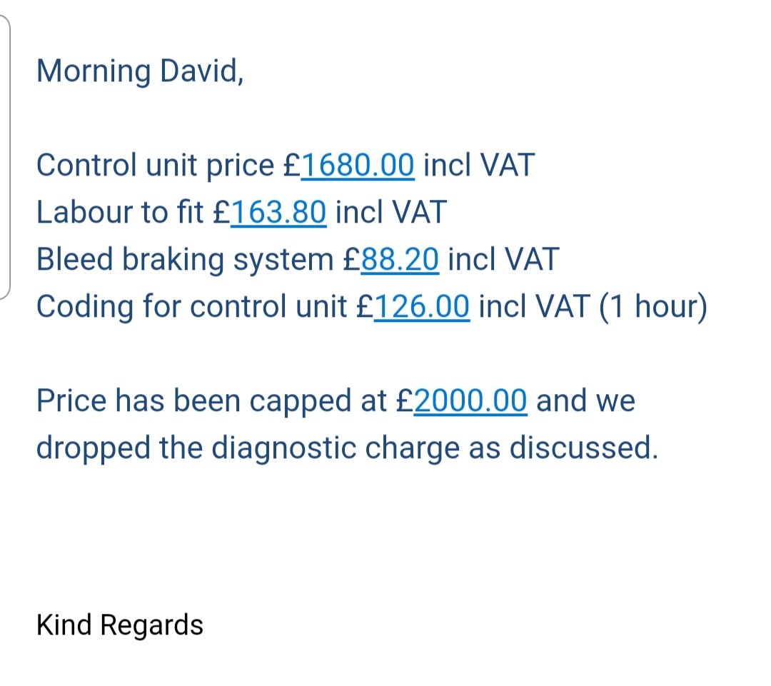

Here's their breakdown anyway..

That should read, bend over David while we shaft you for 2 grand!
I did say on your Facebook page that if it was the ABS module it would be pricey however for the sake of a couple of hundred quid I'd buy a second hand one and try it out as if it works your quid's in when you sell the car, Decide to pay skoda for that and then sell the car your not going to make much coin back.
