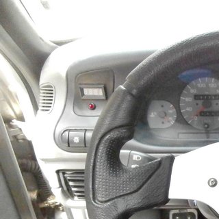

Unfortunately my up an left side for the on-board is ''taken'' for the 2nd alarm indicator and a digital thermometer for an antifreeze leak.
My ''dream'' was to have an OBD II monitor in the console but since i learned ''by the hard way'' that i can not do it so i have to improvise.
Here is an older photo of my console
still i can not admit that i can not have a screen with an application like Torque etc.
@Pickupman : sorry, my intention was not to ''ruin'' your thread but google search will help many Felicia owners to learn somethings from here (as i did in the past).
