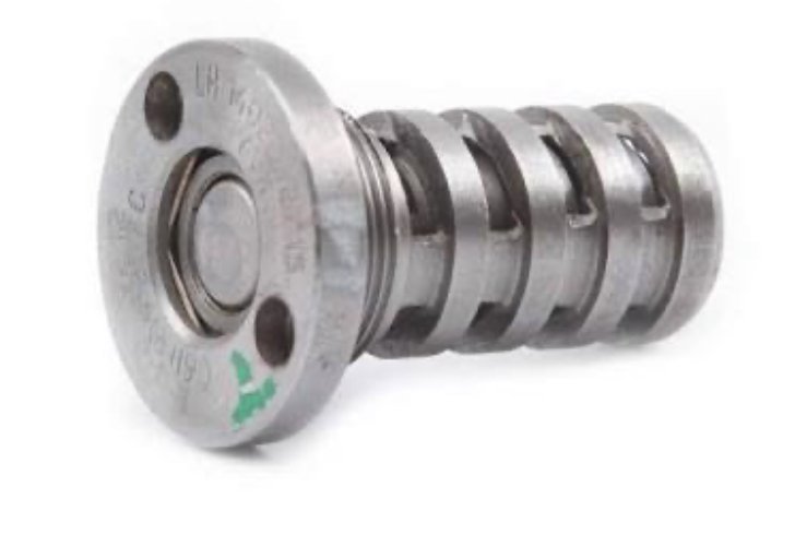

Thanks man ! This solved my problem also. I am going to replace the vvt solenoid and see if that improves it. Thanks a lot been worrying a long time.

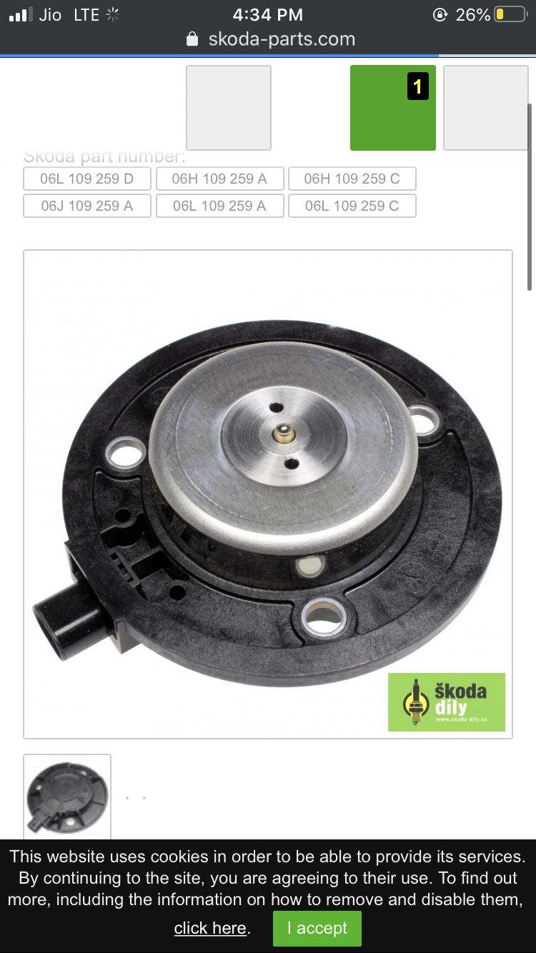

Hey man did you tried to replace the camshaft adjuster magnet ? This part right here
I mean did you try it after replacing the camshaft adjuster magnet ?
Of course I tried, I even bought new OE parts, not reproduction. Still no luck.

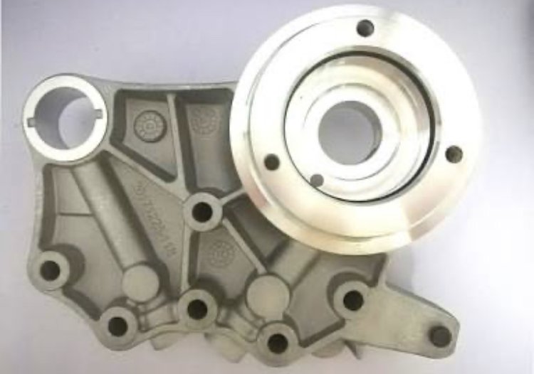

What about the cam bridge ? If the screen on this this goes, its unable to supply enough oil to the camshafts. This part in the picture
