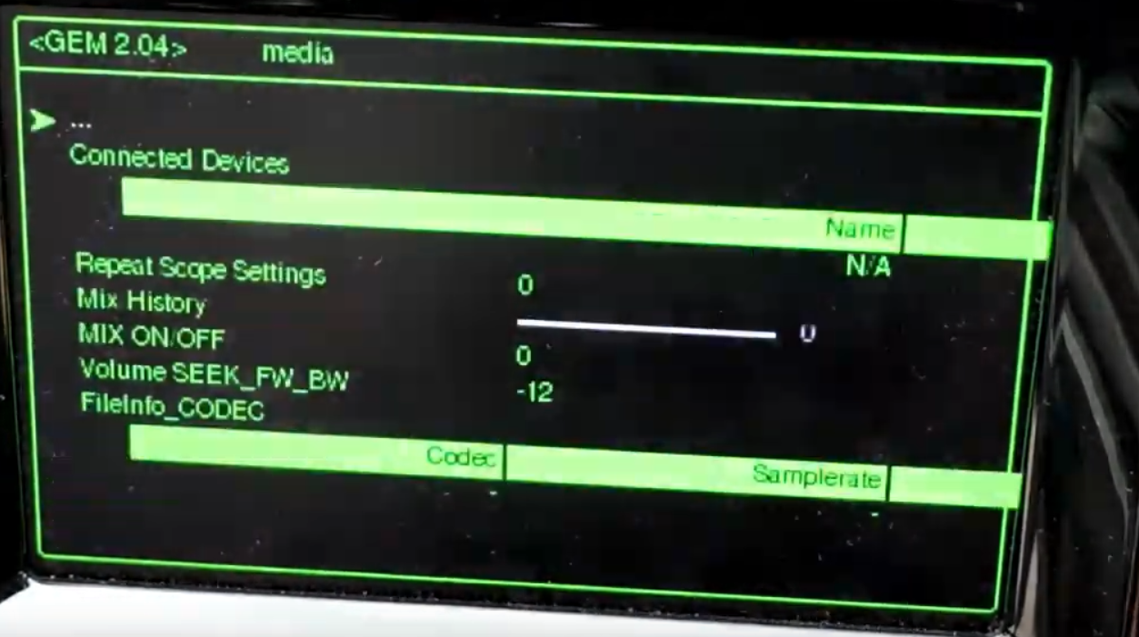

Hello , been surfing the web about my superb  mib 2 (bolero), and i discovered  the the secret green menu.
There was one thing that catched my eye , the media - codecs ...... and my questions is : can this be a possibility to add codecs so that we can play videos from USB or sd card?
Thank you

I realy dont think the problem is cpu, lets think about columbus mib 1 it plays videos and they have slower cpu even. In my last car i had a 2 din pioneer the cheapest one and it played videos...  I think the problem here is pattents and the consumer has to pay for them if he wants to see videos. If you put a mp4 it plays the sound , maybe the missing link is codecs.

Hello again  been googling and i found out that they all have nvidea tegra 3 processor ( mib2 mib1 has tegra 2) can someone correct me if i am wrong .....
