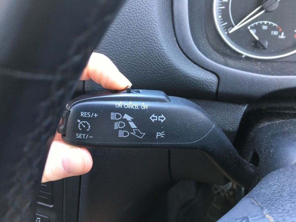

Should click across to "ON" , its definite "click"
image shows where it is when "ON"

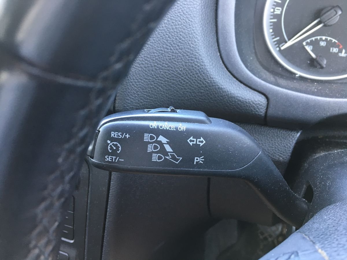

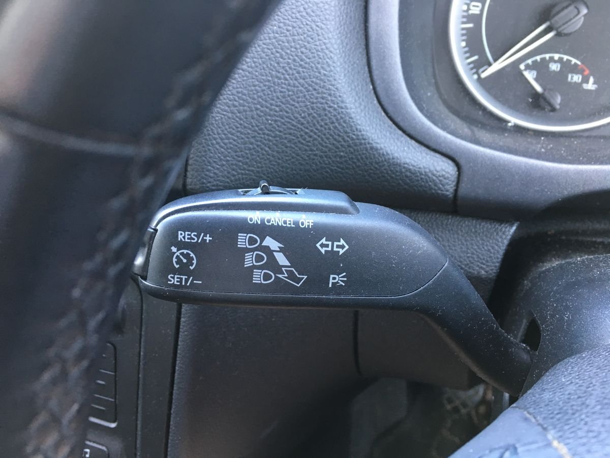

Aaaarrrrggghh 🤭😛
Here are the positions on mine.
The 'Off' is obviously off.
The 'On' position looks like is should go further. Is that right?
And the 'Cancel' position (which 'rocker's back to the left on release) looks OK.
Am I clutching at straws to think that the 'On' position is just not moving for enough? I have tried pushing it further but obviously don't want to break anything.
There was also a comment about 2 switched in the break pedal. Where are they and how can I check them?
Thanks,
Damian

The only way to check all switch functions is with VCDS or a diag system that will read live data. Have that issue diagnosed in 5 minutes.  What you reckon @sharky09?
Tech1e fixed my cruise control after using the VCDS to find that the rocker switch on the end + wasn't working, all sorted in less than 15 mins to fit a new stalk😉
