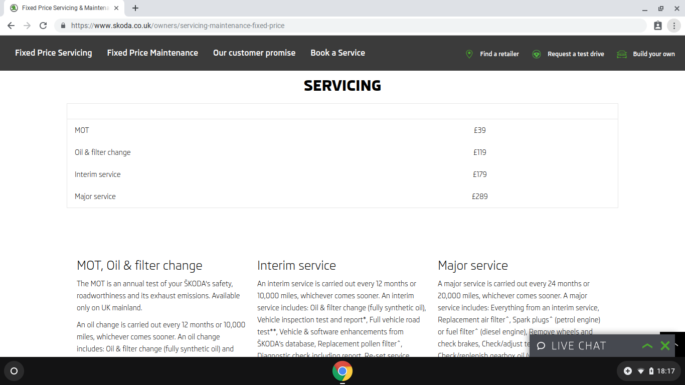

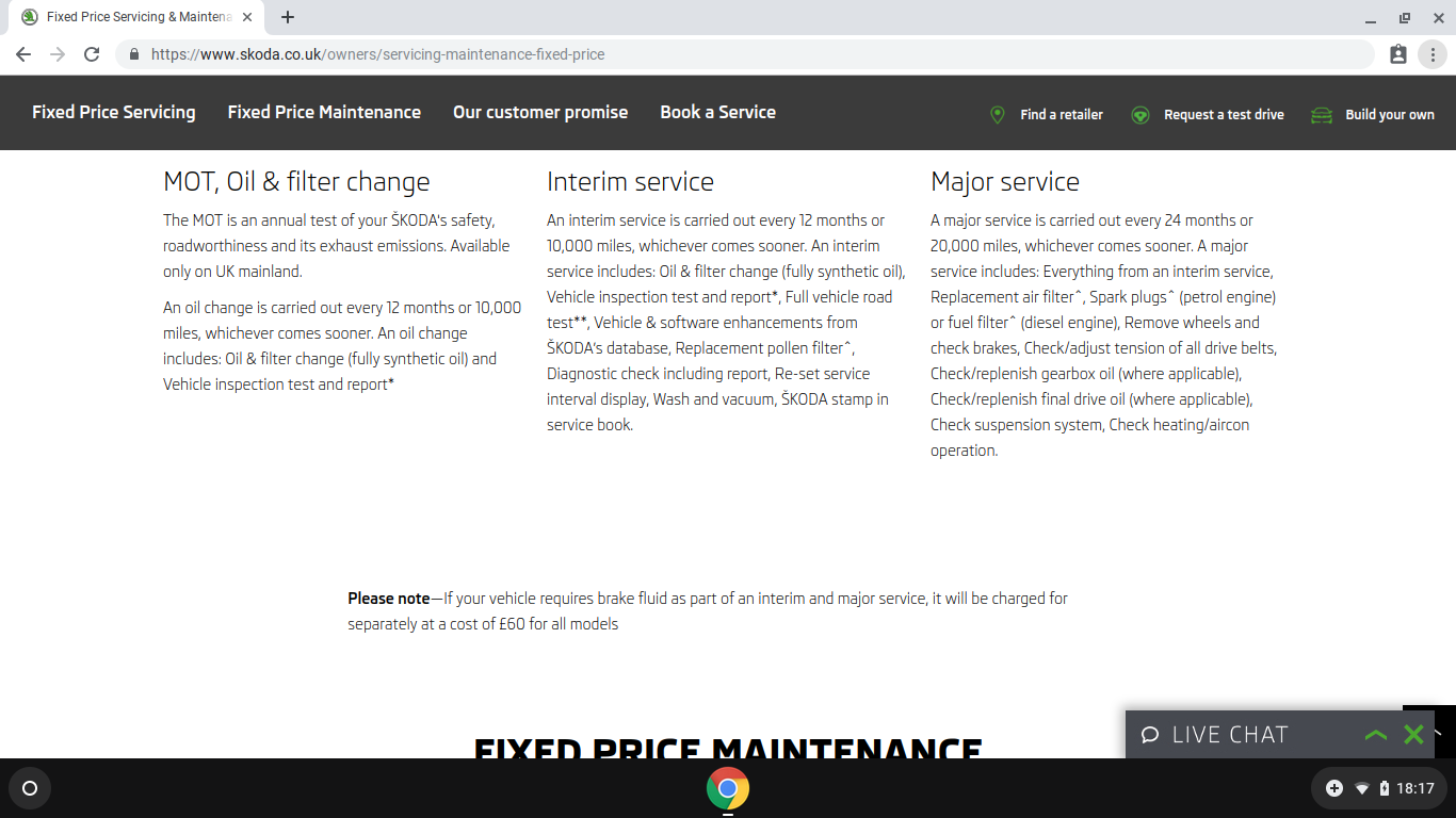

http://volkswagen.co.uk/owners/servicing/regimes

Car health checks should always be done by Main Dealers when a vehicle is in,
the Menu above for Fixed Services on cars shows what 3-10 year old cars can get, as a minimum that is.
Nothing is done for nothing, just the Expensive 'Free wash and vacuum'.
You see the Oil & Filter & MOT includes a 'Vehicle Inspection'. £99 and a MOT is done, that will be a Vehicle Inspection that should be good as a Body Warranty Inspection and Pre MOT sort of thing as well.
Or what is the Vehicle Inspection, Test and report ?
Up to a few years back there was a Minor Service which was also called an Inspection Service at 9,400 miles / 372 day or sooner,
and what was called a Major Service 9,400 miles / 372 days or sooner next.
Time about.
Body Inspection for the warranty was supposed to be done at each.
Now there is Fixed Service or Major and have a major done sooner than 18,000-20,000 miles / 24 months if you want.
