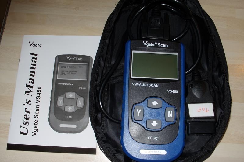

The VS450 works fine on my 2003 Fabia.
Also used to have super-cheap U281 which worked too.

I use a Carista Bluetooth code reader on my MK3, also used it on my MK2 Octavia and Superb. It doesn’t seem to do the whole works on out MK1 Fabia though so shall get one of the cheaper ones recommended above

The VS450 works well on my 06 Fabia, it also detected an EGR fault on my mates transit. If your not going to be coding etc it's half the price of a garage scan and it's yours forever!
