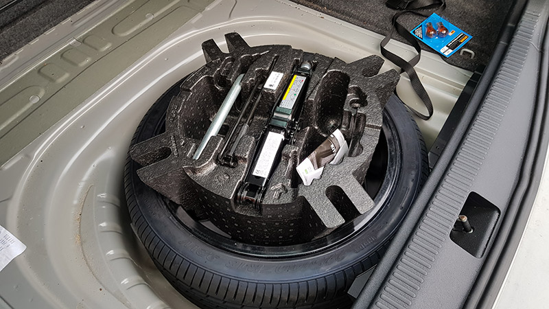

Thinking about doing this instead of getting a spare wheel.  When the front tyres are down to ~2mm, just buy a new Gemini and use one of the existing ones as the spare with the legal tyre on it.
Would just need the insert.  Did you buy yours or did your car come with a space saver and kit?
11 minutes ago, Alex-W said:
Hatch or Estate?
The foam insert came with the Space saver, I just cut the lugs off on the outside and cut about an inch/inch halve off the bottom to make it fit into the wheel.  If you can get an insert from an older Skoda octavia, before the days of space savers it should fit without the need to cut it. I bought the wheel from member " Call me Gaz " I had 4 new michelins fitted on the car so I used one of the OE Bridgestone tyres as a spare.

Maybe I'm being stupid here but what wheel is that insert intended for if you have to trim it to get it in a 18" wheel?
It sits on a Skinny space saver wheel On it, not in it
Ah, gotcha.
Why is one of the above recessed and one 5mm proud?  Are they different wheels?

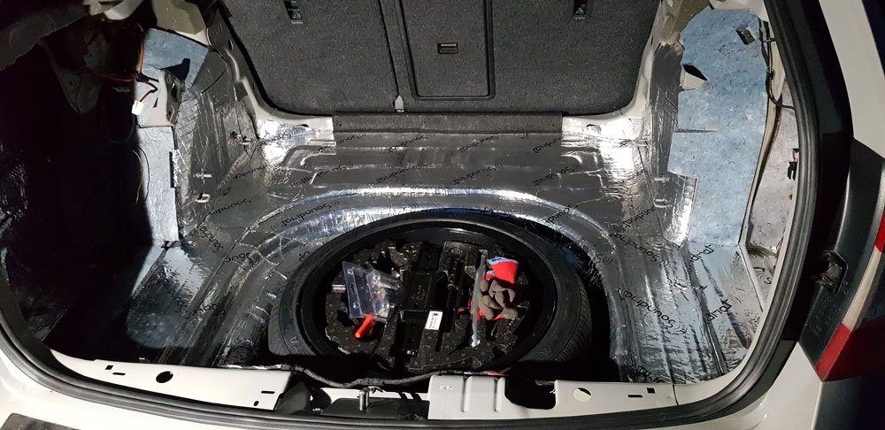

Would it be possible to fit a full size "19 Xtreme with that setup, or is "18 probably the limit?
I'd take a punt and say Yes. The 19"s have a 35 profile and the 18"s a 40.  There is a little unused space still in the wheel well with the 18"wheel in place. Both wheels are 7.5 wide
19 hours ago, Alex-W said:
Ah, gotcha.
It could be the tyre, I have Michelin PS4'S. Some tyres have a more pronounced Rim protecter
Based on that photo I thought so too 👍 - when I do the full Revo switcheroo, I'll be keeping one behind for the spare and chuck the other one with whiteworm away. Cheers for the suggestion
I'll nip out in the morning and measure the gap between the tyre and the wheel well, It's raining at the moment. Leave it with me
The rolling diameter of the 18" and 19" is essentially the same.  From memory it's something like 2mm difference in radius, which is within the tolerance of wearing tread.
a 19 will fit as well, ive tried it.
