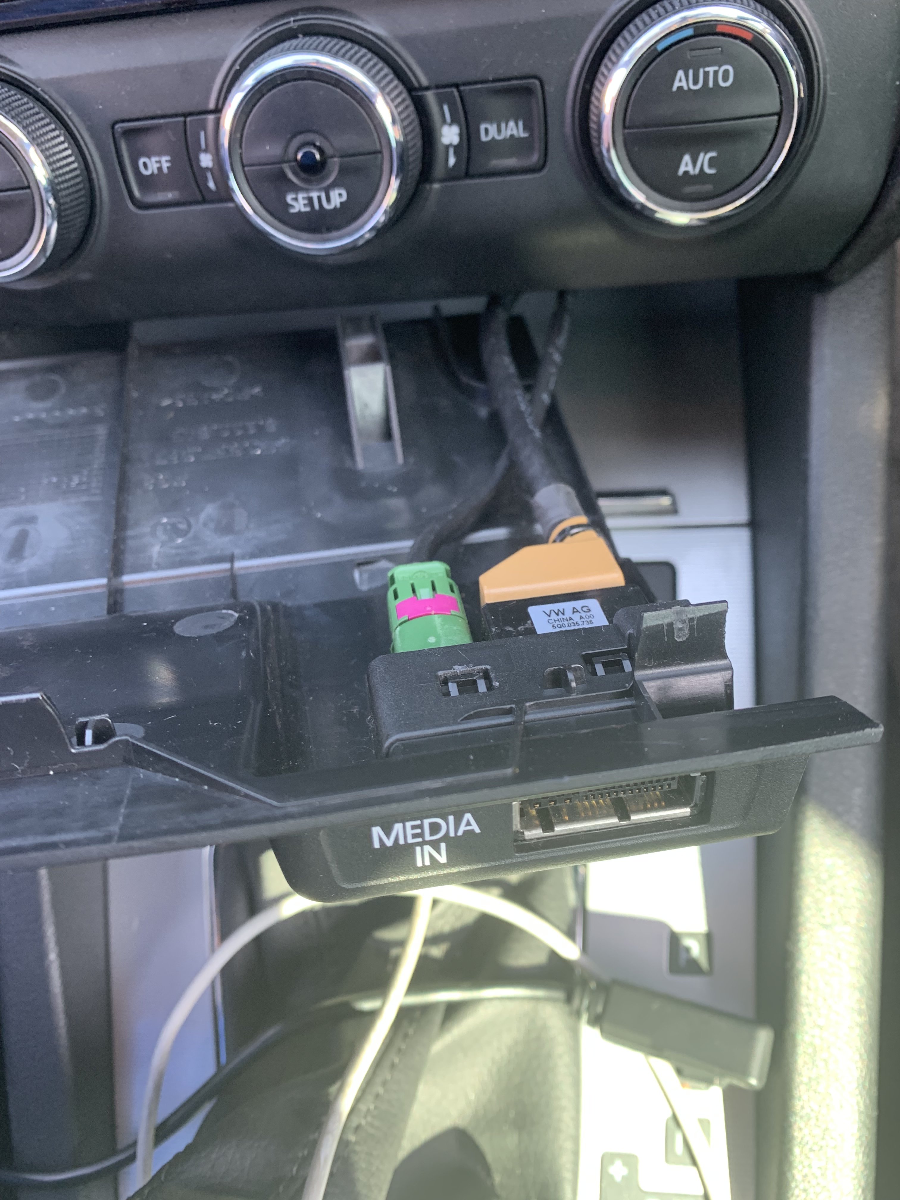

My harness looks like this - is there an adapter to convert to USB ?
Hmmm, the loom looks different on the Aux side. Not sure, will have to research it.
Thanks I really appreciate you looking and the help you’ve given so far

I can’t copy and paste here now for some reason but you’ll need a 5G0035222F cable set from AliExpress to replace the cables you have now, then you’ll need a USB/Aux trim with the USB and Aux. Make sure it’s a 5Q0035726E green tipped USB.
Would swapping this cable set and USB port be enough to get my mib1 working, or would it need additional coding? If so is that possible with VCDS ?
It would require coding to deactivate the MDI and activate the USB/Aux. It would only give you USB/Aux on the MIB1 though. If you are staying MIB1 I would get a dedicated MDI plug as there is no advantage to changing it unless you were going MIB2.
