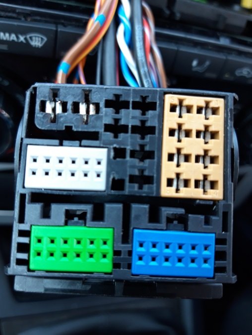

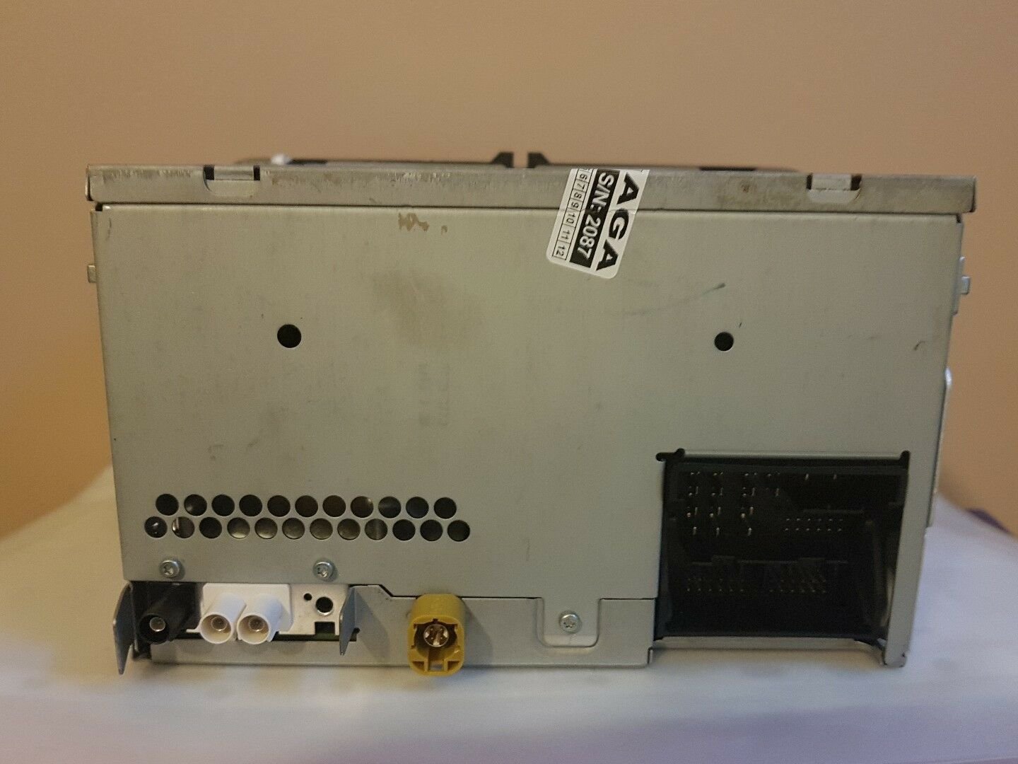

I believe I have a Bolero infotainment system installed and I would like to change out the radio for a Sat Nav system. I removed the radio and the car iso harness appears to incompatable with various ISO sockets on the back of the Sat Nav units.  I have attached a photo of the car radio harness. Can anyone recommend what Sat Nav would be suitable please Thank you

I bought one from website which said it would fit the Yeti year (2015) but iso harness supplied did not have the two power sockets (top left on photo) so sat nav was not able power up. Another unit was sent. Same result. Have scoured websites for sat nav which show the rear of units iso power socket, which would show the two Male plug ( to marry up with the car radio iso harness) but have not been able to locate any photo of a sat nav which would fit.  I do know that the Yeti for that year offered a Sat  Nav as an option, but cannot find a used one on sale anywhere.  Any suggestions would be warmly welcomed. Thank you for your response.
That's a 52 pin quadlock. The MIB PQ STD2 style Amundsen as fitted from 2015 onwards Yeti would be the original fitment sat nav.
Older cars used a 40 pin quadlock. They would have used the older RNS style Amundsen, Amundsen+ or Columbus for navigation.

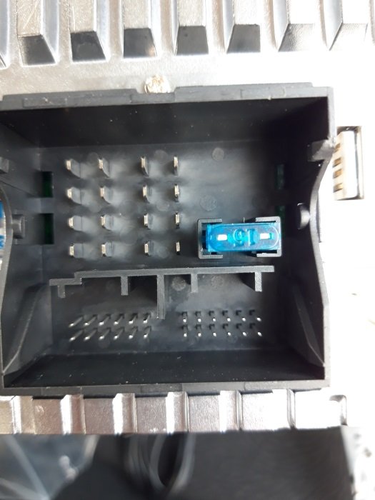

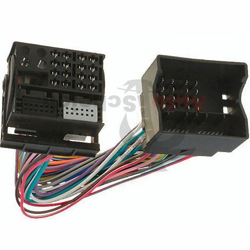

Hi Rustynuts,  I don't think it will because the the Yeti  car harness is a female Quadlock socket (see photo 1), whereas, the one you suggest (see photo 2) is also a female Quadlock socket.  What is needed is a Male plug (photo 3) to marry into photo 1.; and the corresponding end of the  harness   to have a female socket (unknown type)  connecting  photo 3  to fit into photo 4.  I don't think there is such a adapter available,, at least I have not seen one advertised anywhere.

Without wanting to sound like a smart arse, the one I linked to is exactly the same as the one I hold in my hand right now. It's a converter from your cars 52 pin quadlock connector to the 40 pin Quadlock connector on the rear of the sat nav unit you purchased. Whereas the picture you posted above
2. Most Quadlock Extension Socket Cable Adapter for VW Audi Seat Skoda Vauxhall Aux.jpg
is a fully populated 40 pin to 40 pin extension adapter and is not what you need.

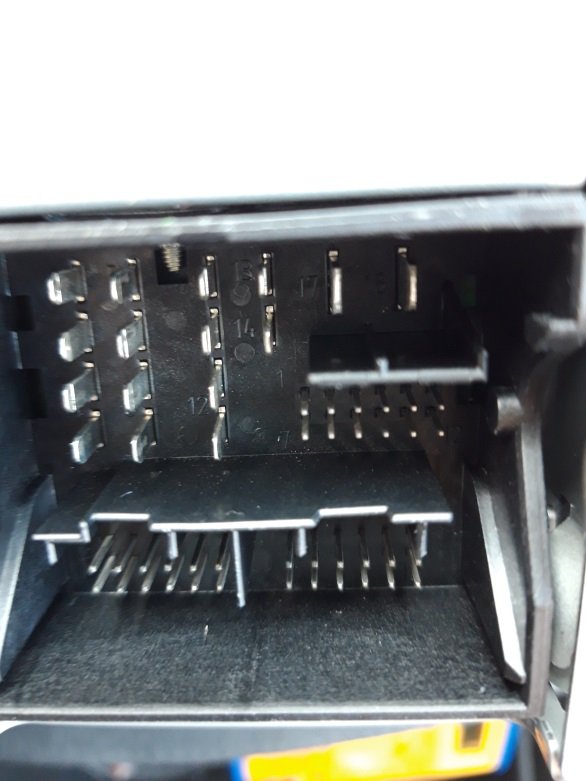

                       Just to ensure that I have a testing of understanding of what is being said..     Photo  1 is from the existing car radio , which I assume is the 52 pin
                       (female socket) to marry into the rear of the Sat Nav  - photo 4 (which shows the 40 pin (Male plug )
                       From what I see from the photo of the adapter you sent, it looks as if  each ends of the adapter is a mirror image of the photos I sent.    Should                          not the pins on the Adapter 52 pin Adapter plug be male & the pins on the 40 pin Quadlock be female?    To ensure I have got it right, I have
                      attached Photo 1  (52 pin  female socket)  and Photo 4  ( 40 pin - Male pins)  in the socket based at the rear of the Sat Nav ??
                      Please clarify if I have got it all wrong. Many thanks again

Be easier to understand if you called them "plug" & "socket" rather than male or female. The plug is the part on your car's wiring loom and the socket is on the car's radio. Once you've got that understood you're on the way.
You have a 52pin plug on your wiring loom which goes into the 52pin socket on the adapter loom. Then on the other end of the adapter loom is a 40pin plug which goes into the 40pin socket on the new Sat Nav.
