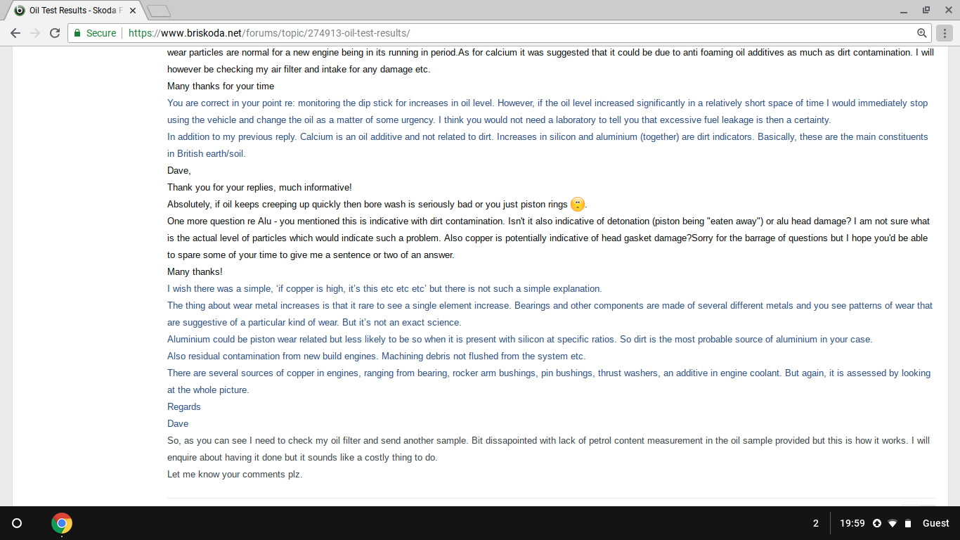

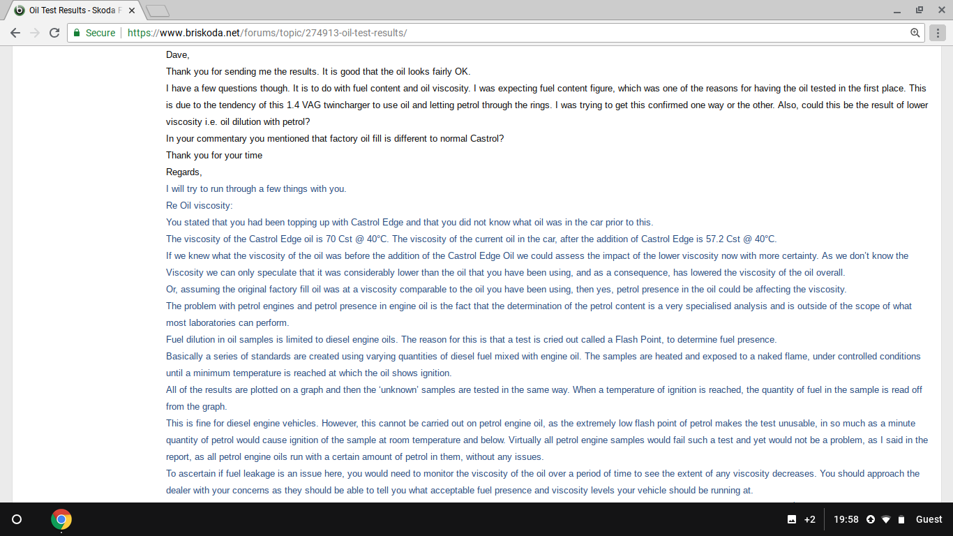

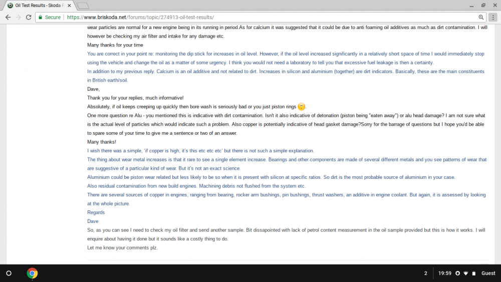

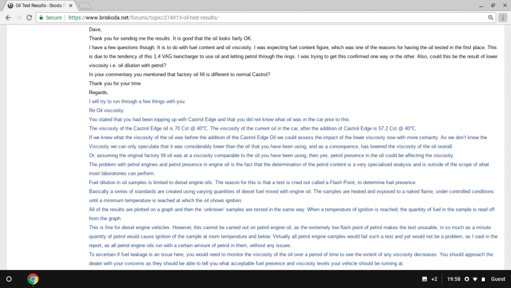

See the 2nd page.  Re Copper.
This was a member here than had oil from a 1.4TSI Twincharger tested in a lab by a friend involved in Motorsport Engineering.
Sadly the posted image of the results have gone.
Post still here though.
