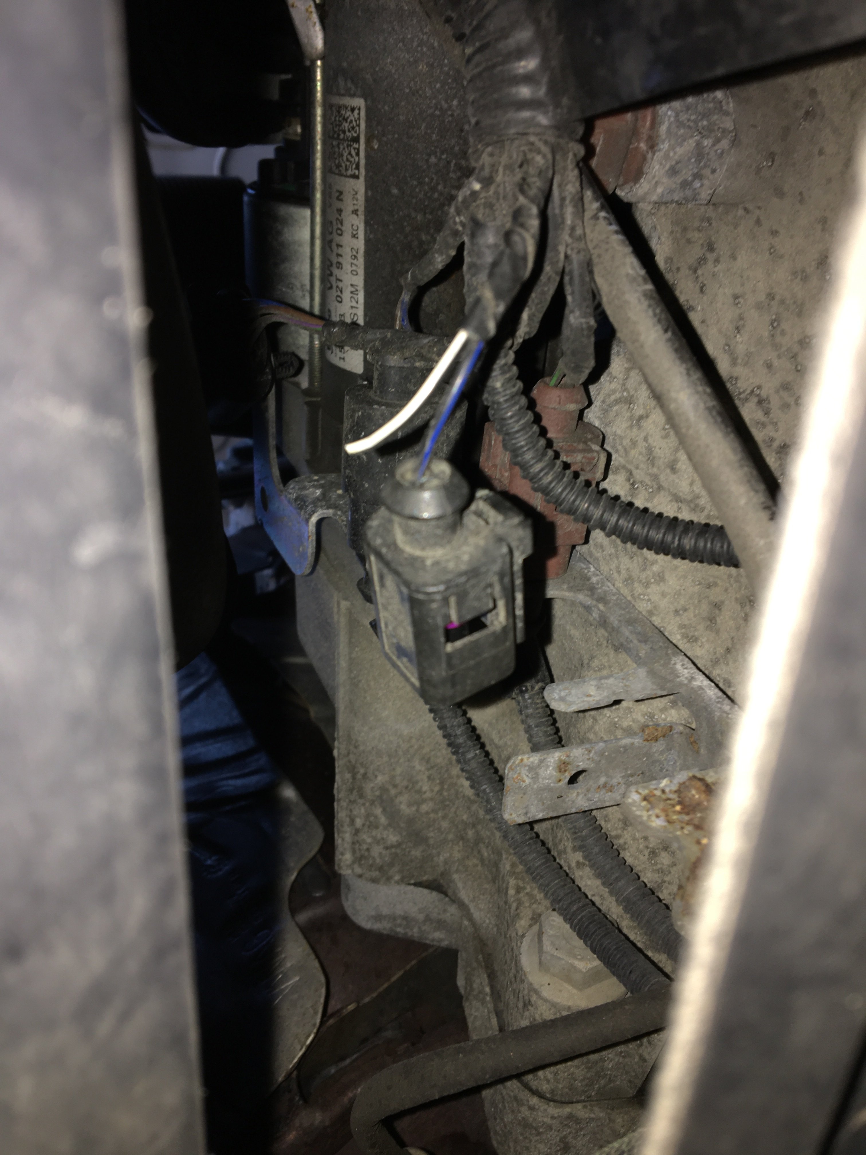

Eventually got round to looking at this. Turns out one of the wire has broke off the connector. See the image.
Whats the crack here then. Can the connectors be sourced and fitted without soldering and all that? Would rather do it instead of take it to a garage, would be a lot cheaper that’s for sure.
I’m hoping so and that it has to be the full harness as that sounds a bit of a chew on!
