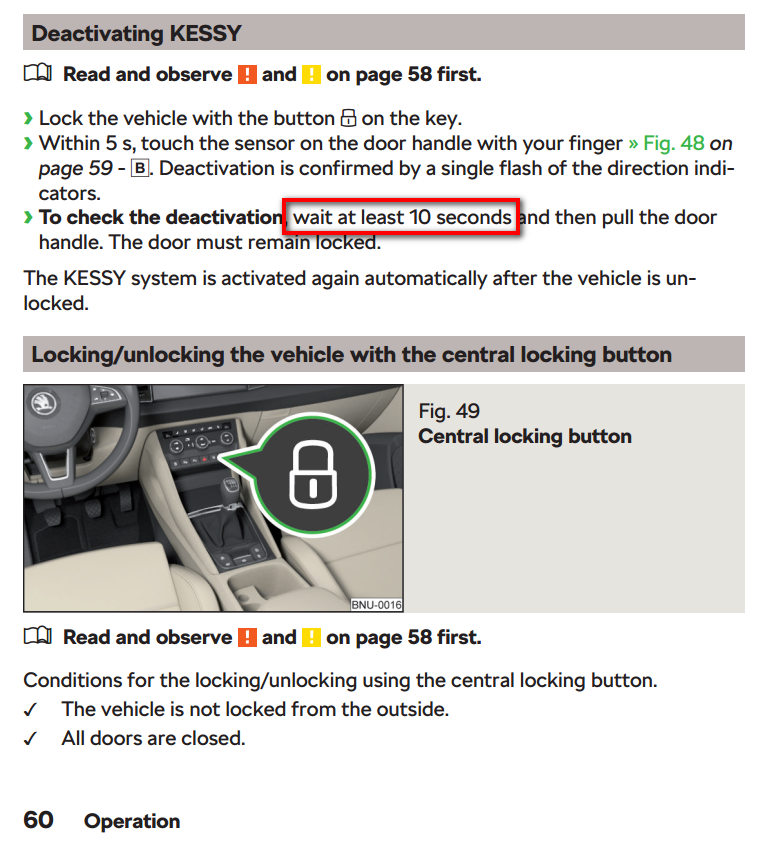

All covered in the owners manual. Press lock on the remote, within 5 seconds press lock indent on door handle.
Activation is confirmed by a flash of the indicators.
After about 10 seconds you can confirm yourself by grabbing the handle and it shouldn’t unlock.

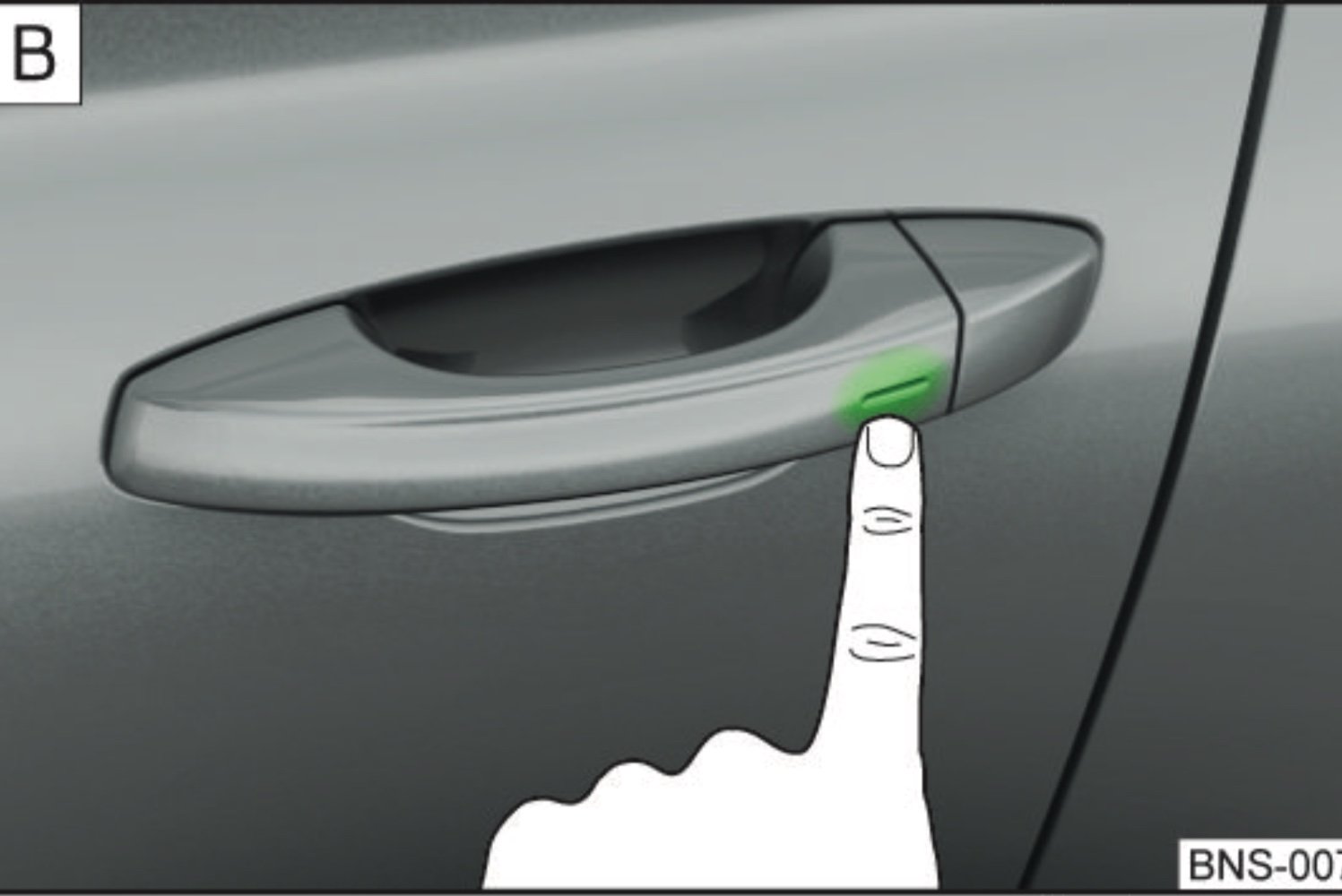

You are just touching the lock indent as illustrated, touching/grabbing the handle part will cause it to unlock
It's either that or you are checking your locking too soon after doing it.

Just touch the sensor, no other part of the handle.
