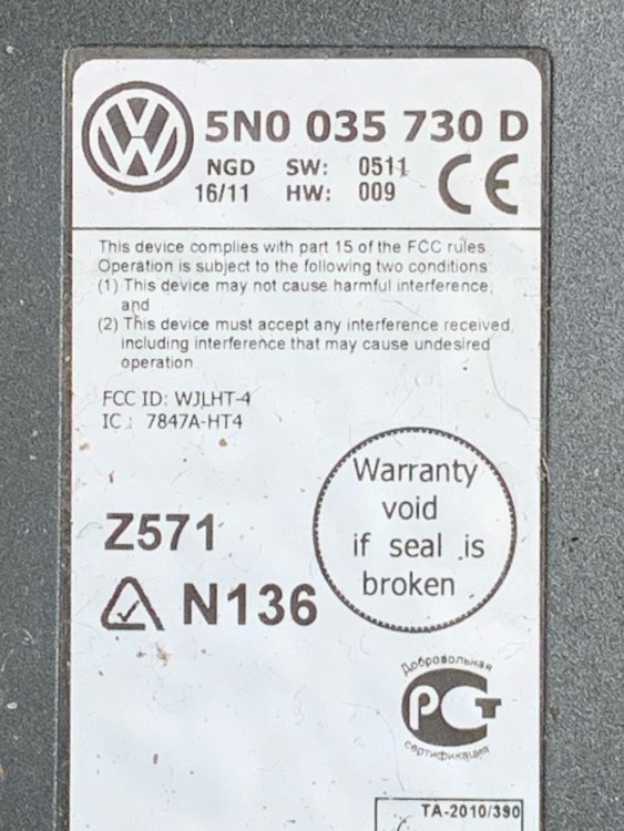

The bloody Bluetooth module in our ‘11 TD170 Elegance failed in Monday after being a bit problematic for a couple of weeks.
Does anyone know which of the modules can be used as a replacement, either as a Skoda or a VAG part number, as I want to be able to spread my search as wide as possible to get it as cheap as possible! Ours unit is a 5N0 035 730 D.

I had 3C8 035 730 D in my MY2014 superb elegance its newer model but should work in older cars too and supports track names in bluetooth also.
