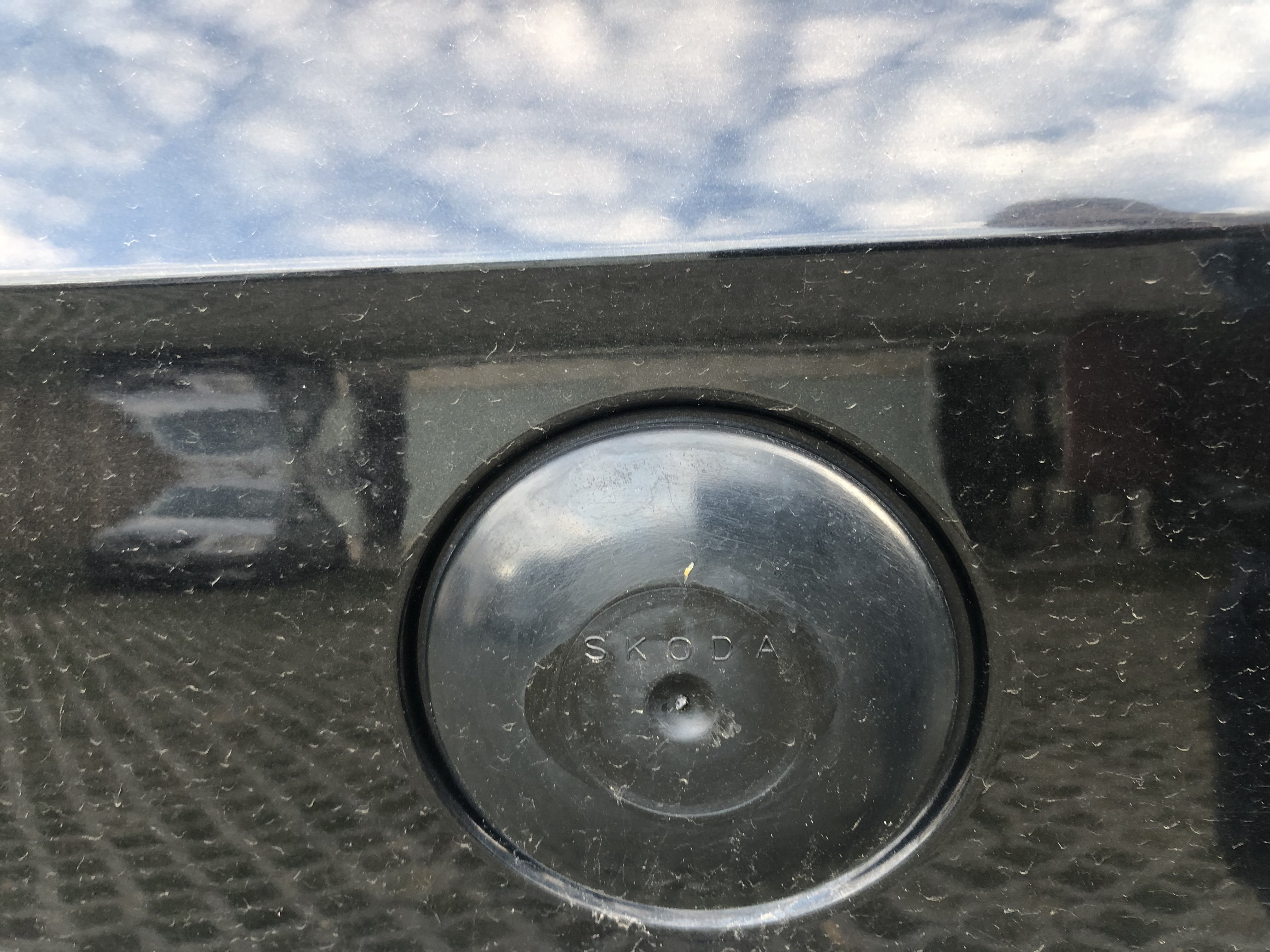

Estate back embleme
Hello
can anyone give me a hint how to remove the remaining embleme?:)
Any hint guys? : )
Heat and patience are the best plan.
When I removed them from my Octavia, I taped over the paint around the badge to protect it and on a hot day, used plastic pry tools to slowly remove it.
use a hair dryer if not raining
Believe it or not..... Dental floss
Use heat from hairdryer, grip ends of a strip of floss, pull it taut and slip it behind the badge, use a sawing motion while pulling downwards (not outwards!)
Did the front and rear badges on mine - didn't use heat on the rear and it was a pain getting the residual "goo" off. Learned, used heat on front, came off like a dream
