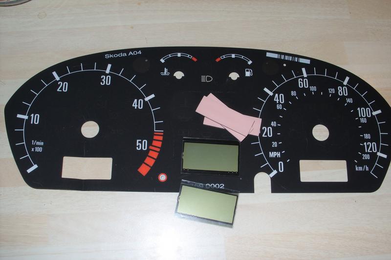

I suspect a dry solder joint on the cluster PCB, suggest you remove the cluster and carefully inspect that area.
Cheers we thought of taking it out and checking wires etc.. thank you
If you have no luck, the little LCD screens can be removed and cleaned at the edges where they contact the zebra stripes. This sometimes works.
Thank you much appreciated
