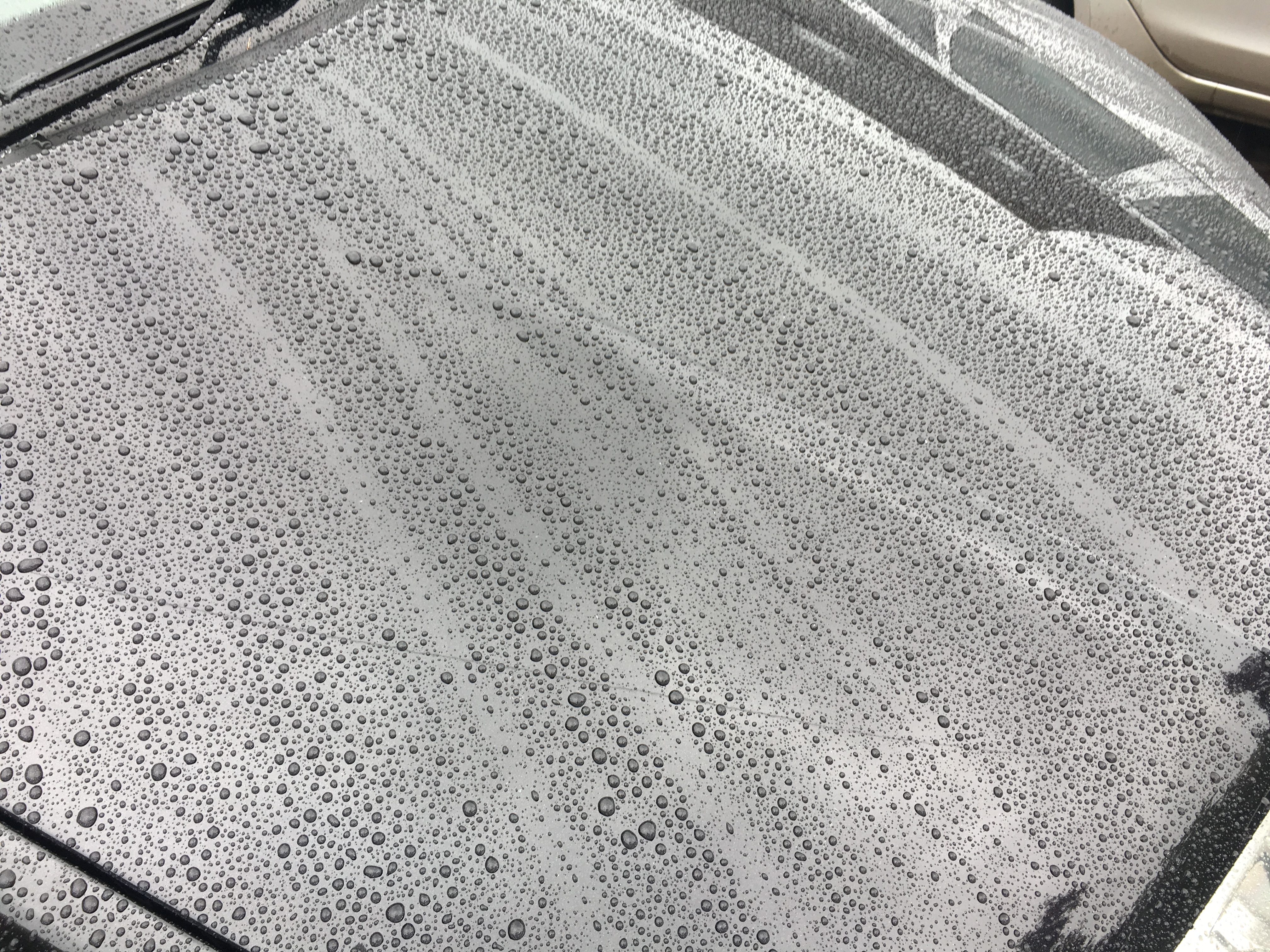

Get a DA polisher, I bought one to do my new black fabia and it makes a huge difference. The steps I used are below:
Wash & dry
Clay bar whole car (i used bilt hamber)
Wash & dry again
Meguiars ultimate compound on a DA polisher
Autoglym Super Resin polish
Poorboys black hole
Turtlewax
Autoglym Extra gloss protection sealant
Comes up a treat, beading is soooo nice

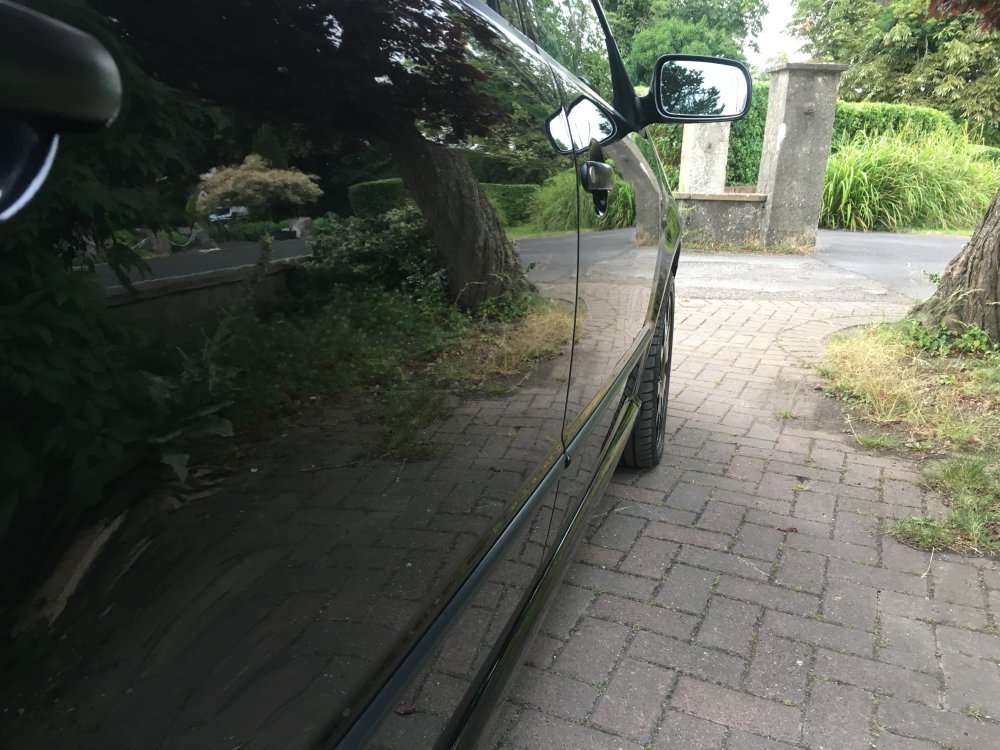

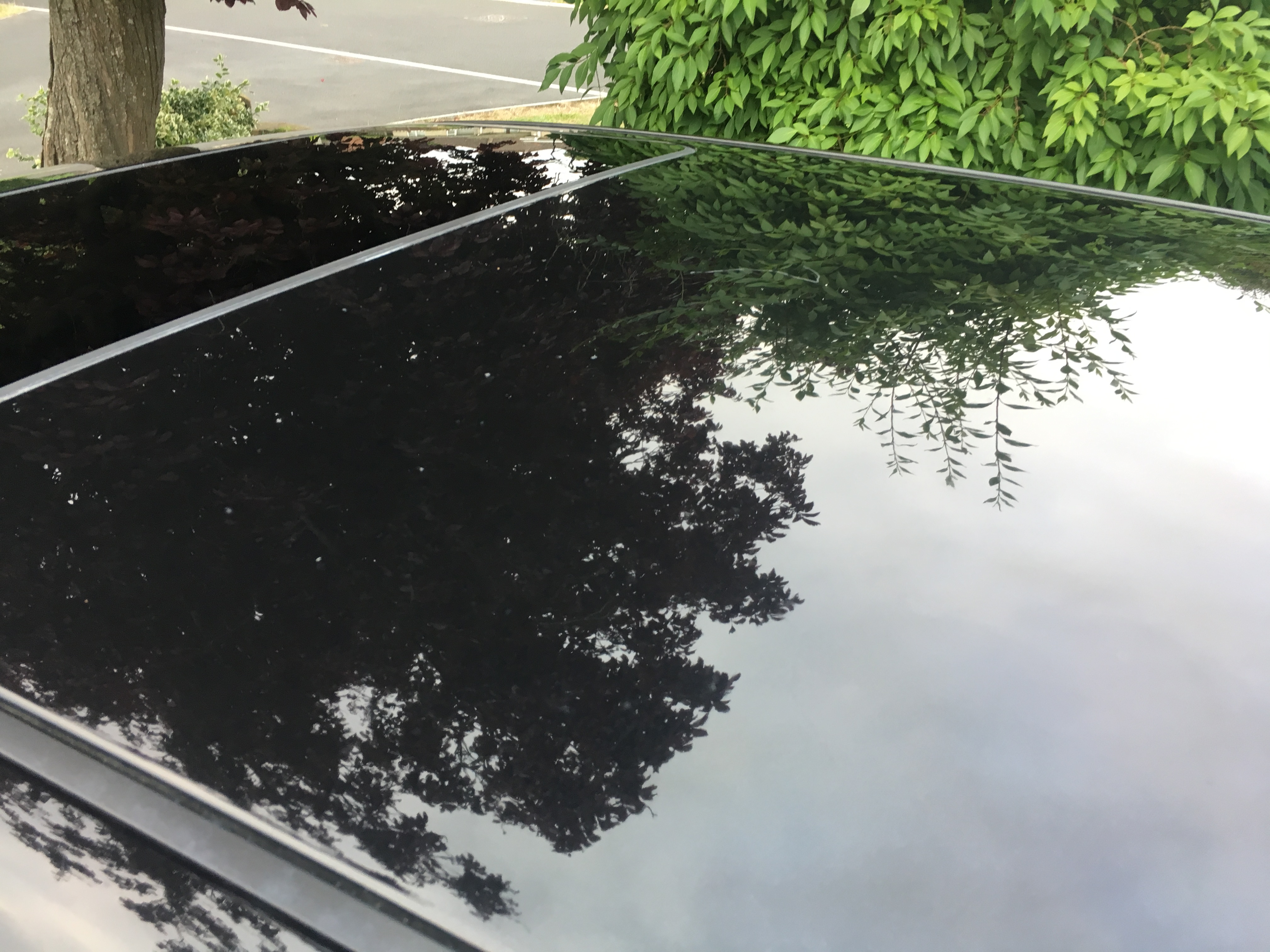

Got any pics mate?
Pics don't do it justice but heres a few
Looks ace that mate! Come do mine :tongueout:
Thanks, yes I would but your a bit far lol.
Took 2 days almost to do it but wanted to make sure it was done properly, my theory being it shouldn't need this treatment again for quite a while if done nicely.

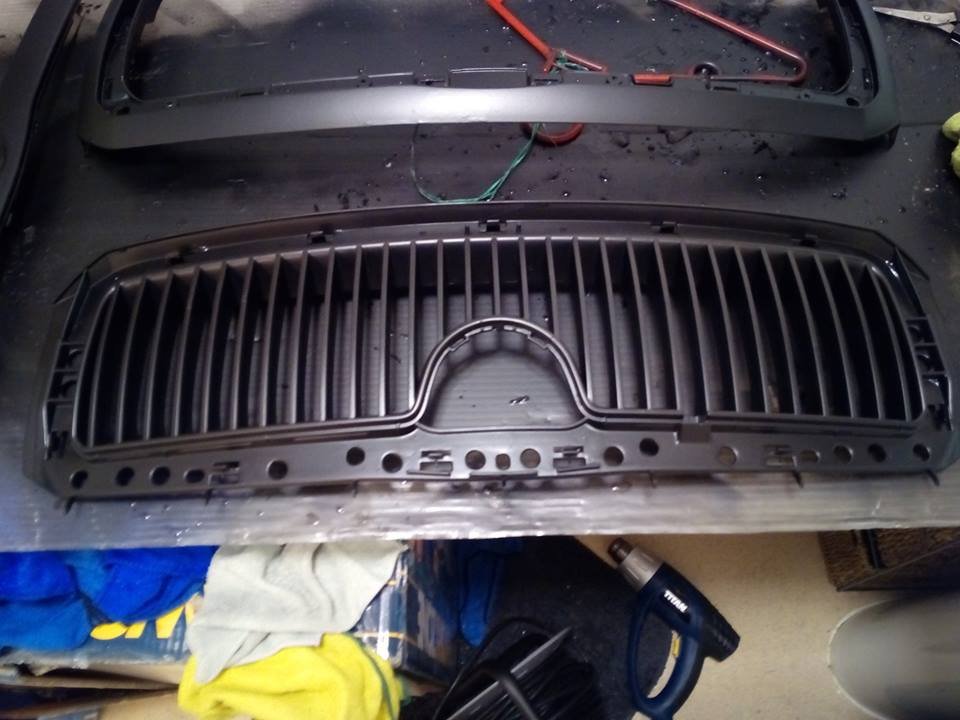

On 15/06/2017 at 15:40, stevobeavo said:
Another vote for plasti dip. Mines been on a year or so and still looks ok. Might re do it again soon though.
Heres mine when it was first done
IMG_20160323_162935739
did mine  couple months ago plasti dip matte black
