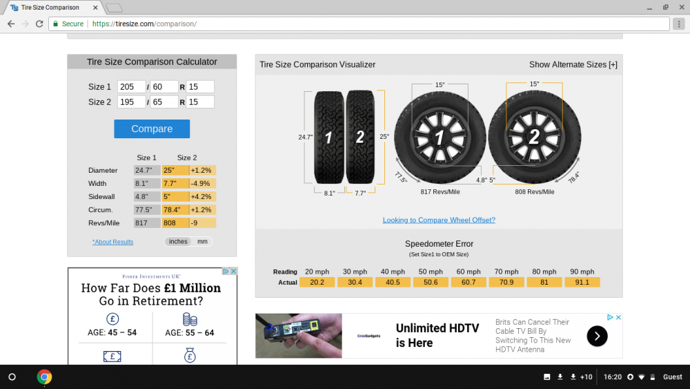

I have been offered winter wheels and tyres to fit my Octavia 4x4 estate at a good price . They are 195/ 65/15 Goodyear tyres on steel wheels .My Estate originally came on 15” Alloys so would these be ok to use. Peter
@welder1
What size tyres were on or are on the original 15" alloys?
20 hours ago, Roottootemoot said:
@welder1
My original wheels had 205/60/ r15 tyres on .
Sounds and looks fine if the tyres are the correct speed and load rating.
Thank you for your help and assistance. Peter
