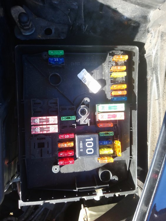

Ah yes. I've fairly happy the ecu is getting power. After playing around with the relays under the dash I've got it started but only intermittently. I need to find out what those relays are and test connection between the ecu and its wires somehow...
Evening gents, went to GermanyDSC_2840.thumb.JPG.e2814e1ebd991345d99a3d15d31e7ba9.JPG on the bike for a bit of a holiday and forgot all about it.
Gave it another go today, again managed to start but only runs for 30 seconds or so then cuts out.
The code is still there.
Attached is my fuse box, nothing of notice wrong ?
Cheers
Alex
