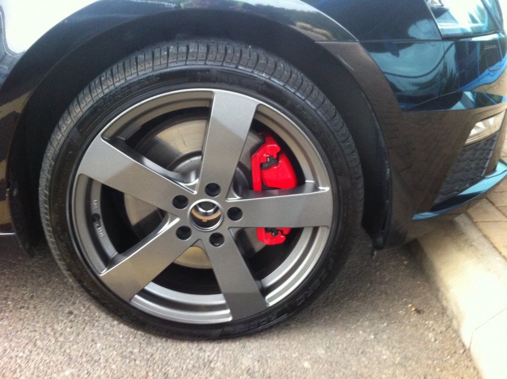

I have a set of these and have used them every winter since 2016 on the original 225/40R18 Pirelli P Zero tyres I bought for less than £300 for a set of 4. Very easy to clean and look very smart in Gunmetal Grey on my Black Vrs.:thumbup:

I have Audi centre caps to cover the beige spigot rings now fitted.:thumbup:
