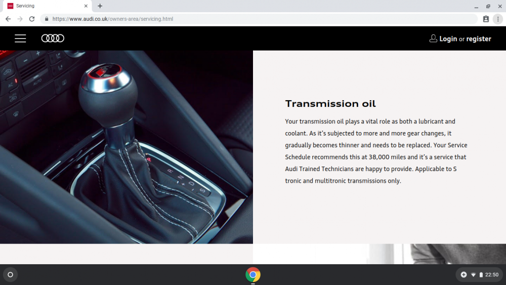

37,000 miles is just ridiculous for changes of oil with these boxes, they are not a DSG.
Location location location and the UK is not Australia so different environmental conditions.
Audi do not help much with the name they use for the boxes.
If you mean the automatic in the 2.0FSI then it's just a torque converter auto.
I'll try and dot-point.
1) 60,000km is what any independant VAG specialist down here in Australia recommends given the history of total failure anytime from 120,000km onwards.  The dealerships continue to state they are a "lifetime fill" and that they are a non-serviceable component.  VW say this because they really don't care if the car lasts much beyond 8 years.
I was looking at buying a Golf Auto for my daughter and my independant VW workshop (he's from London) told me to stay away.
2) It's a slushbox auto.  It generates heat and has clutches that wear.  It doesn't matter what brand it is.  (source: me - qualified motor mechanic that worked in an automatic transmission workshop in the 80s.  Now a Mech Eng).
3) Why is it ridiculous?  See #2.   My attitude is that I'd rather over-service something at a cost of $200-$400 and not have a failure than leave it alone and have a $4000-$6000 failure that could make the car an economic write-off (cost of repairs out of proportion to value of car).
4) Sure.  It gets hot (and humid) here (we had a 25.5 celcius day on 25 Aug this winter) and 40c+ days are becoming annoyingly common.  But our traffic isn't quite as bad as London and traffic generates heat.
5) Audi transmission (and engine) designations are always confusing and without any logic... and the transmission are high maintenance.
You are entitled to your opinion and to act accordingly.  It doesn't affect me.  I'm just putting it out there that they aren't as "sealed for life" as what VAG say and that servicing is needed.
