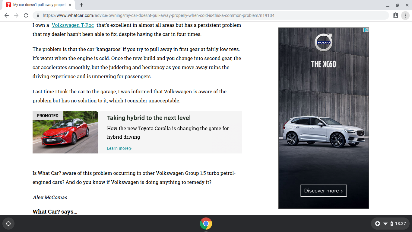

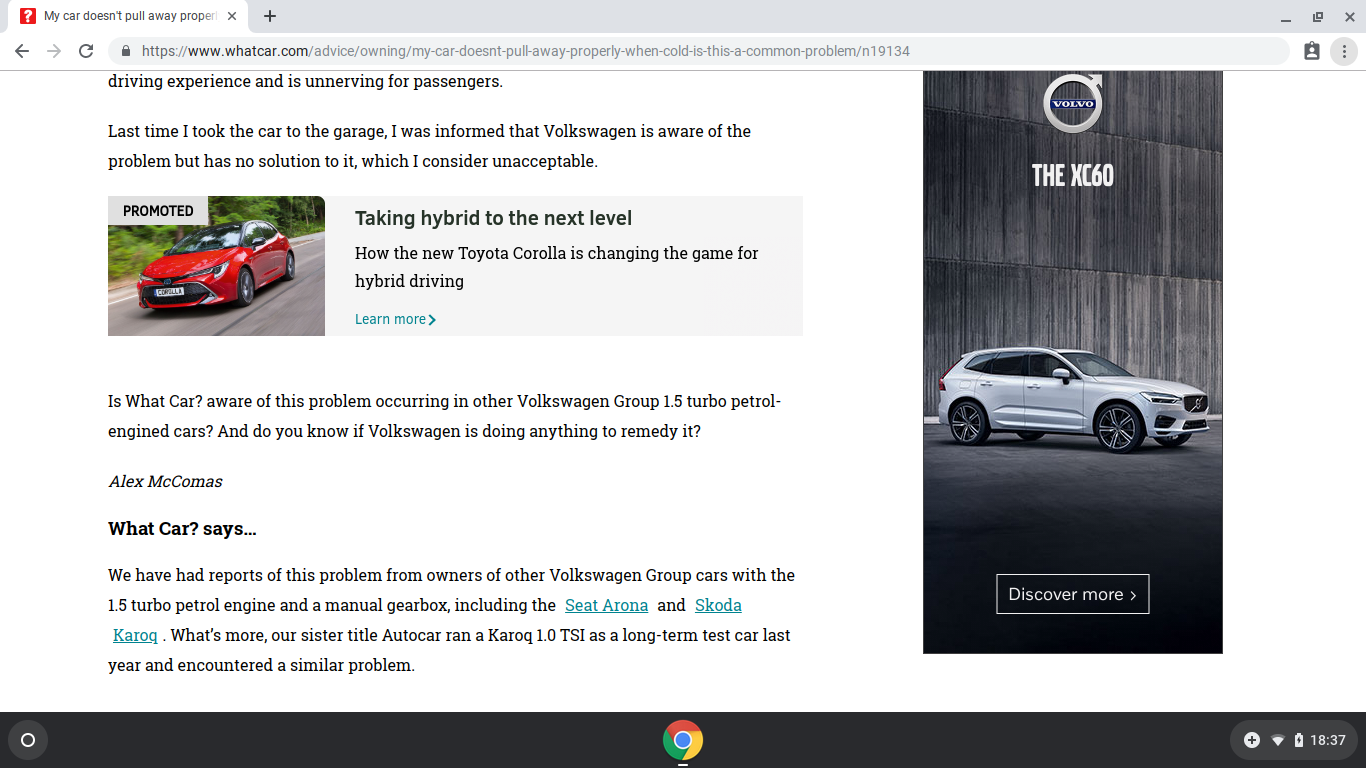

I was only aware of problems relating to the 1.5 engine but when looking at the What Car website the other day they mentioned that a sister magazine had a Karoq 1.0 on test and that was exhibiting the kangarooing problems. This was in reply to someone who had ordered a new SEAT with the 1.5 engine.
Thanks for the info VAGCF, I'll take a look🙂.
What Car's sister magazine is Autocar and how unusual for Journalists that are contributing to Haymarket Media Group publications to find fault with VW Group models.
