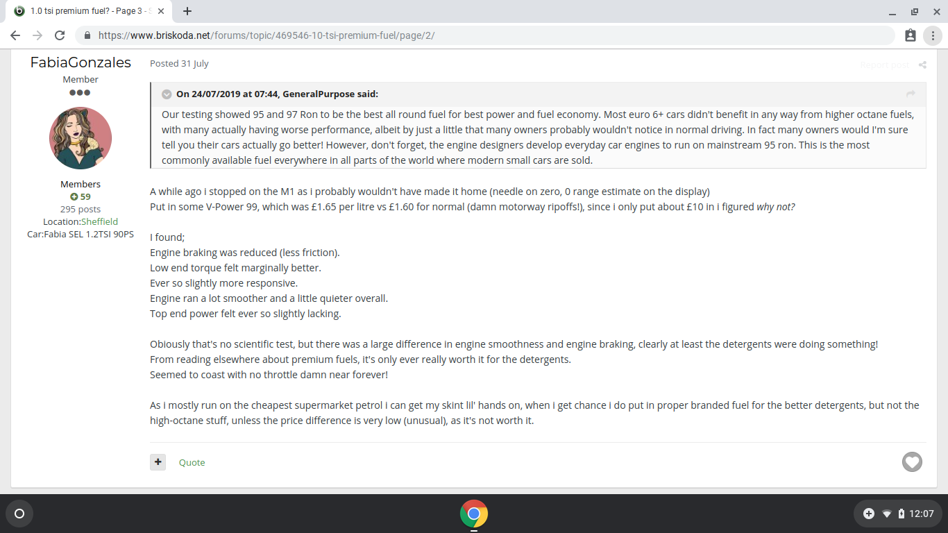

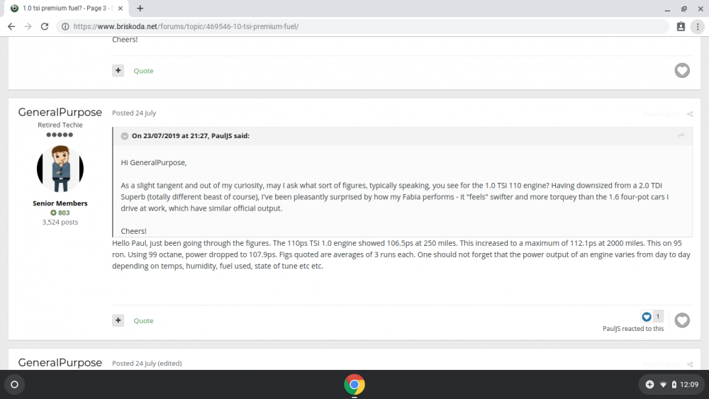

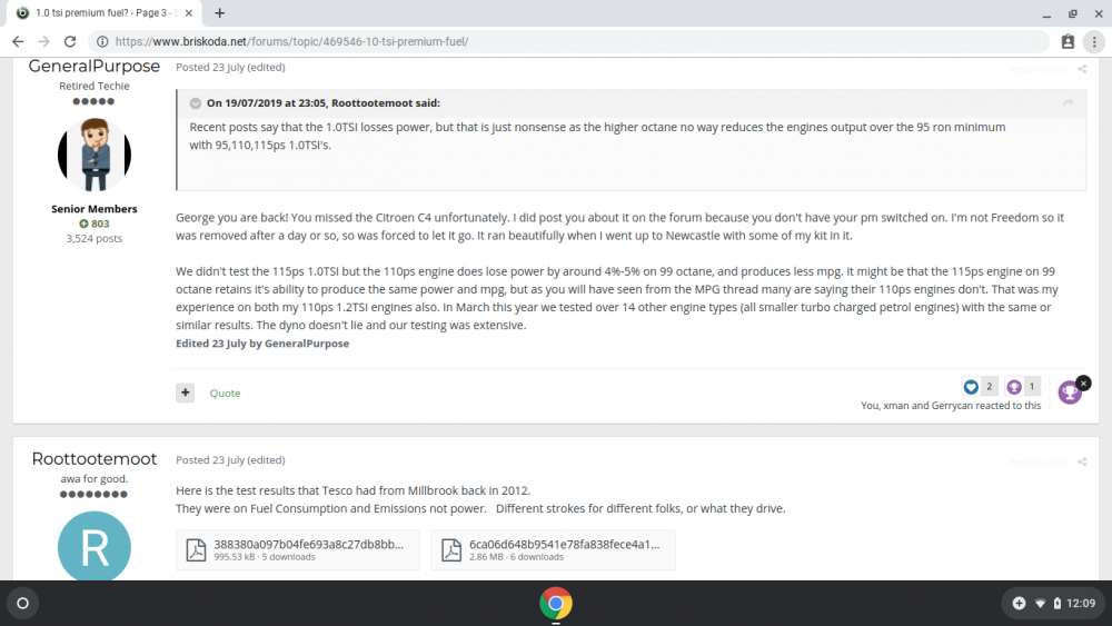

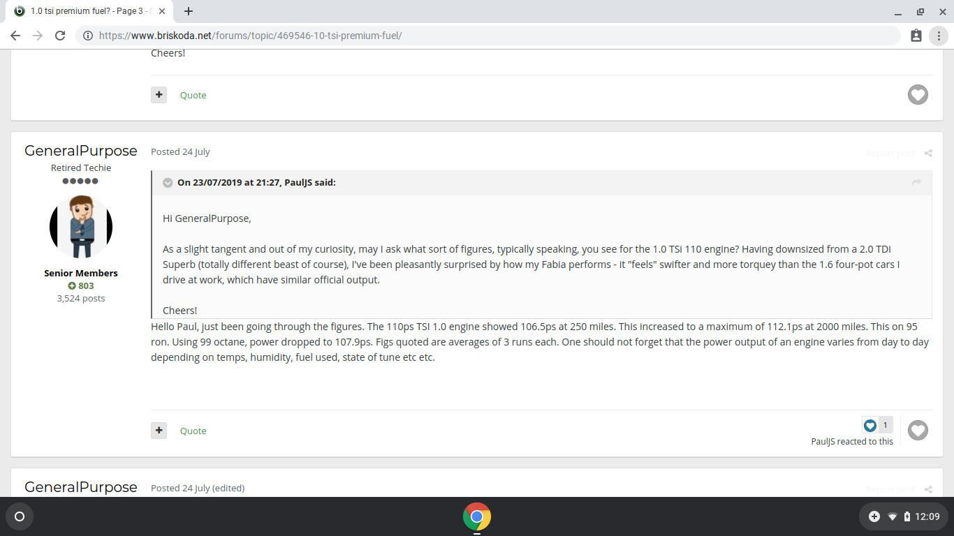

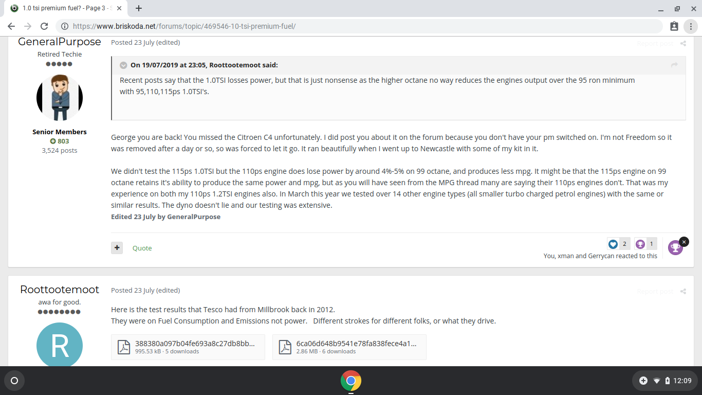

An Ex Tech has posted in the Mk3 Fabia section about being in on tests with fuel and 1.0TSI producing less power on Super Unleaded than on 95 ron.
I have driven 1.0TSI DSG's with 115 ps and for me it would always be 99 ron i use.
It is only 5 pence a litre more than supermarket 95 ron, and cheaper than BP / Shell / Esso / Gulf etc 95 ron,
and lots less than crazy priced 97 ron the BP have in the UK.
Also less than Shell V-Power Nitro + which i never use, not to save money just Bore Wash maybe with crappy long life oils and 'Secret Detergents'.
Same secret ones as the Tesco Momentum 99, Esso Super. BP etc.
Since the debate will go on for ever it is great that all a driver needs to do is see what they think when they use different octanes.
They have it day by day, week by week, and on and on.
If a 110ps or a 95ps 1.0TSI produces less max power or Nm torque on higher octanes and that is a proven fact then that is a strange one,
but then VW Group Engine Management / Software from Bosch can be strange to get WLTP / RDE & RDE2 results....
