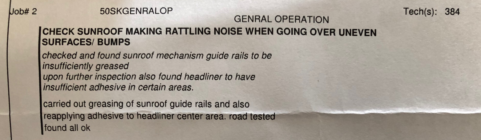

Thanks Auric and apologies for the delayed reply. Finally got around to getting this looked at by Skoda and they have fixed it under warranty. Two issues:
  • Insufficient grease on the sunroof guide rails
  • Insufficient adhesive on roof liner
Car is silent now. Bliss. Happy new year.

Glad to be of help, pleased it's all sorted
