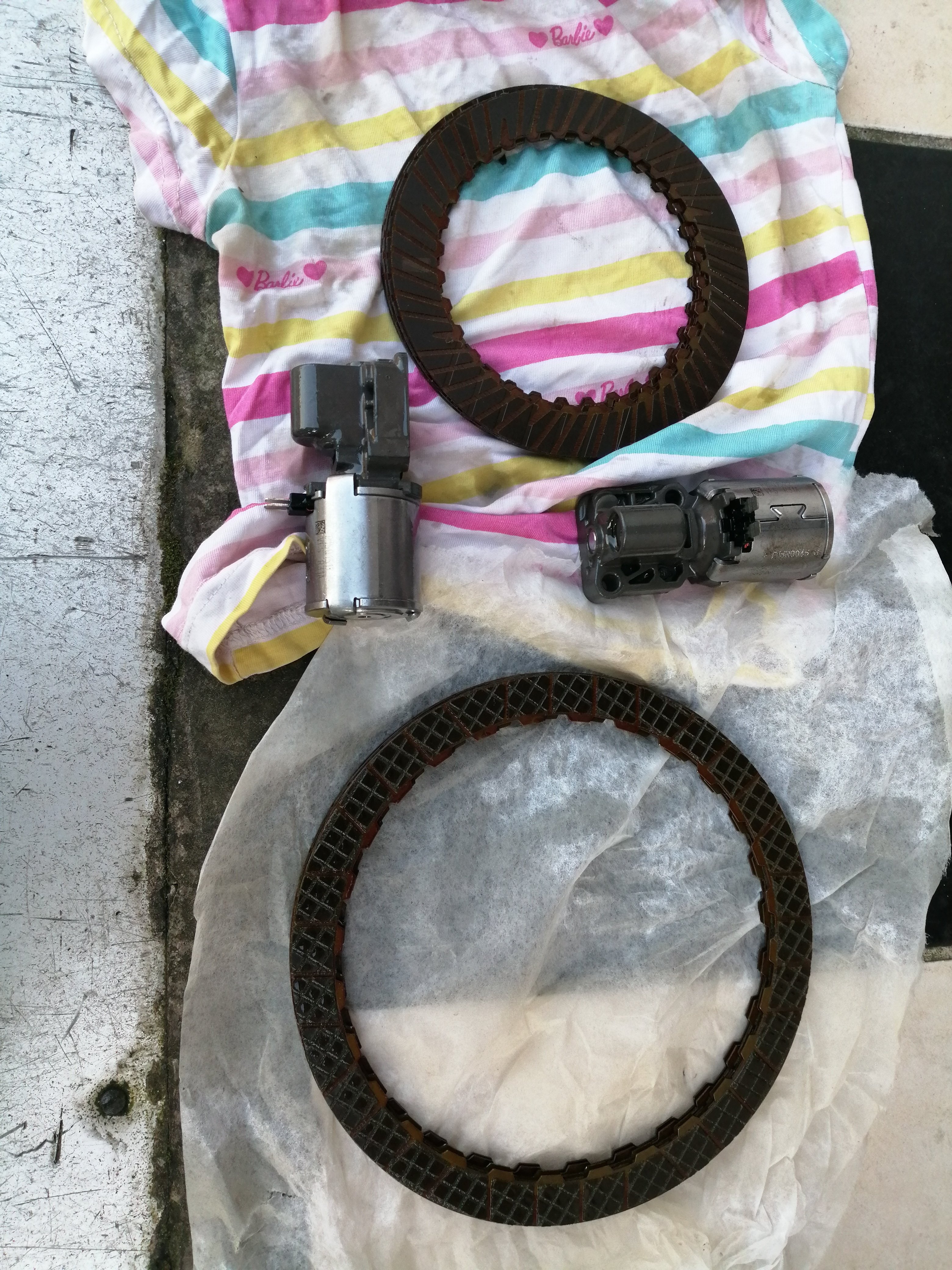

Thanks guys. I just brought my car back and paid £800. Tha only thing is they said they changed the friction plates and two valves. Picture included they said they paid £400 for the parts isnt it a bit too much also notice the old once nothing wrong with them!!

The problem has now gone away, but these few bits £800 is a bit too much. Isnt it?! I know it's too late, but I can still go back to them if I get a clue how much there cost in reality

What are these parts called?
There are two solenoids, looking on eBay they are anywhere between £90 and £140 delivered. The other parts look like friction rings for the clutch, on eBay there is a set for £185.
£400 for parts doesn't seem massively expensive based on that...
