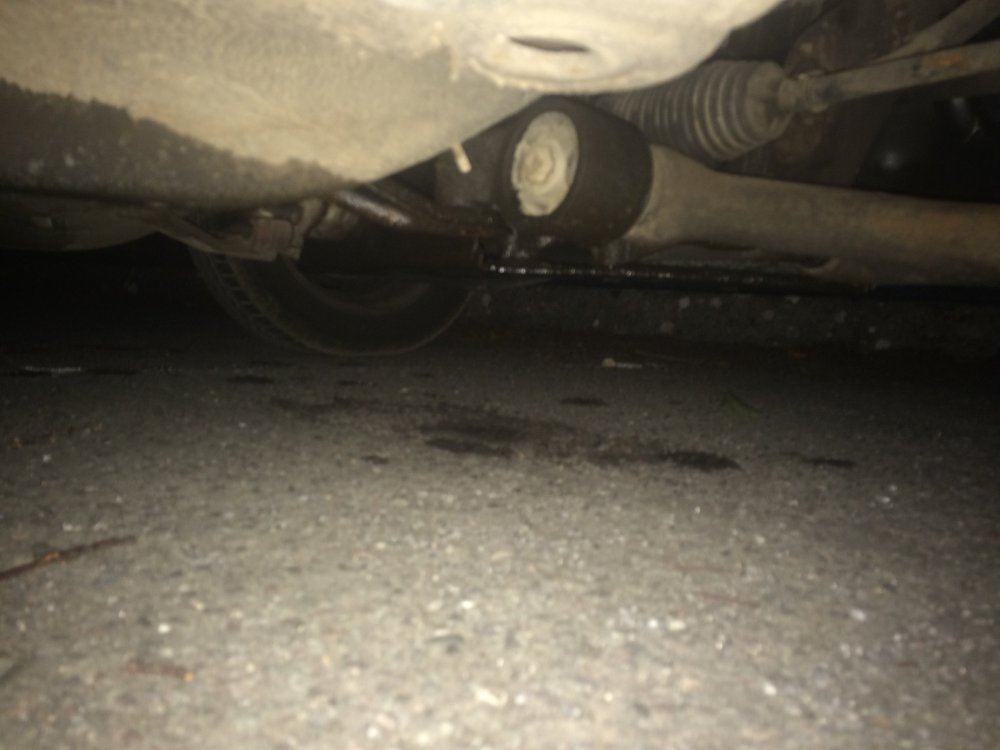

just had a look at the pattern of drops on the floor from last night, about a shoe length (size 7) in height and width where all the blobs are.
when I was looking at my arb bushes at the weekend it did look rather oily in at the back/bottom of the engine

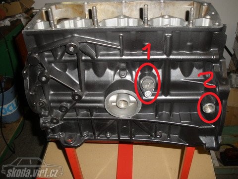

I would check the oil pressure switch on the front of the engine. They can leak and the oil can get blown backwards.
Position number 2...
Edited by TMB
I’ve had a look at the oil pressure switch, not sure if it’s loose or not, doesn’t really appear too loose, and there doesn’t seem to be much oil/residue around it.

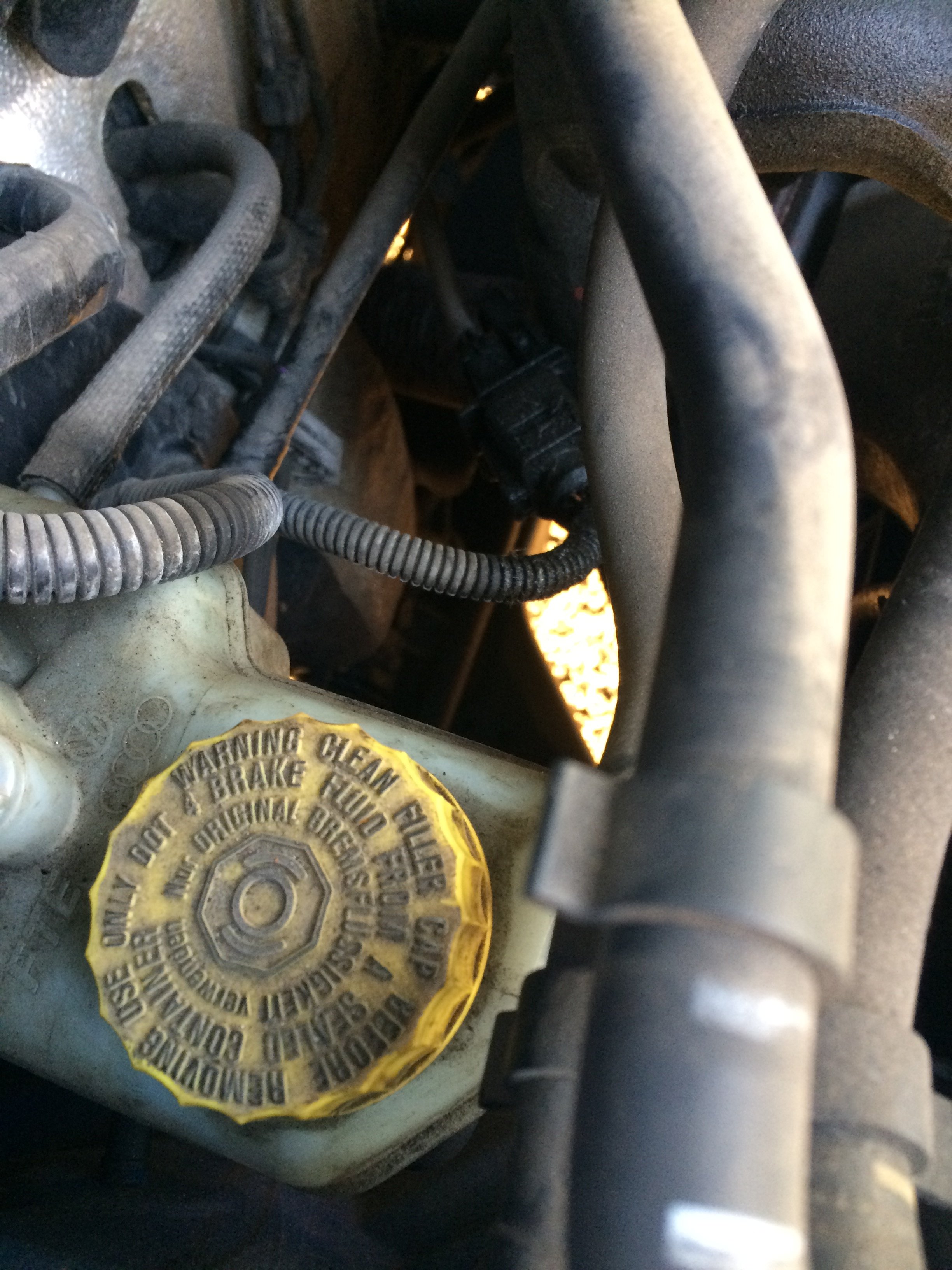

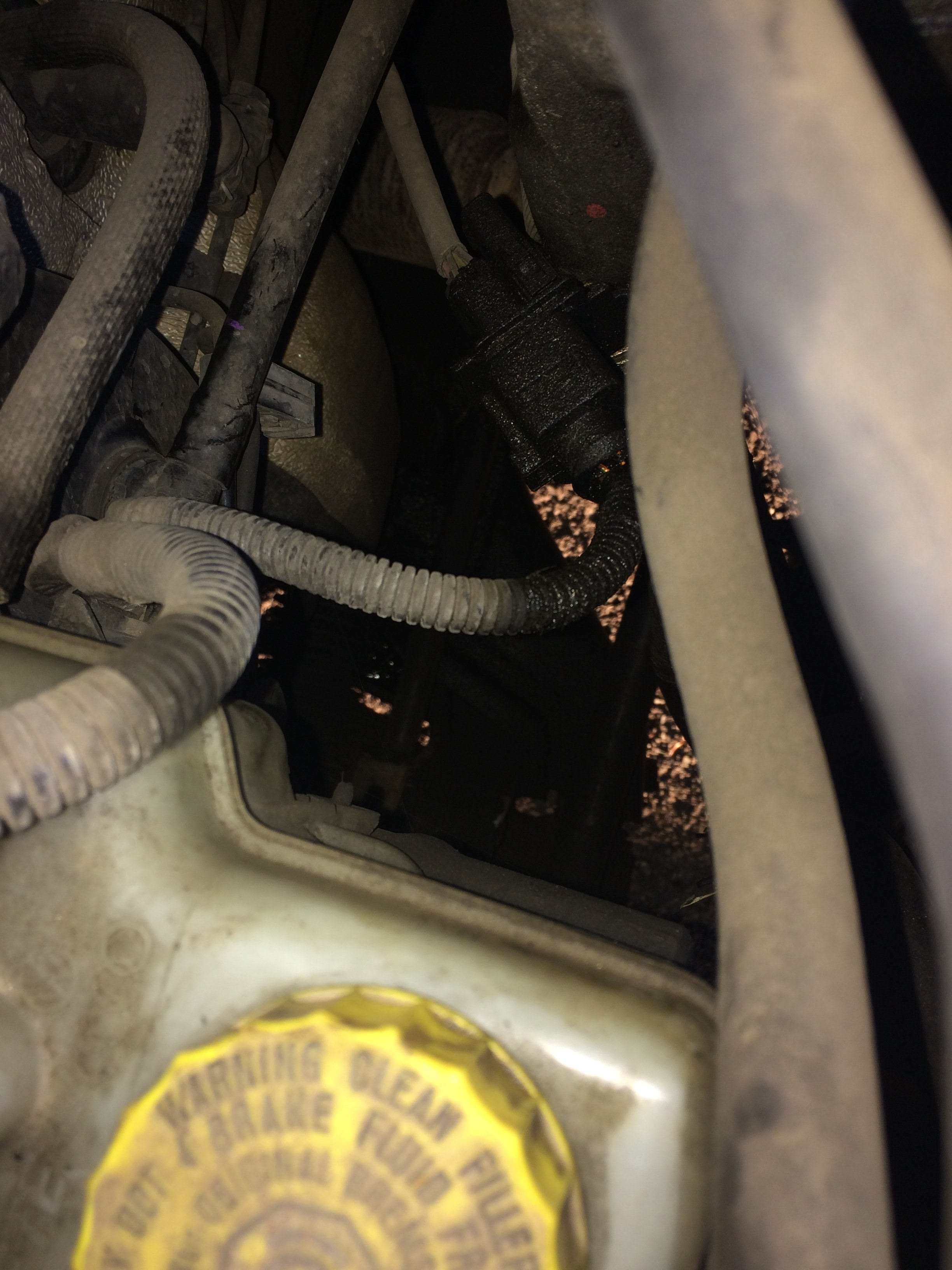

The worst/oily part of the engine I could see from the top is in the photo
Wherever it's coming from, it looks as though it's been leaking for a good while to me. The pic you posted the other day of your console bush showed oil all over the console bracket and it looked like it had been there a while. Best get it looked at as it's very hard to tell where it's coming from without seeing the car.

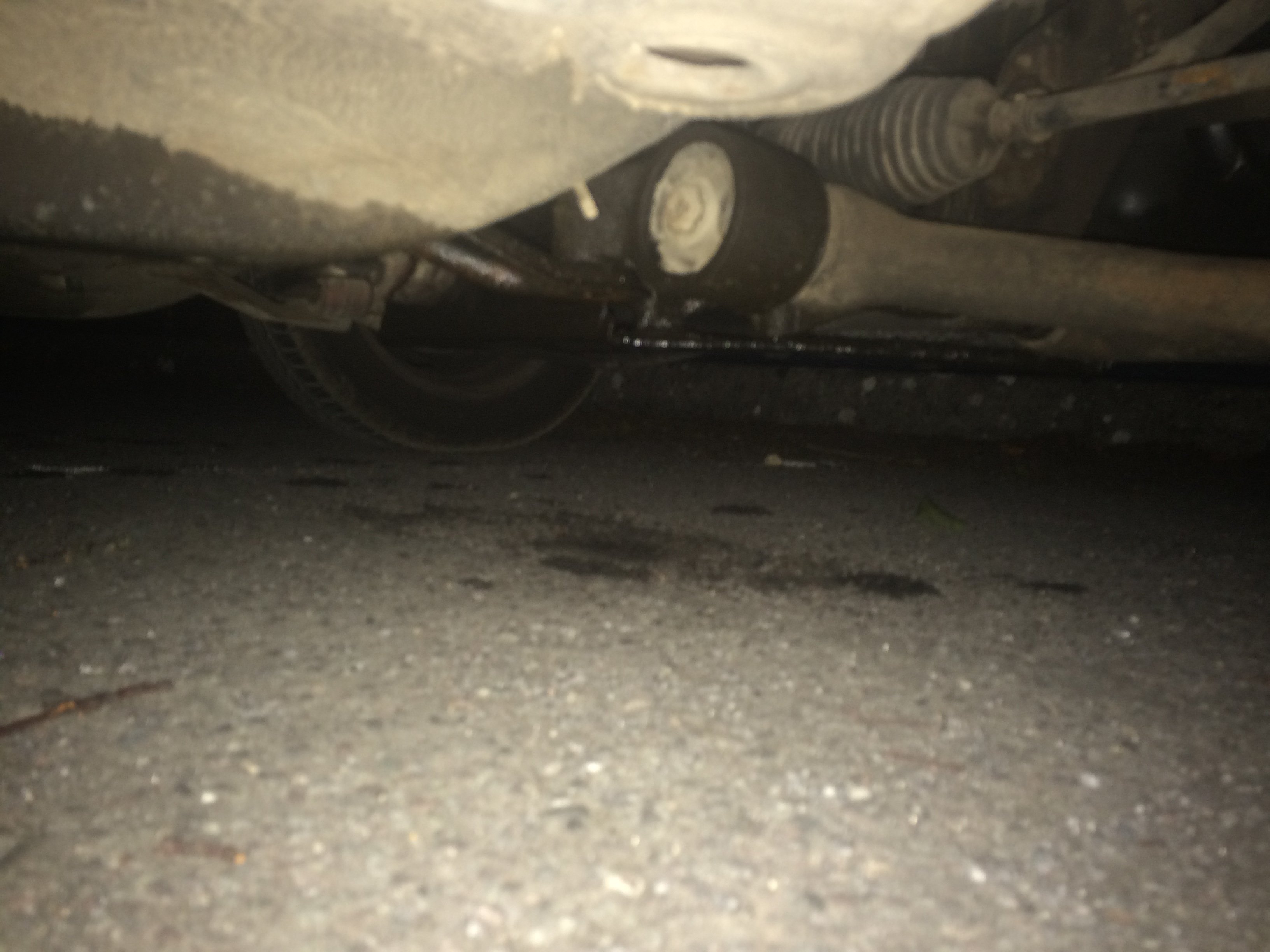

Rather rubbish photo from the dark this morning, although explains why it’s dripping over a wide area
Blimey, it looks like it's been doing it awhile judging by how oiled up everything is under there, have you checked PAS fluid level? What about the gearbox, a level check is impossible, you have to top it up until it's full.
