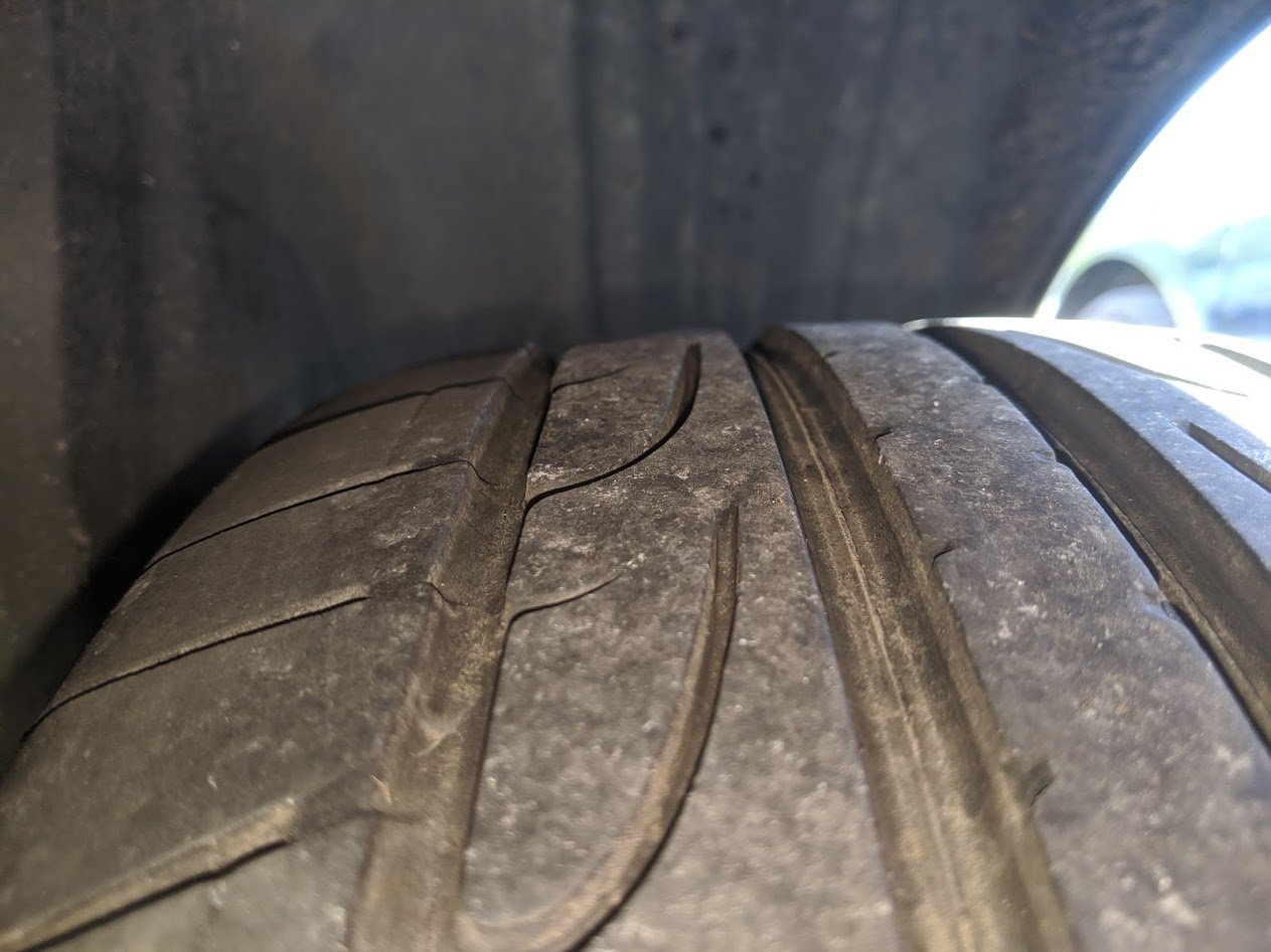

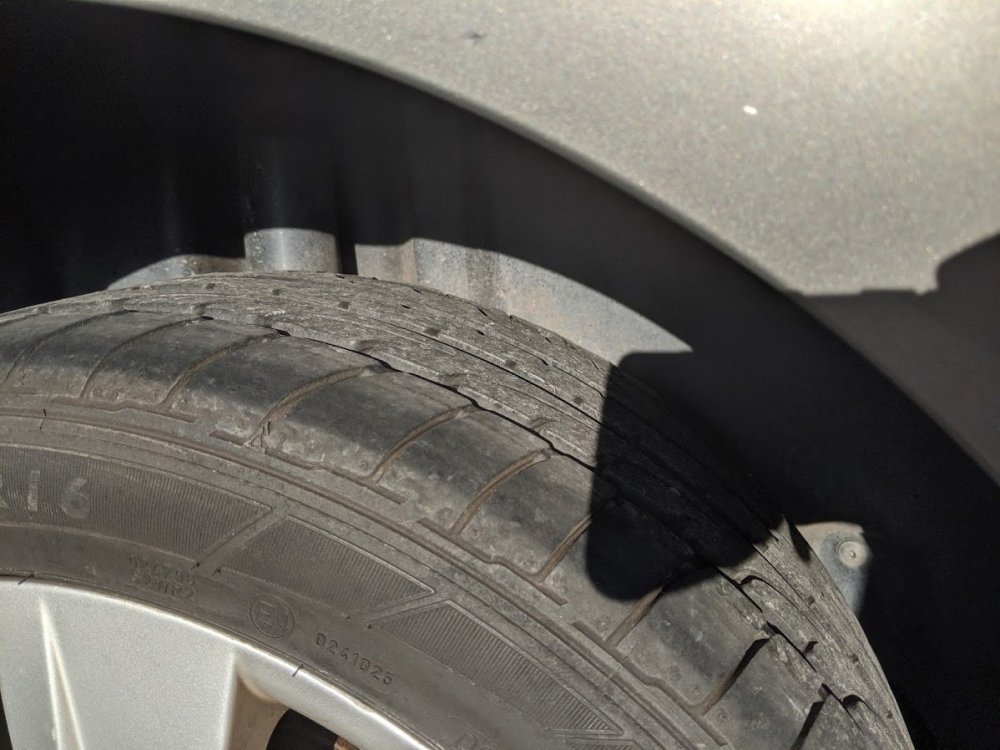

Crap photos that show nothing but yeah

The 205/40 R 17 Dunlop Sport Maxx on the rear of Fabia Mk2 vRS would often mis-shape like that, and were no use for swapping from rear to front.
Oddly on the rear of the Mk2 Monte Carlos i never spotted them looking so out of shape.
@Confused_Cheese You got a pass certificate. If it was serious, it would have failed.
A small amount sawtoothing on unpowered wheels is inevitable due to braking but what you have shown is barely noticeable. (Ever dragged an eraser over a page repeatedly in one direction.? Same principle of a tyre under braking...)
