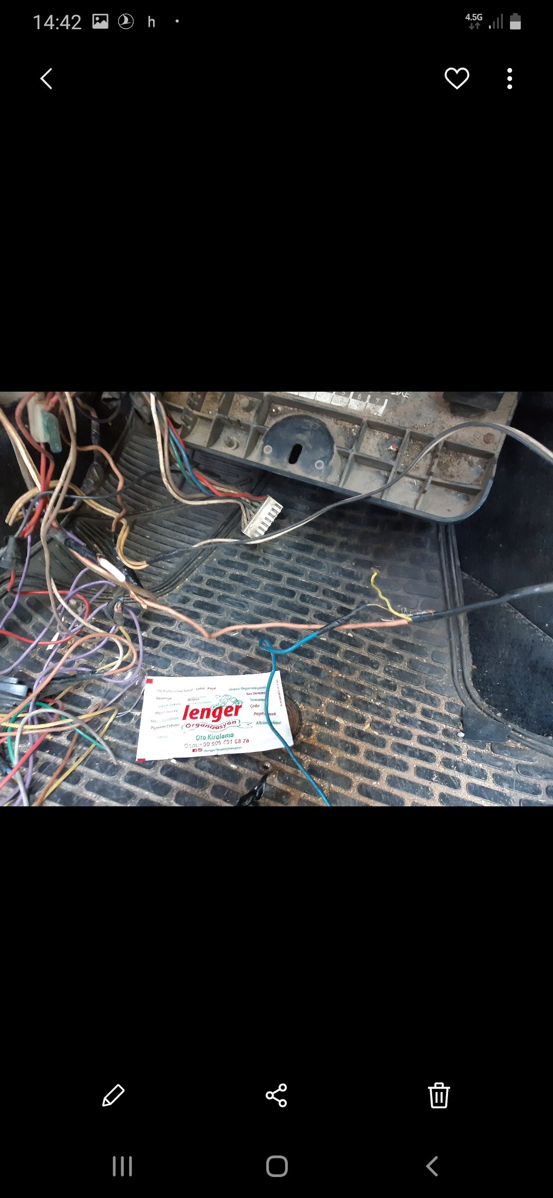

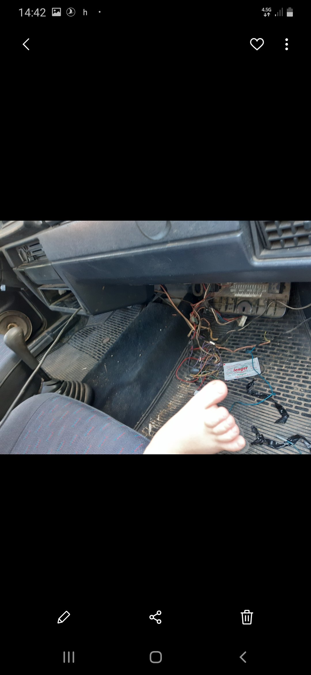

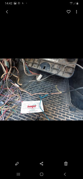

anyway the previous owner made a really baş job with the electric work.

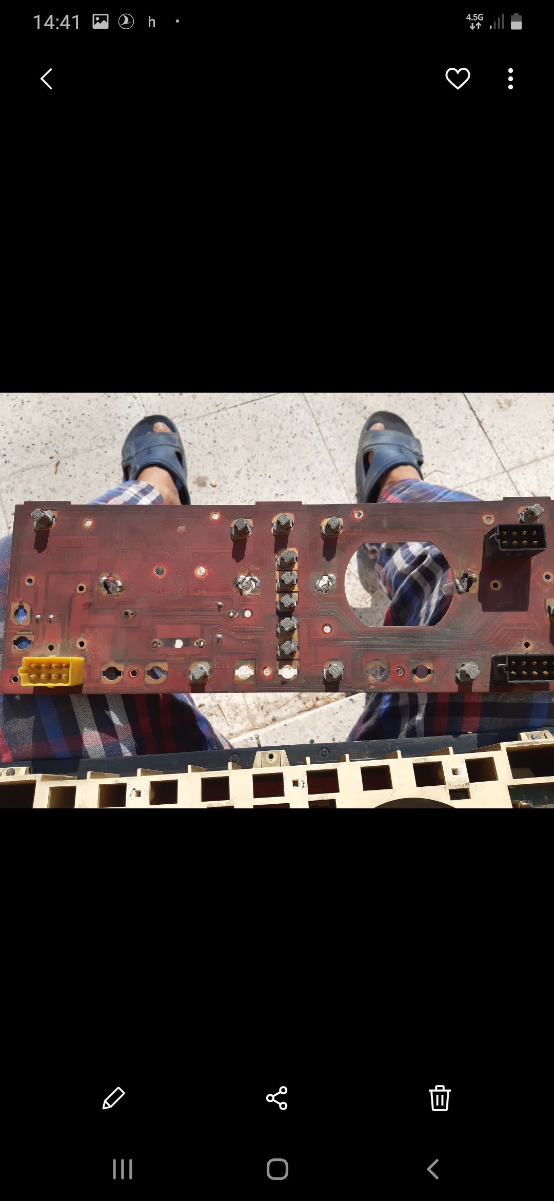

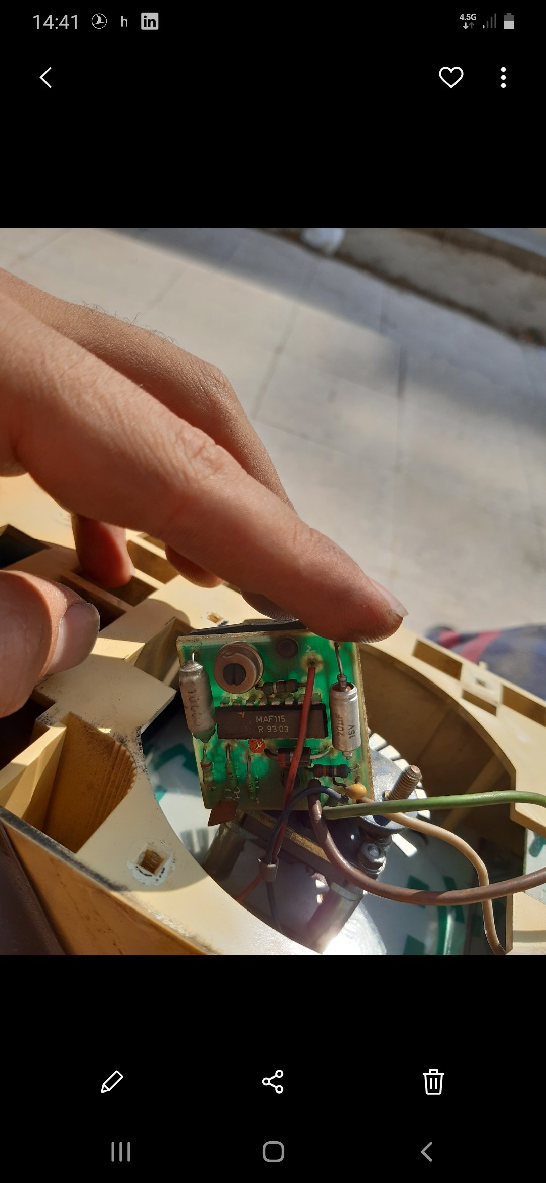

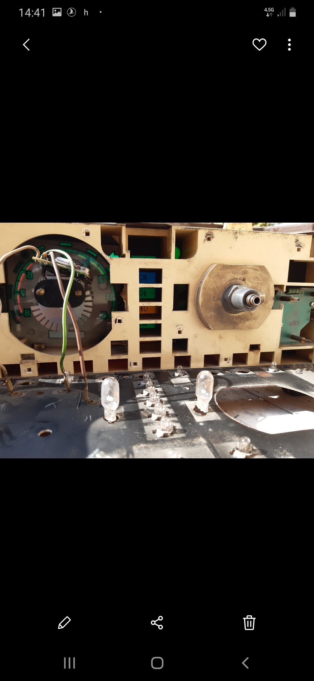

anyway the first time ı had the car the tachometer worked greatly, untill one day it just stopped working. I changed all the fuse but still not working. Anyway some time later my battery died,  forgot to close the headlights,  and simeone helpped me with a booster ( the thing you attach to the battery to give power) and everything was ok again! Sometime later ı had to go somewhere by night (800km), at half of the way it came back, but the next morning went out again. Since then never worked again.
for info : the gauge move a little when ı give full power.
the dashboard lights sometime goes, thdn come back after the car hit a bumper or rock on the road.

I know it look bad, unfortunately... what i planning to do is to recheck all the wiring,  but i couldnt find the wiring scheme of the favorit on the net. If someone could provide it i would be very gratefull.

Yesterday when going to work ı stopped somewhere  to get a breakfast (3 minute stop), when ı got back to my car and started the engine the tachometer  just worked,  out of nowhere and whitout a problem. Anyway ı was happy about it untill ı went back home in the afternoon, when ı started the car to go home the tachometer didnt worked.
I suspect a faulty cable or some kind of connection problem.

You can say that again. The tachometer is just the tip of the iceberg.

In these cases and with cars as simple as the favorit I don't bother spending more than a couple of days troubleshooting someone else's stupid mistakes. I would just straight rewire everything I suspect can be wrong.
Yes this is also what ı am planning to do.  To be honest it will not take me long but ı really dont have the time (between family and job ı only have the weekend and even then it is hard  :S)
