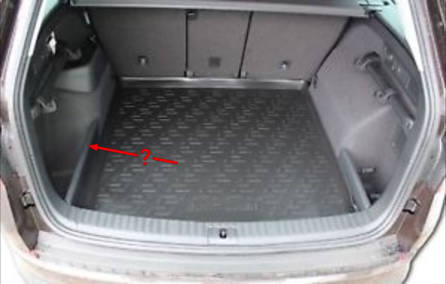

Also looking for how big is the boot without sparewheel and styrofoam. If someone have the mesurement? 5 seater.

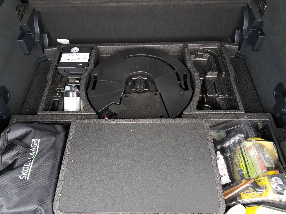

It looks to be identical to the size of the inside of the spare wheel? If you've already got a spare wheel you can measure it?
Thanks for good pictures.
I will get my car in a few weeks, but started to build my box.
Looks like a 17" wheel?
Not that thick, airwents on top. Hmm.
I belive a frame will do untill and some experimentell with compartment size around it. i do belive it will be resonans.
18" i mean..
Off topic, no Edit Button for my posts? 🤔
I have a woofer but no spare wheel, so there must be an original foam part for subwoofer on the market. Maybe helps to build.
Oh, never seen that. Can you take a picture?
Unfortunately I don`t have time to look for a part number hurrying to the plane.
Nice, thanks!
Looks handy. What is under the big foam piece? Or is it just alot of foam? 🤔

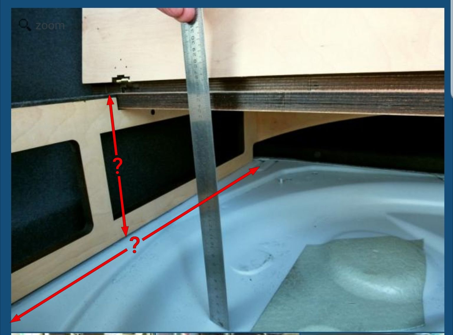

I need help with some mesurement if someone have time and will. 🙏
I want the numbers for how deep it is from the plastic side down to bottom.
And deph from loading threshold to end of seats. The back is concave, so need to be mesure on left or right side.
Or i just wait 3 weeks more to get my car. But would be much appreciated. 🙂🙏
