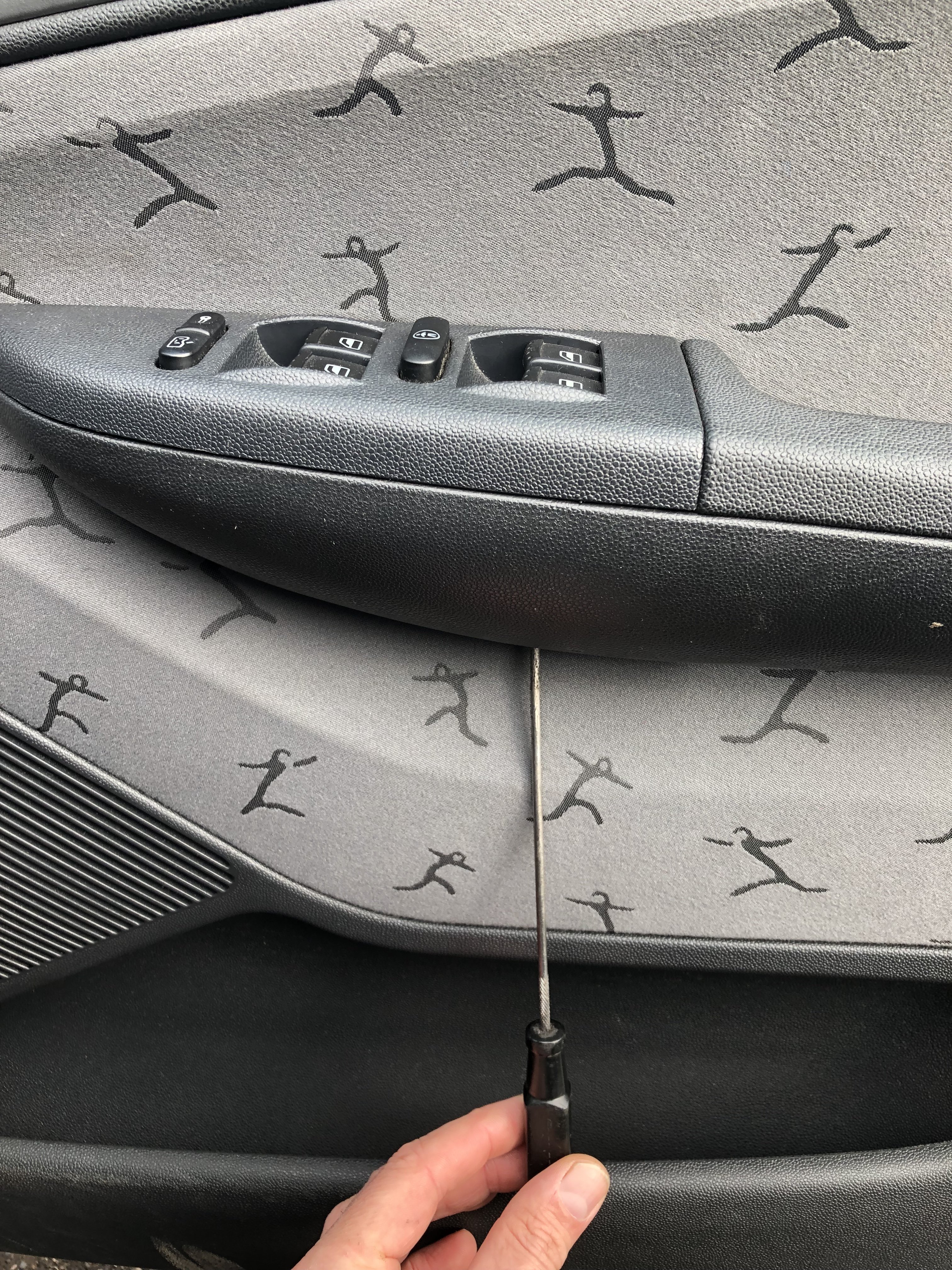

Insert a thin screwdriver into the access hole under the handle and release the locking tab.

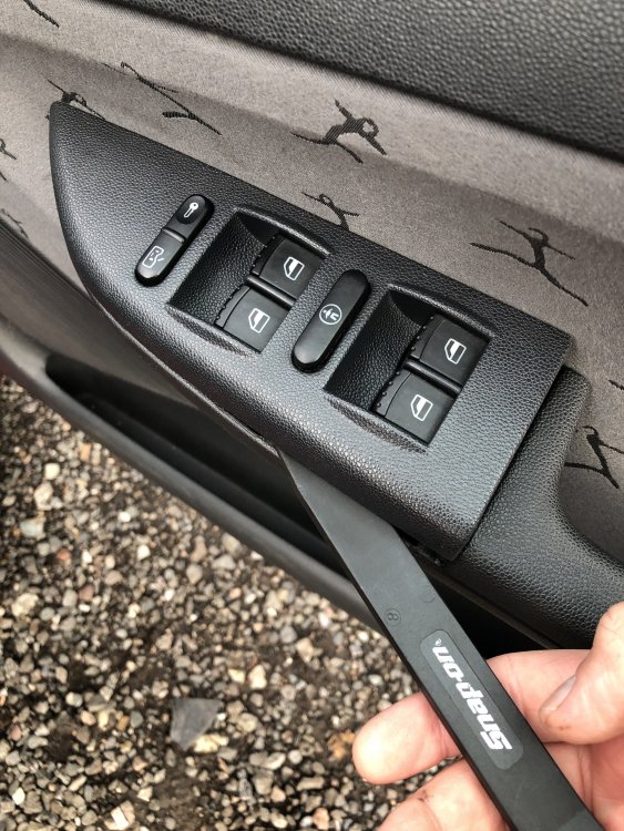

Separate the switch mounting trim using a plastic trim tool

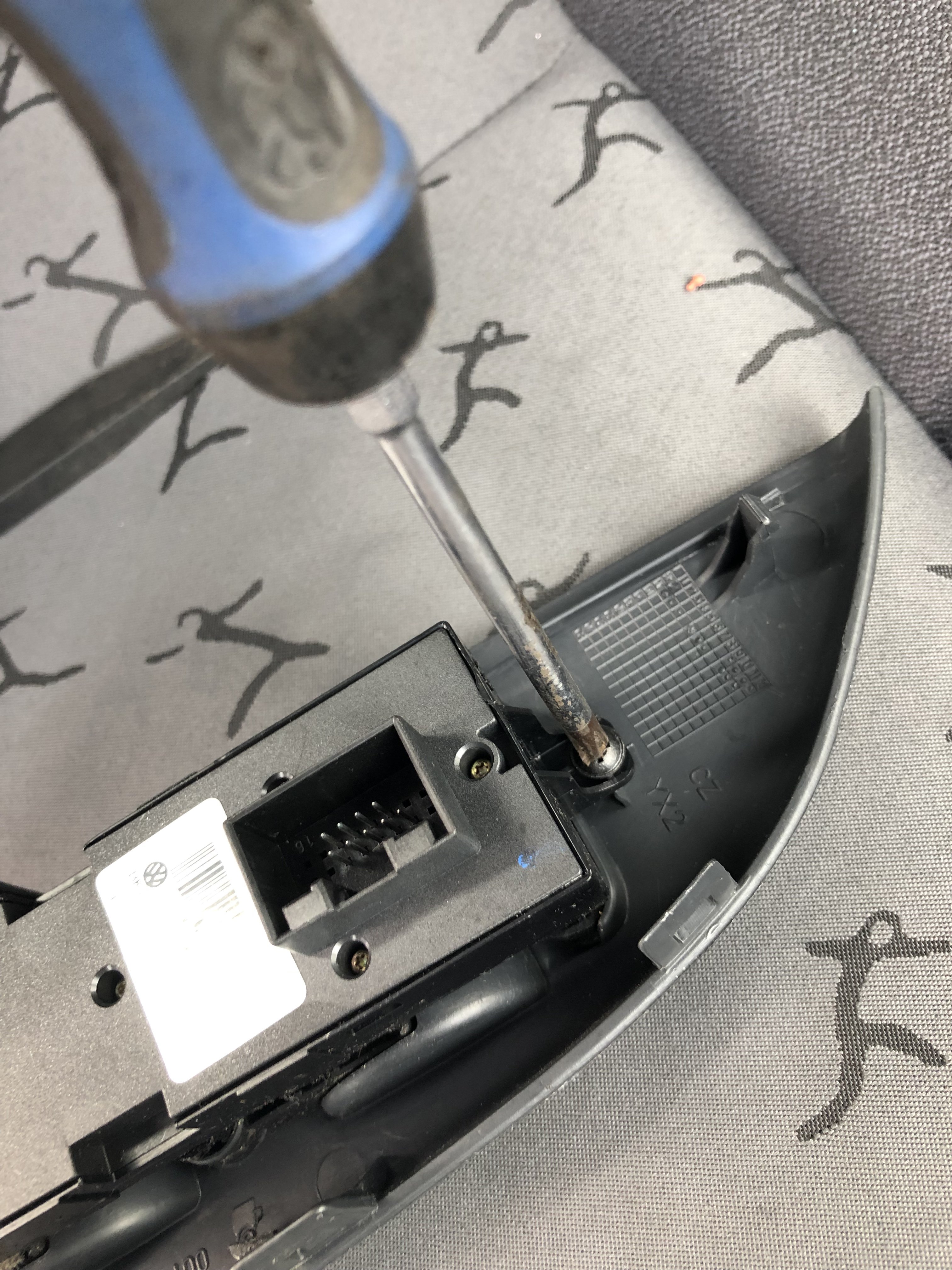

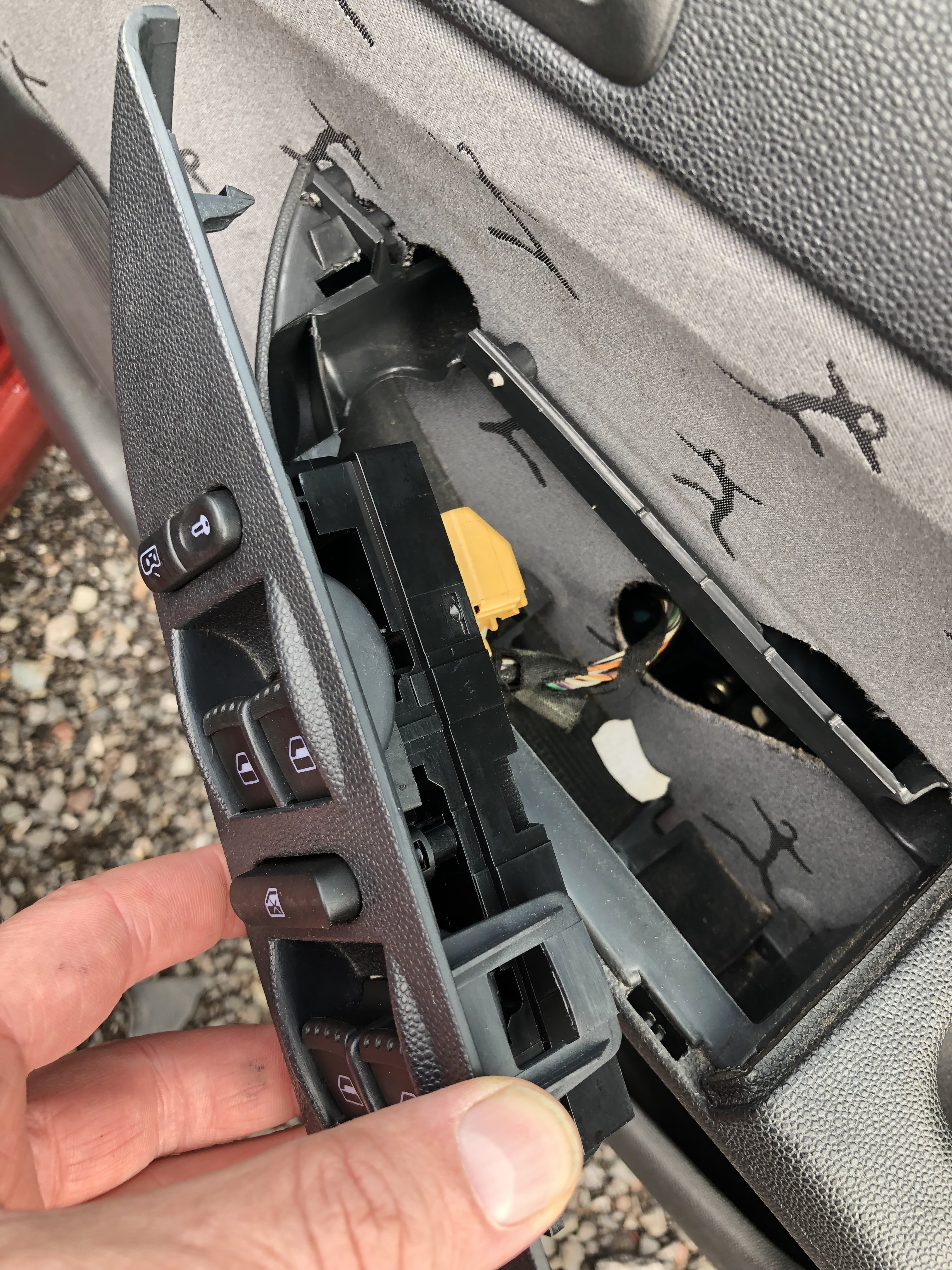

Disconnect the switchpack and then remove the retaining screws.

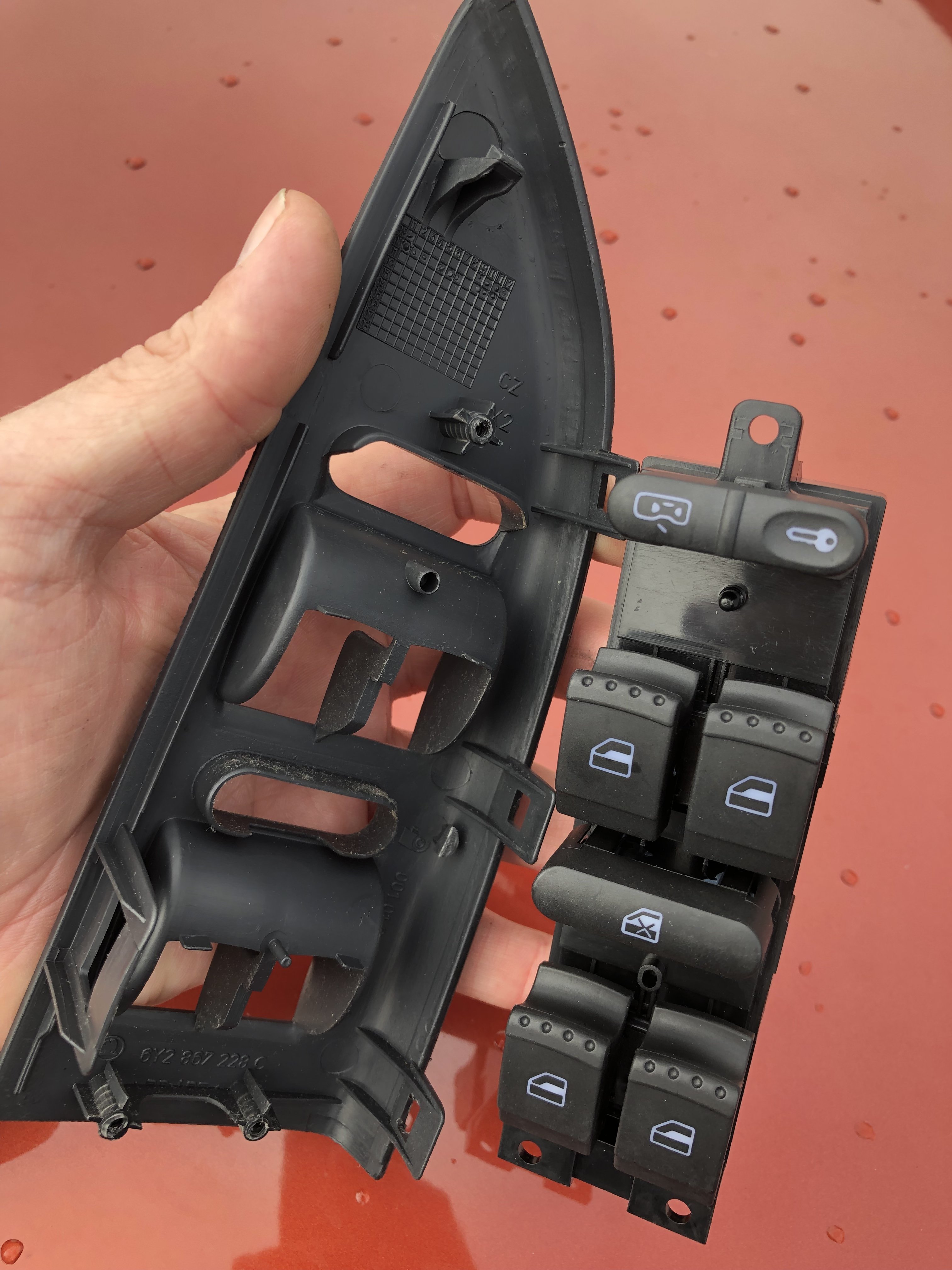

Remove the old switchpack, install the new one into the trim and refit the screws.

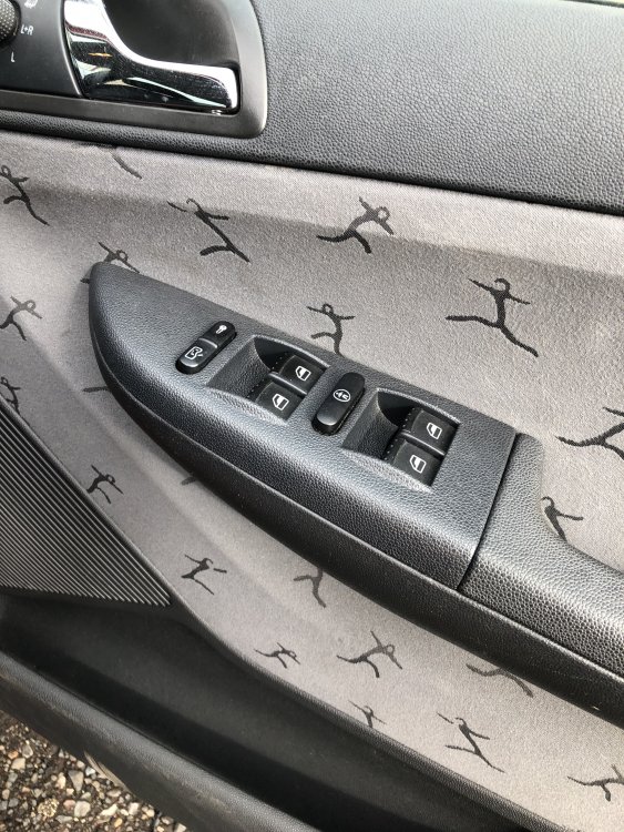

Connect the switchpack and install the trim by pushing down into the handle.

It's that first locking tab near the door card that's caught me out in the past. One of those things where until you see what it's like disassembled, you can't work out how the locking bit goes. This guide should help people avoid that struggle. :thumbup:
