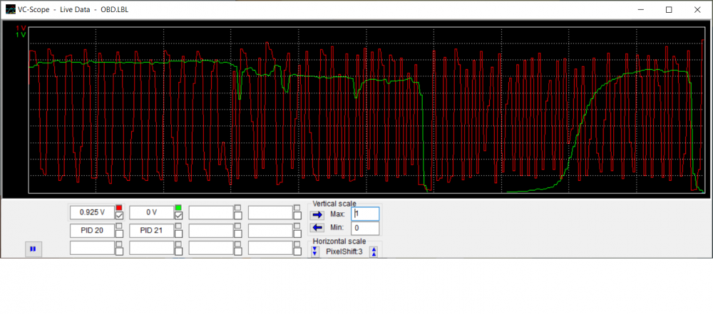

I looked at the graphs and the bank 1 sensor 2 wasn't mimicking the bank 1 sensor 1. However the bank 1 sensor 2 was pretty stable at high values, then it dipped for a period, then back up.
My initial thoughts were that the Bank 1 Sensor 2 might be faulty itself.
What do you guys think?
Attached you have a picture of the graph (obviously, red is B1 sensor 1 and green is B1 sensor 2).

What time period does that plot cover, and was it from a cold start?
What engine type is this?
I think it’s 20-30 seconds. I start revving at about a third. I can re-do the test for a longer period if that’s helpful.
It’s 1.4 Petrol (BXW)
Yes, it’s from a cold start.

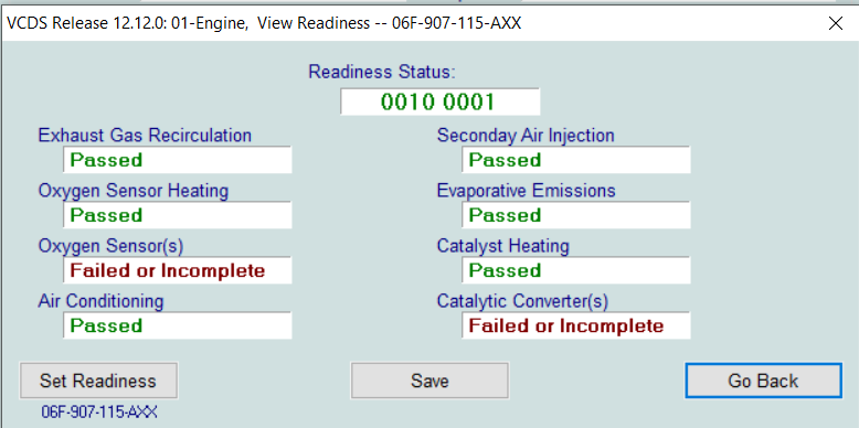

vagcom shows me I’m in an emissions fail mode even after resetting all the codes.

The rear sensor will take quite a bit longer than the front to warm up into a state where it operates correctly, so the constant high part of the curve at the start is probably normal.
See if the slow up/down cycle of sensor 2 continues over longer timescales.
Have you tried to generate a readiness code and age the probes?

ok, will try at a normal operating temp.
Didn’t know about that. I’m just a little amateur :D.
I have googled it and found about it. Will get one and post here as soon as I get home.

Readiness test and Youtube link with 4-5 minutes of monitoring the O2 sensor graph.
Whenever you hear the revving that is up to 3-4k. Engine is at 90 C.
