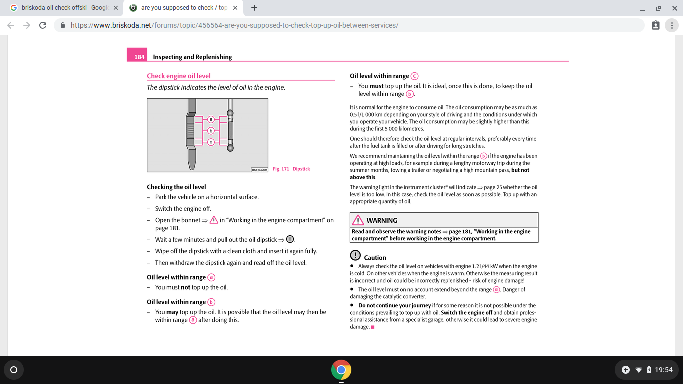

Follow the procedure in your owners manual for topping up oil, and checking oil level.
It gets checked at Operating Temp, but you can still check when cold to see at least to the top area of the crosshatch on the dip stick.
Look in the owners manual see where they show area 'A'.

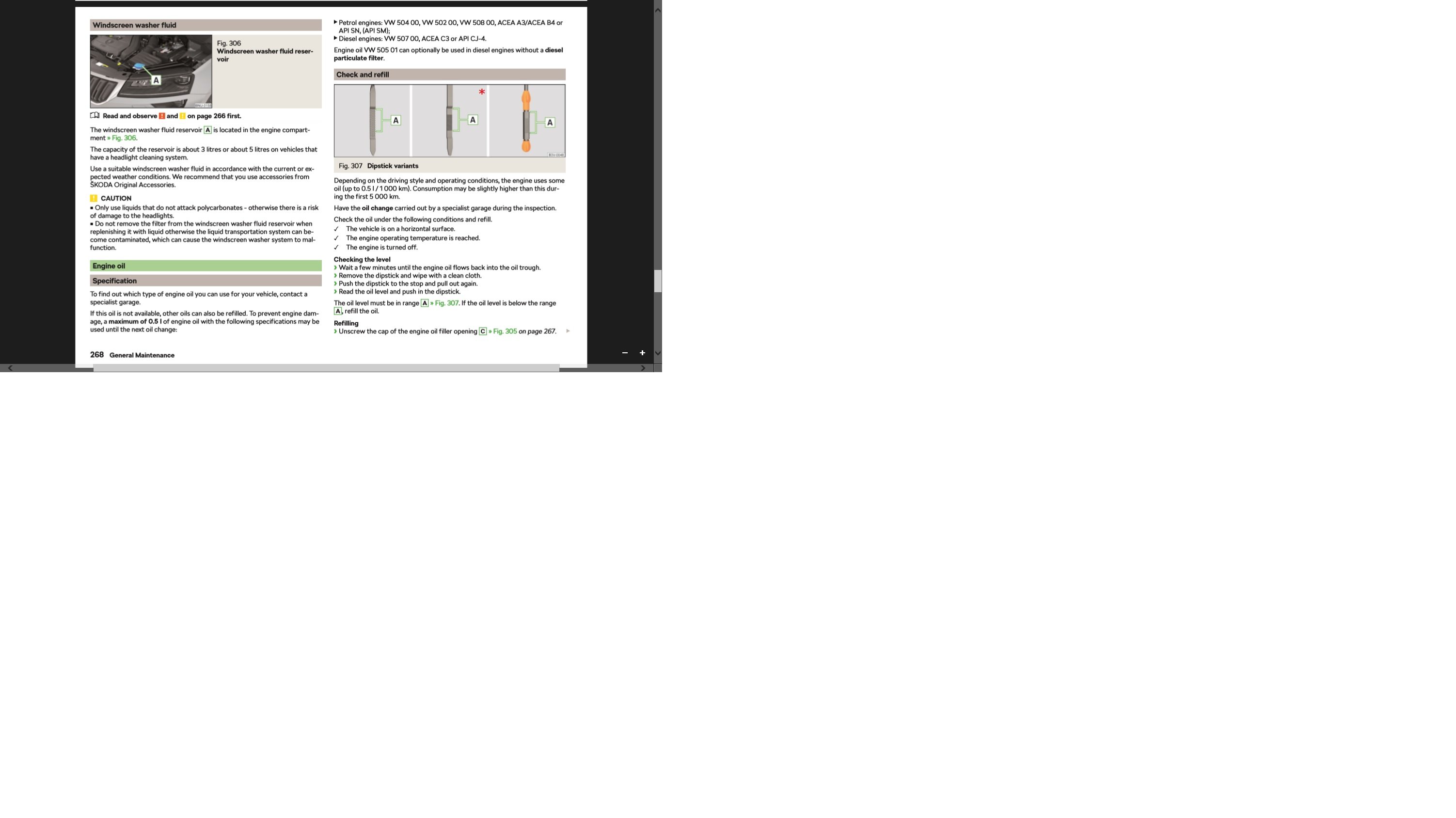

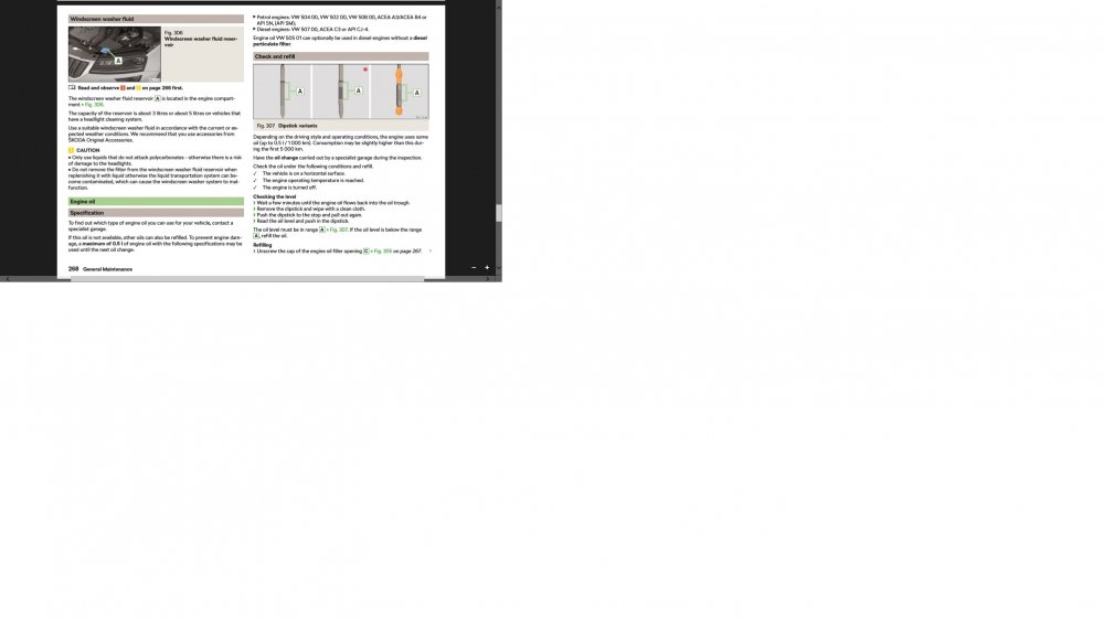

Just coming up to the 4000 miles mark and had to top up engine with a small amount of VAG 508 oil to keep the level within range "A", so it's true what they say that the engine uses oil, a new experience in a new car.
