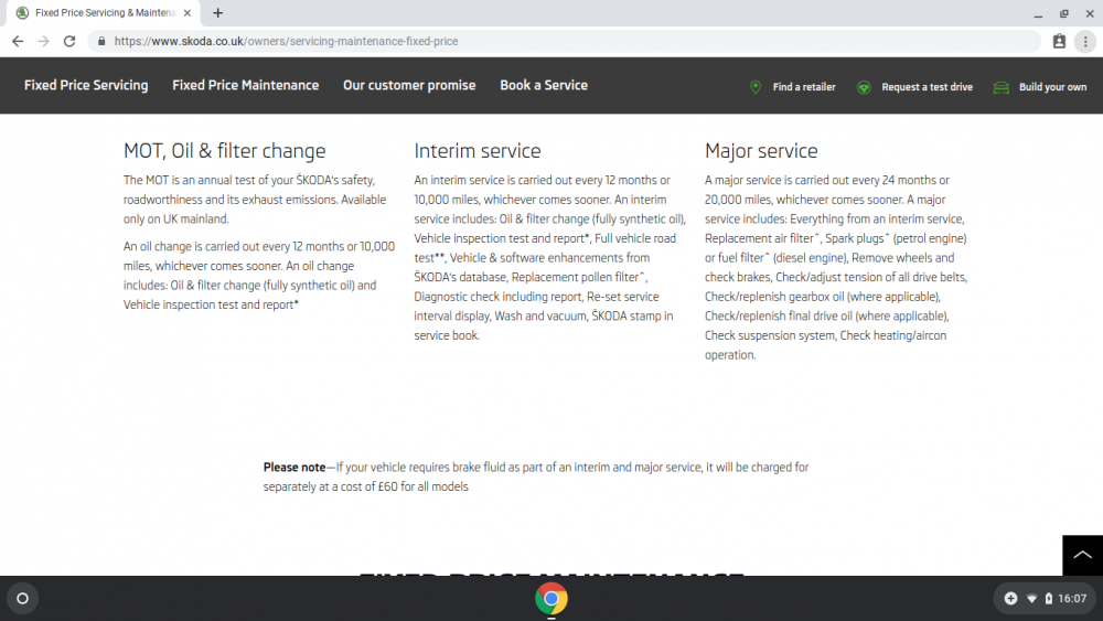

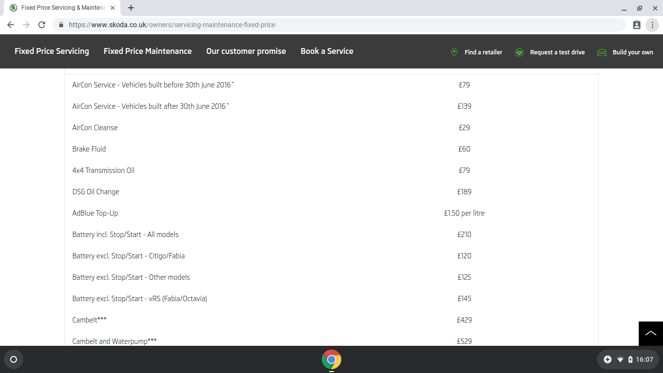

Does anyone know we're I could find a detailed service schedule for the kodiaq 2.0tsi on fixed servicing. Also apparently post 2020MY you don't get an actual service book anymore, dealer said its all kept online.
Cheers.
Service books stopped over 6 years ago.
The Service, report, road test & Body Inspection for the Paint Corrosion warranty Records are online, (be sure they do the body inspection and report)
but the Service Desk staff can easily print the Service Work Sheet showing the service items.
Full Main Dealer Servicing is pretty basic and much the same they say in year 1 and 2 as year 3 on as in the Fixed Price Servicing for car 3-10 year old.
On fixed servicing first year, Oil & Filter, Sump Plug, inspection, Diagnosis and any update, free wash and vacuum.
2nd year the same but a Pollen Filter changed.
Year 3 Brake Fluid Change is due.  MOT.
They might call year one fixed an Interim Service and Year 2 a Major service,
if you stay on Variable / Flexible servicing the will call the 1st service a Major one, but no plugs checked or changed and not even the Air Filter in some cases.
Maybe year 4 spark plugs and air filter changed, but they charge the same if not changed and maybe took that price in year 2 if you let them.
They will tell you at year 2 the A/C service is due.
More servicing is as you ask for it, and pay for it.

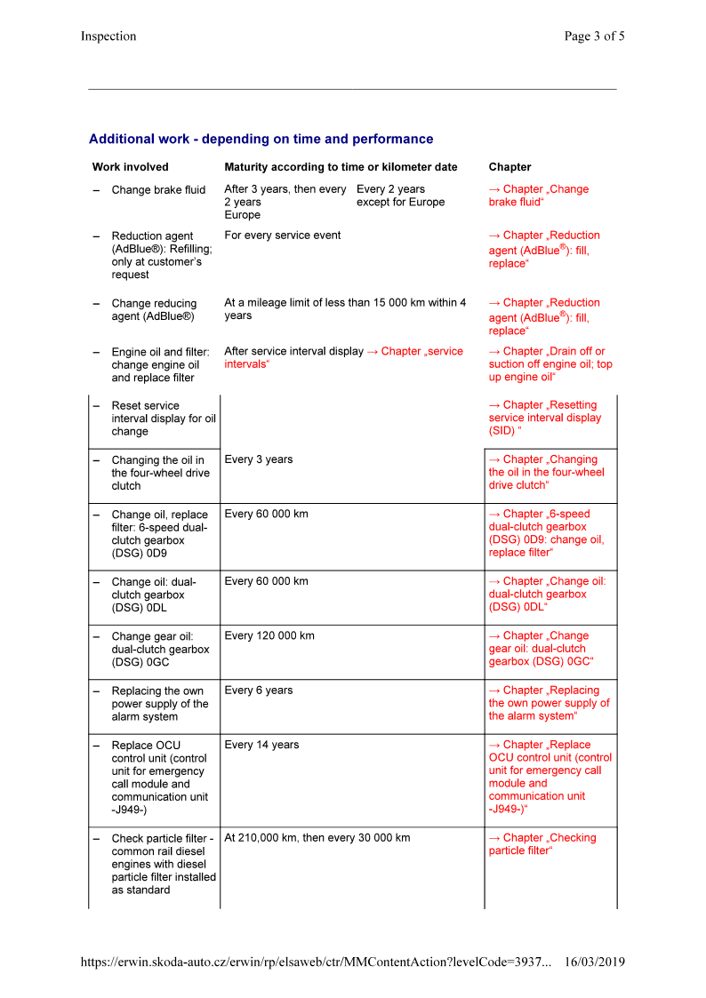

Haldex @ 3 years or sooner, or that could be 30,000 miles or sooner. depends who is telling you.
Wet DSG's @ 40,000 miles.  or sooner.

My dealer told me that the DSG oil change was due every 40k miles, and Haldex is every 3 years regardless of mileage.

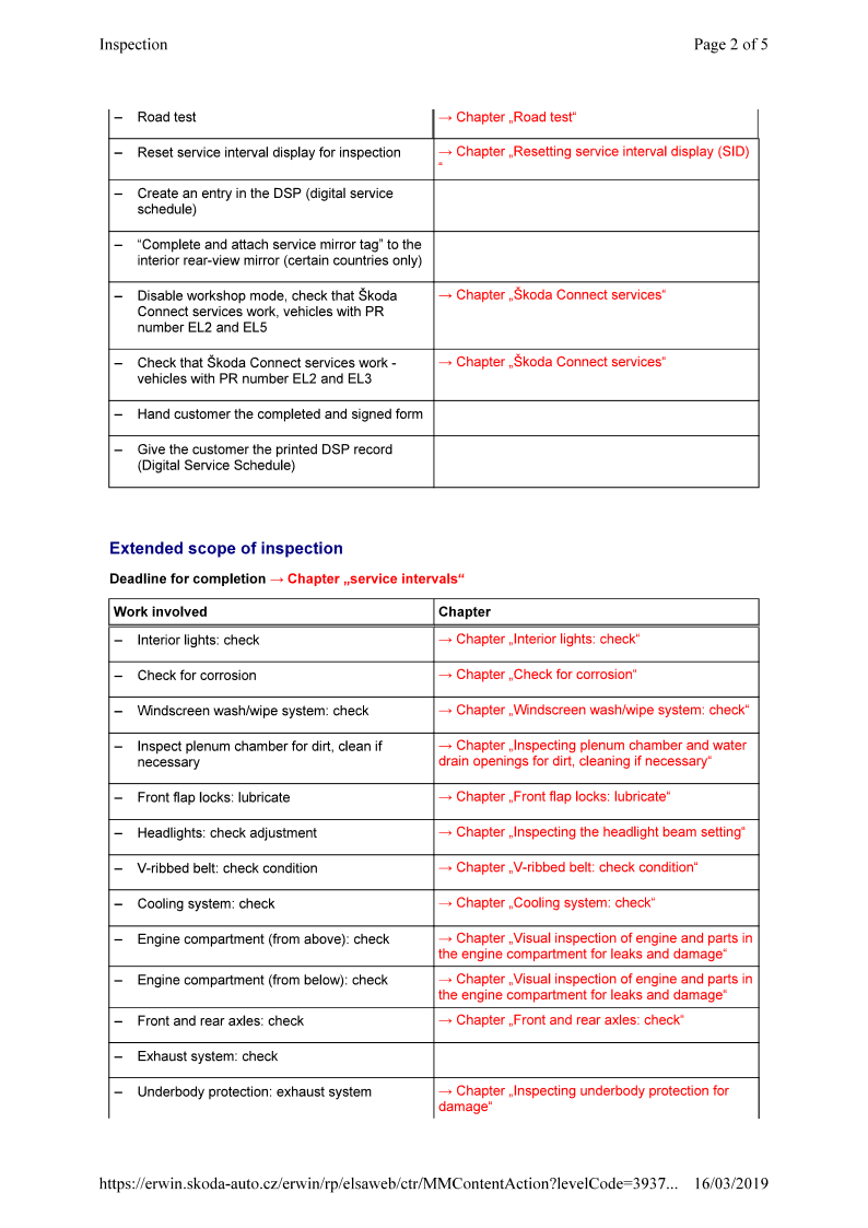

You can pay 8euros for an hour on Erwin, during which you can print out the service schedule amongst many other things. Yes DSG at 40k and Haldex at 3 years, plus spark plugs, diesel filter etc according to engine /model (You type in the Vin, it knows what is relevant to your car).

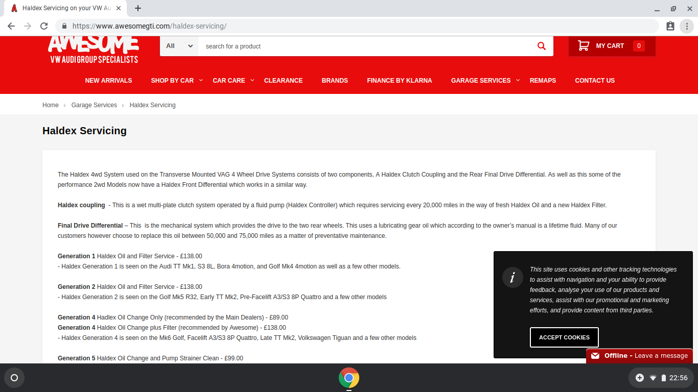

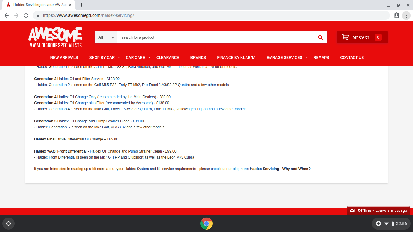

Dealership staff might well say the Haldex is due every 3 years regardless of miles.
Not that long ago VW was saying 4 years and 40,000 miles, then it changed to 30,000 with some places and Skoda still said 40,000,
then it became 3 years and yet some say there is no filter on those that have, then there are those that seem to not know the Diff Oil is something else.
then there are ones now that need the front diff oil change.

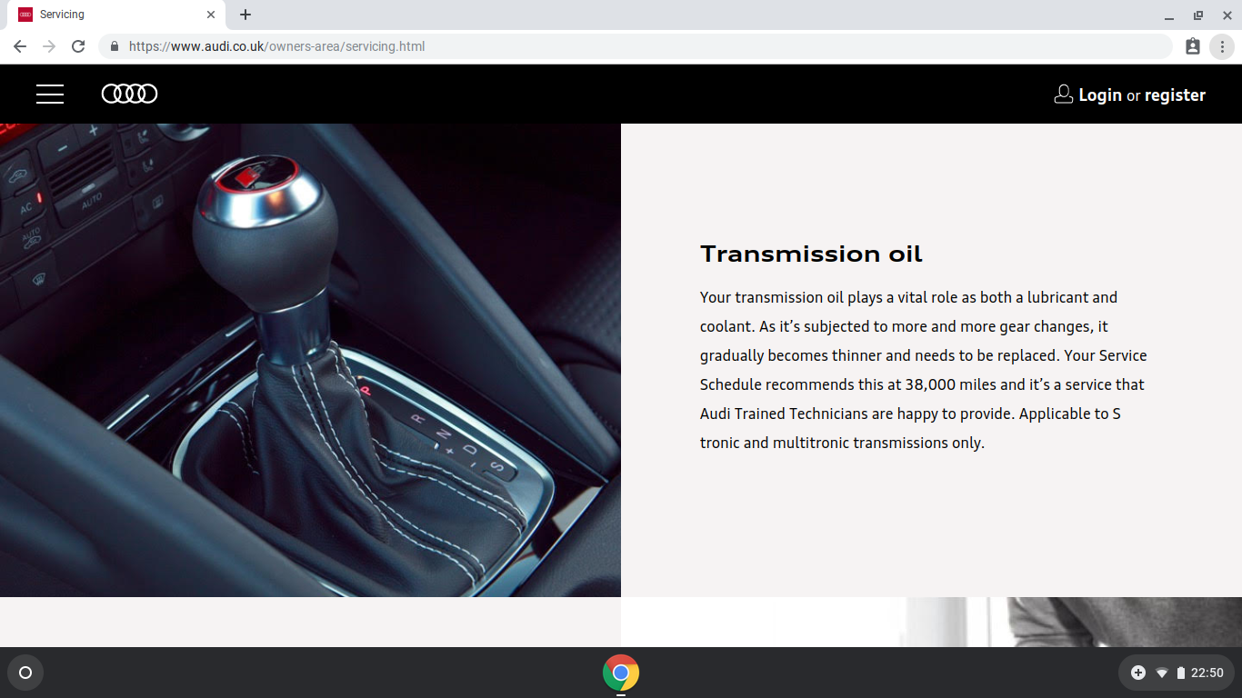

Audi can call a DSG a S-tronic and then the service interval is 2,000 miles sooner.

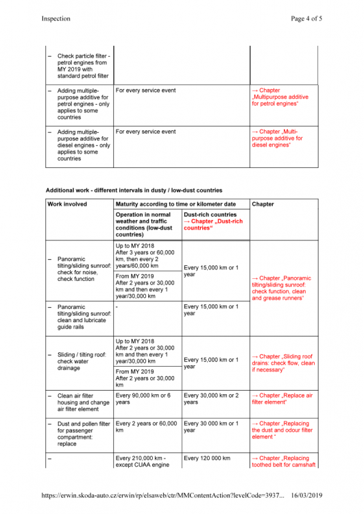

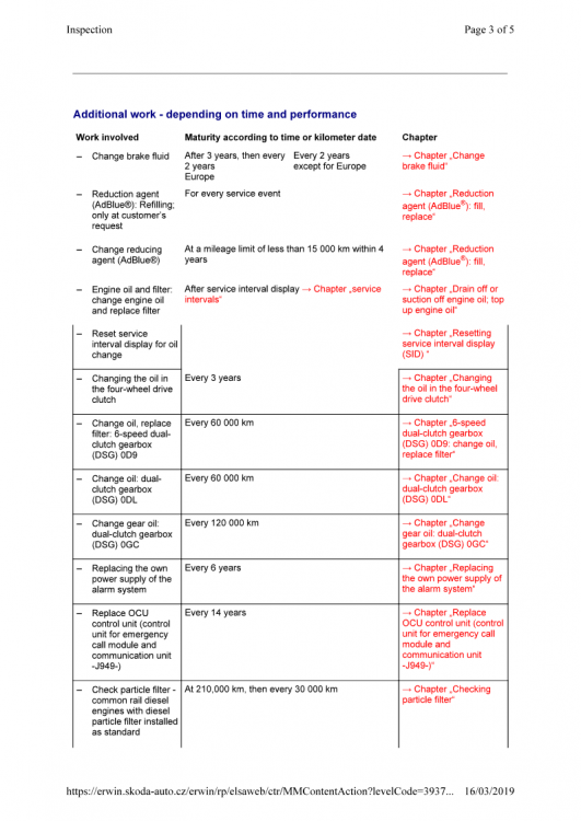

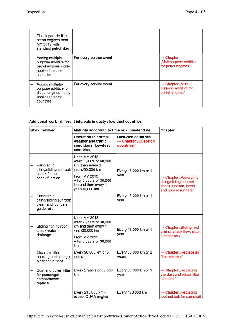

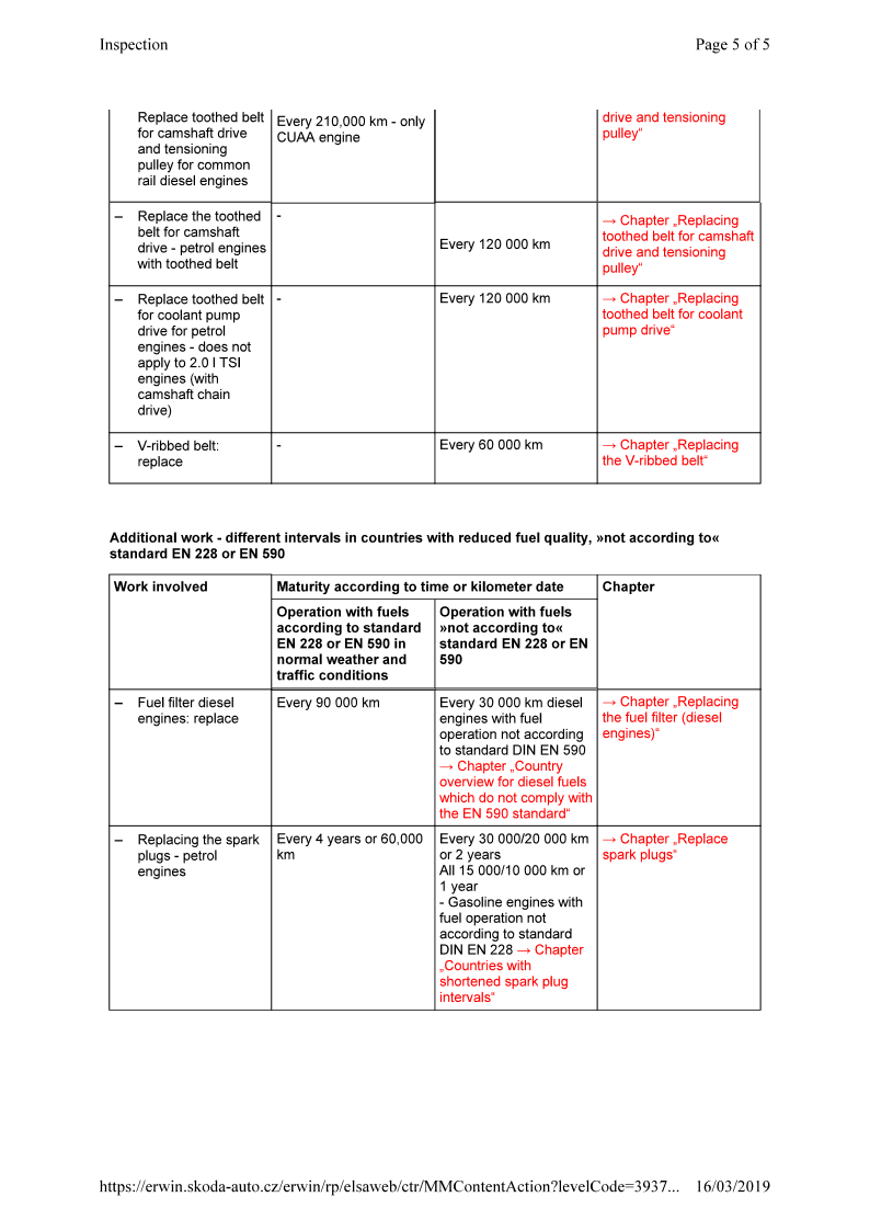

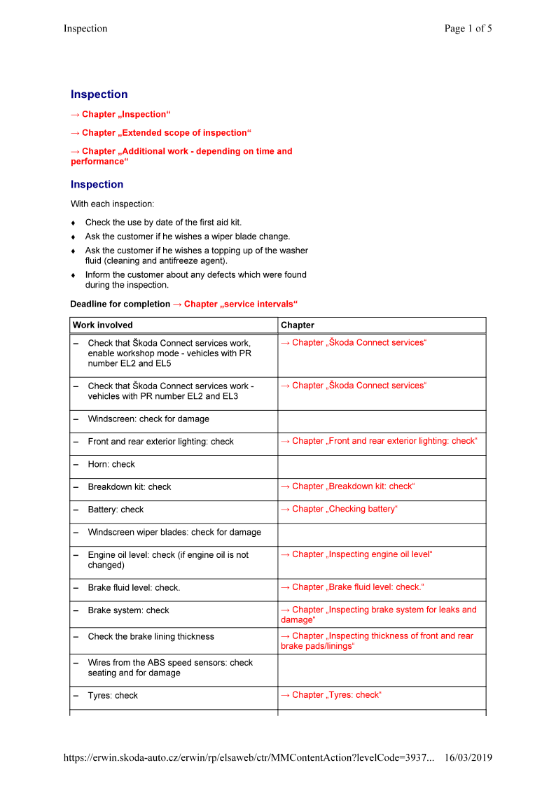

This is the Skoda Service / Inspection Schedule according to Erwin, detailing the extent and frequency of works:
Only just seen this, very helpful, thank you. Bookmarked.
* interesting to note that the cambelt interval on my 1.4 TSI is 75,000 miles (120,000 km's), compared to the diesels at 130,000 miles (210,000 km's).
