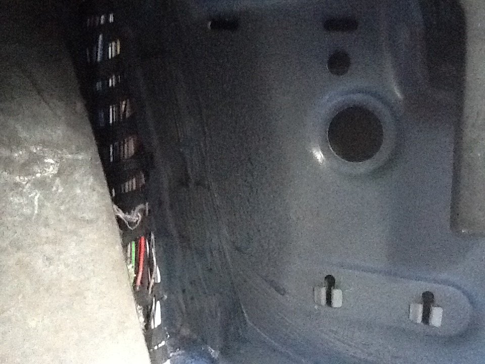

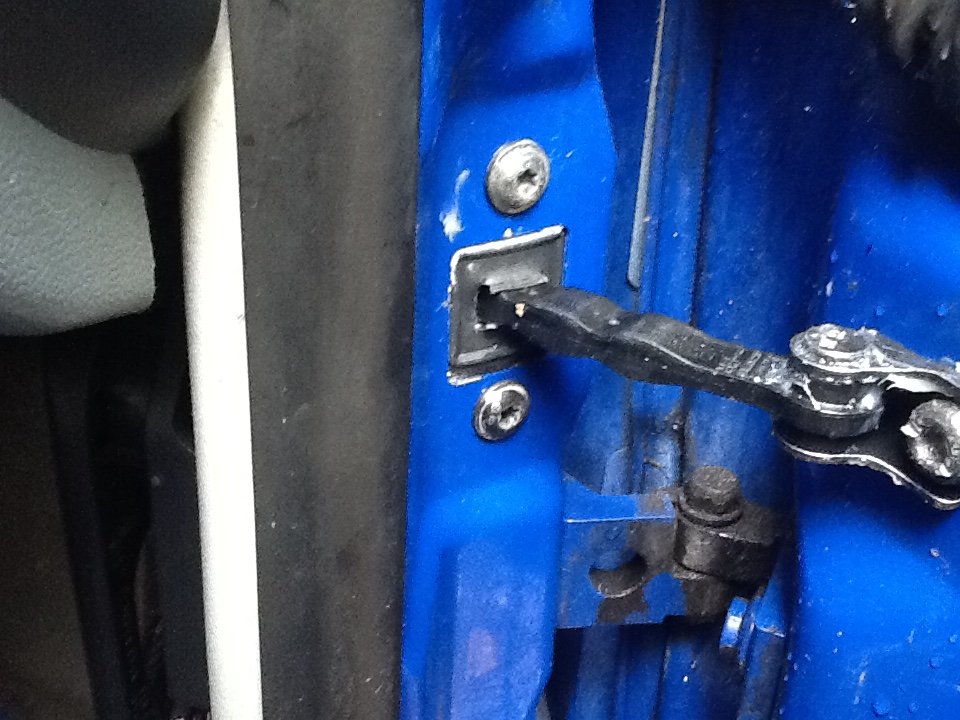

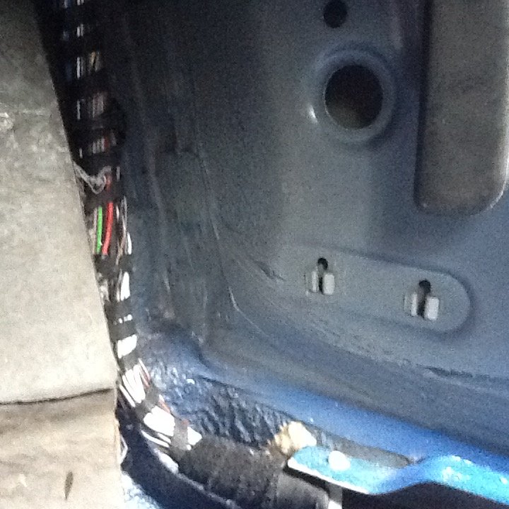

i finally found out that it's coming in through the door stay. Once inside the water cannot get out. It's trapped between the inner and outer sill. It fills slowly up and then enters the cabin. See the photo.
so I replaced the door stay and remarkably it still leaks if you put a steady stream of water on the door stay. The water enters through the hole by the bonnet release handle.

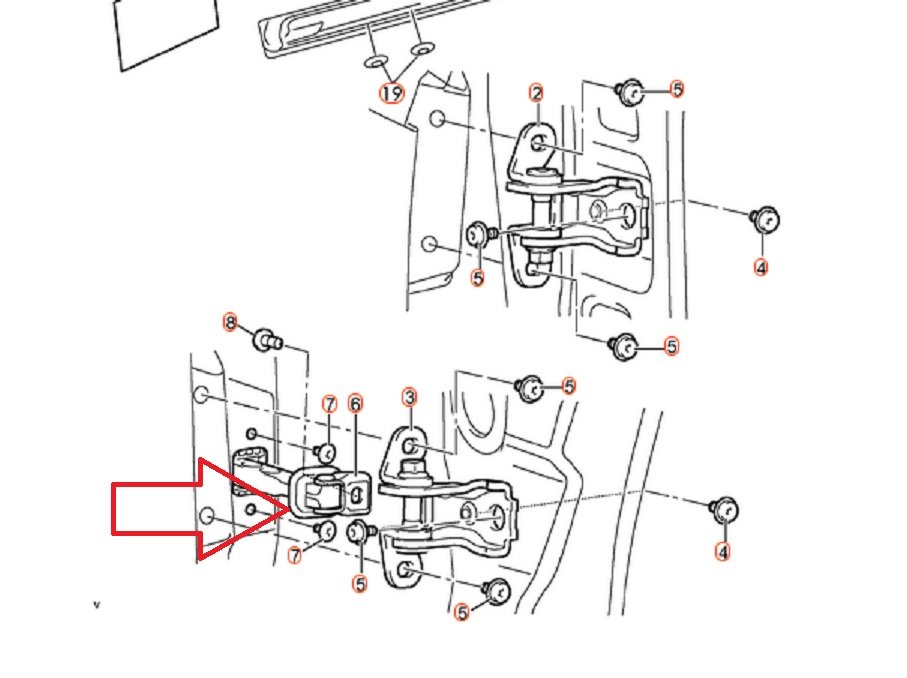

Your door stay seems to be "missing" the square rubber that closes "Over" the stay when the door is shut. (see image attached)
On the flip side, im a little confused...... What year is your Fabia ? on mine (2013) the door stay is the other way around, maybe this was a known issue hence they swapped it.

mine is a 03 basic model. The part I purchased from the skoda dealer, does have a rubber but it fits inside the chassis when you bolt it together.
Ive also spoken to Skoda uk and they have "never" heard of this problem. Yeah right. I've got a Toyota and a Hyundai and both of those have the mechanism reversed, I.e. it's in the door and not the body work of the car.
so are you saying on the later models they have also reversed the fitting, so the stay goes into the door and not the chassis, sounds like a design fault to me.

Are the seals properly seated around the connector group on the A-pillar on that side? That seems more likely to be the real source of the ingress, to me, than the check strap, as it's more 'in the drainage path' IIRC.
Well worth checking the plenum drains are clear and the bonnet cable grommet is in place.
