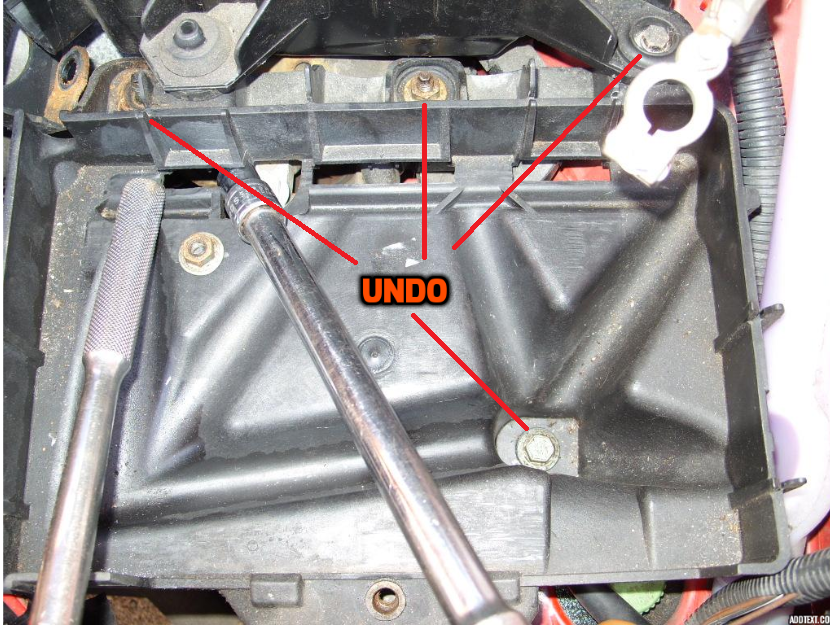

You really do need a basic mechanics toolkit to be able to do this stuff. Remove the remaining bolt.
On the VRS...
One bolt connecting to the air box
Two bolts behind the box holding the rear down to the metalwork.
J.
Ive got plenty of tools, just not either the right one or the right combination

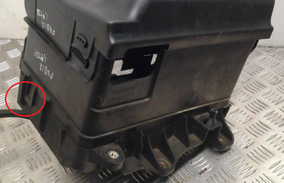

Thanks for that... One last thing, how do I get the big square "body" of the box off. I've just been trying, and I cannot figure it out. (Probably doesn't help I'm ****ed off with it all.)
  • Sponsor
One or two plastic clips on each vertical side, I think, from memory. You have to pull them outward at the bottom, which needs some sort of 'hooky-tooly-thing', unless you have strong fingernails.

Thanks will have to try again tommorow and hope it comes off
I seem to remember using a screwdriver ( but gently) . Then there's the inner cover and finally the 13mm( ??) bolt on the battery retaining clip. Best undone with a long extension.
