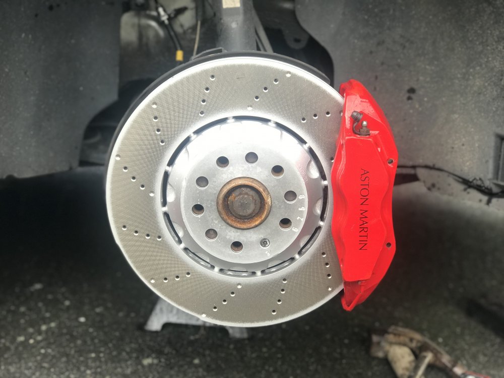

I went with the DB9 setup but if I knew I wanted 340mm discs again for sure I would have gone TTS 8S 4 pots for cost reasons and I feel they would be just as good as the DB9 setup. These were cheap enough to make them worthwhile though.
