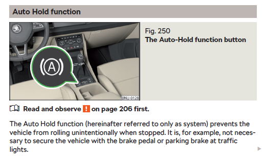

Has he disabled Auto Hold via the centre console button?

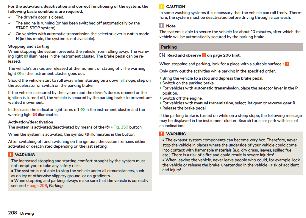

I explained to him if he disabled auto hold.
He told me would it be the button down by the gear stick. With letter A.
Easily done. My wife and I went through a stage where we were sharing driving duties, one of us turned it on, the other turned it off, each one of us forgetting when we got back behind the wheel, wondering why the brakes weren't behaving as they did before.
