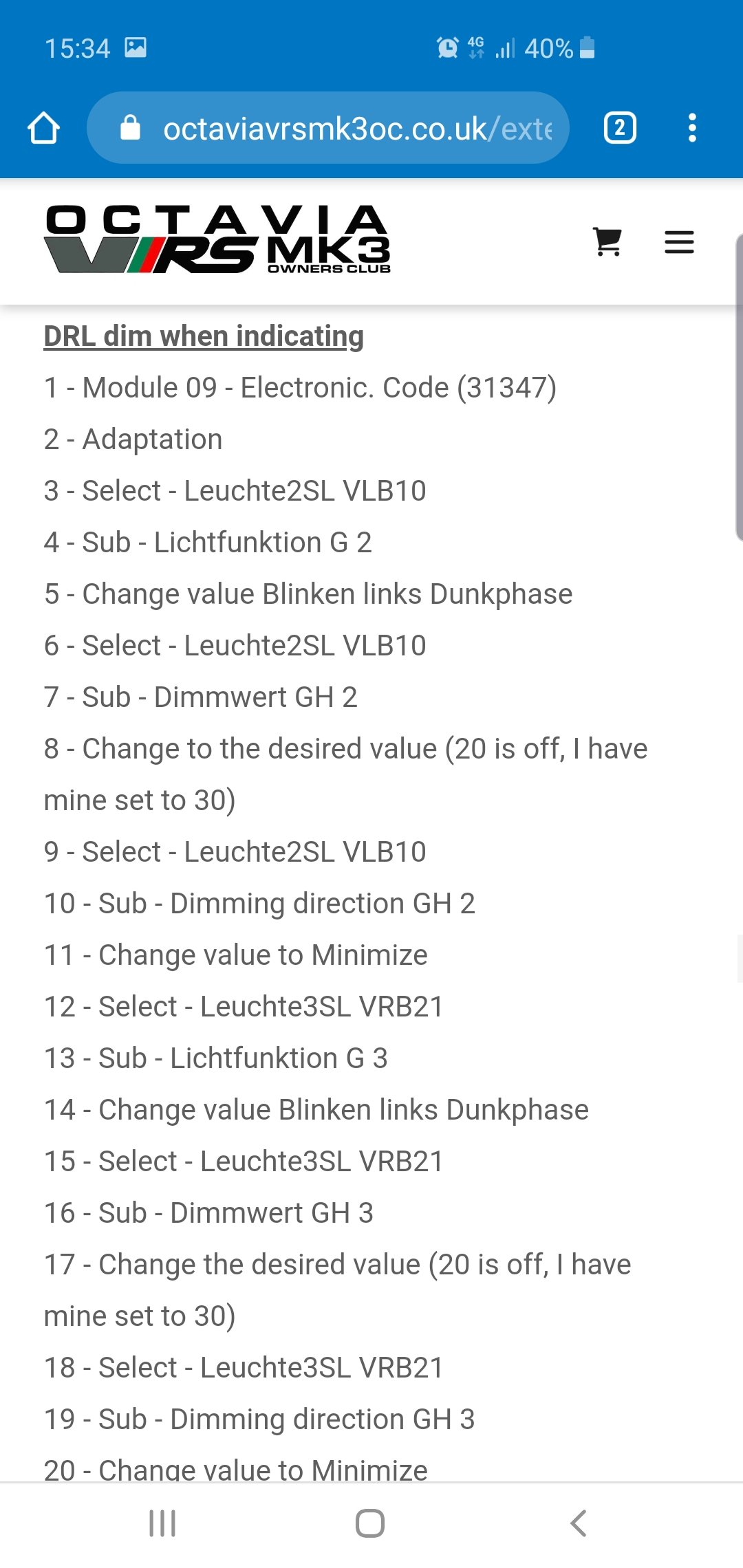

Hi can anyone help.
When trying to get the drls to dim when indicating using the info below I'm getting a weird outcome. When the passenger side indicator is on both drls dim and flash and when the driver side indicator is on neither of the drls dim. Not sure why both sides do it when passenger side indicator is on and nothing happens when driver sides on.
Ive double checked and triple checked the correct datas been entered.
Anyone have any idea what is going wrong or what could I be doing?
Many thanks
Edited by PhillyM88
I am aware of this mistake on that list. The data was copied over incorrectly after I sent it to be uploaded and it’s on the fix list. Many apologies, here’s the correct coding
(16)Leuchte2SL VLB10-Lichtfunktion G 2 from "not active" to "Blinken links aktiv beide Phasen"
(18)Leuchte2SL VLB10-Dimmwert GH 2 from “0” to “35” (20 or less will disable the light bar during indicating) Mine is set to 30
(19)Leuchte2SL VLB10-Dimming Direction GH 2 from "maximise" to "minimize"
(16)Leuchte3SL VRB21-Lichtfunktion G 3 auf "not active" to "Blinken rechts aktiv beide Phasen"
(18)Leuchte3SL VRB21-Dimmwert GH 3 from “0” to “35” (20 or less will disable the light bar during indicating) Mine is set to 30
(19)Leuchte3SL VRB21-Dimming Direction GH 3 from "maximise" to "minimize"
