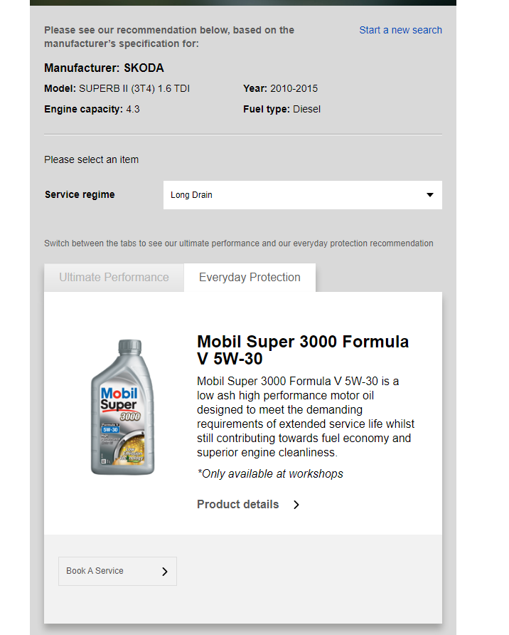

I entered my reg on the Mobil website and it did come up up as Ok

From what I can see on Mobil's literature for it, it doesn't have any VAG approvals. That doesn't necessarily mean it's not suitable, but it requires additional due diligence on the part of the owner and/or mechanic to ensure it's appropriate. You will need to verify that the oil meets the requirements set down by Skoda for the engine; the suggestion from your search on Mobil's site that they consider it correct may be sufficient. If you're concerned, be sure to take a screenshot or printout of the search result to keep on file should any issues arise down the road.

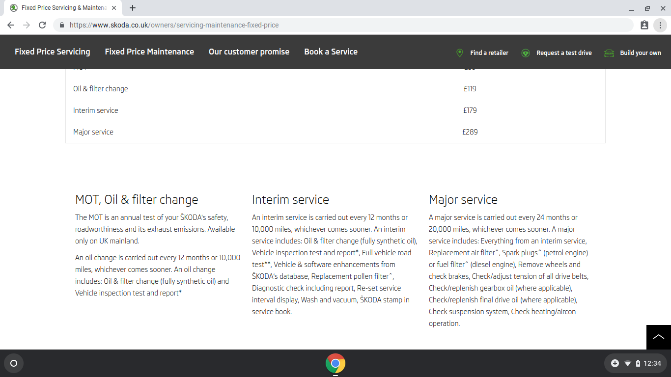

UK Skoda participating dealers doing fixed price Oil & Filter changes and a health check are @ £119.
Still plenty money, but correct oil and as to Sump Plug in or out, then even if oil is sucked out the Sump Plug should then get removed and a new one fitted.

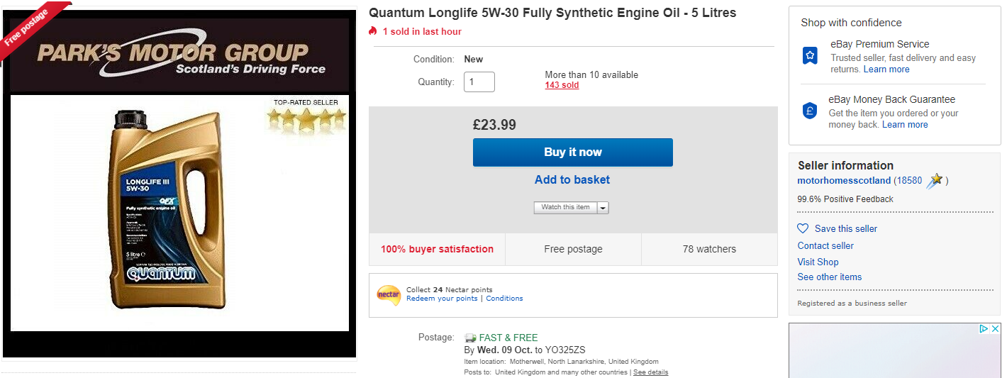

5 litres of genuine VAG VW 507.00 oil delivered to your door from a franchised Skoda dealer for less than £24...
https://www.ebay.co.uk/itm/Quantum-Longlife-5W-30-Fully-Synthetic-Engine-Oil-5-Litres/223613948218?hash=item34106e113a:g:ubgAAOSwk75dSZyD
