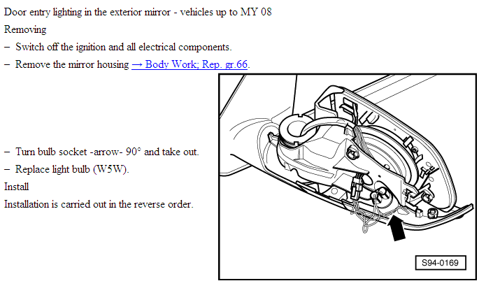

Just found this in the factory workshop manual, unfortunately the Body Work reference doesn't exist.. Hope this helps!image.png.94775cf783c3ba0e33ff1f79fedb1276.png

Took the thing apart yesterday to have a shufty at the gubbins. The whole indicator part was full of water! Took the puddle light lamp holder out to change the bulb whilst I was at it but the bulb just crumbled and broke. Luckily I didn't slice my fingers to bits but spent half an hour digging bits of broken glass and corroded element out of the holder.
Looks like i need a new assembly for this.
I notice the new ones have a different electrical connection. Mines a 2004 model. I will need an electrical adapter loom cable for this. Seems like total cost is going to be £60+ just to change a repeater indicator!
Any one know of a good Pattern part for this? Or is it OEM only? Needs puddle light and wire adapter.  Or any part numbers for the above items? Couldn't find a VAG/Skoda stamp on mine so guess it might have already been a replacement?
