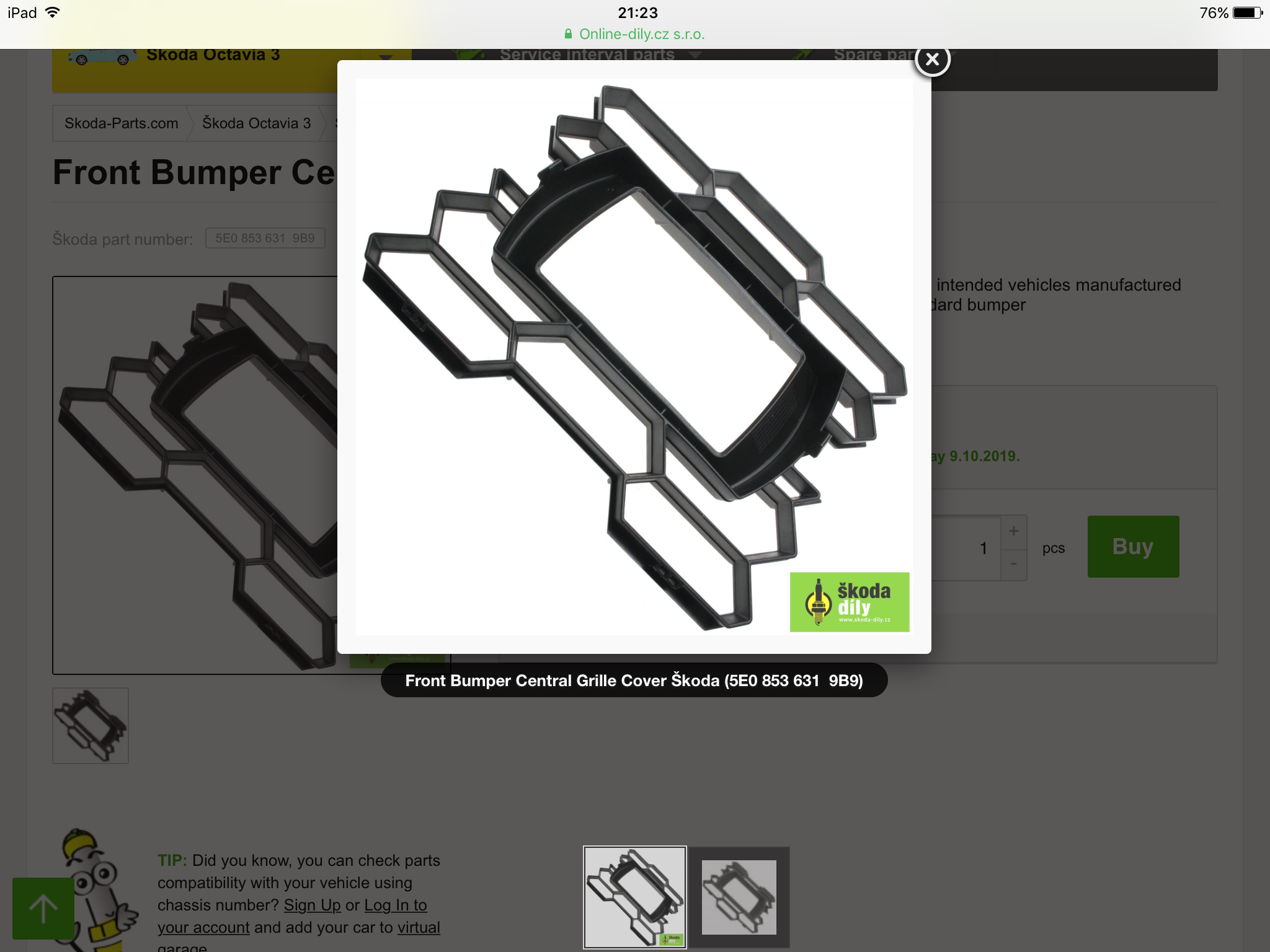

Front Assist Radar Grill
New owner and I did wonder if I was missing this grill and after looking at other cars I am.
Anyone know how it's fitted. Does it just clip onto the radar unit or into the surrounding grill.
Font assist does work fine on the face of it. I get the distance warning and had one event where it bleeps at me. But can it be checked with Vcds as I own a genuine version.
Thanks.
VCDS won’t tell you if the part should have been fitted. If you have a radar on a PFL and this trim isn’t there it clips to the lower grill AFAIK.
It clips into the surrounding grill.
My second hand car was also missing this piece, I went to a main dealer (car bought at indie dealer) and they ordered the part for me. £13-something together with the boot hook, which my car only had on one side.
If you can see and touch the radar, a black square in the lower grill. You have pre-facelift car.
If you can see the grill patterns but not a box shaped opening for the radar, you are missing this piece.
My car is a MY14 Sep 2013 Elegance with ACC and front assist. Out of interest, what year and spec is your car? May be cars from around this time are all missing this piece?
Clips into the surrounding grill, needs a little force

Yep, that is the radar. Yes, you are missing the piece in first post.
Best thing to do is to buy from main dealer parts department, they'll be able to order the EXACT one for your car.
