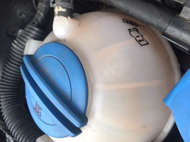

Does your expansion tank have "mit silikat" written on it anywhere?
Can’t see any wording?
  • Sponsor
That's good.
Some recent cars have bags of silicates in there, and they have occasionally been known to rupture, depositing gritty solids throughout the system, blocking stuff.
