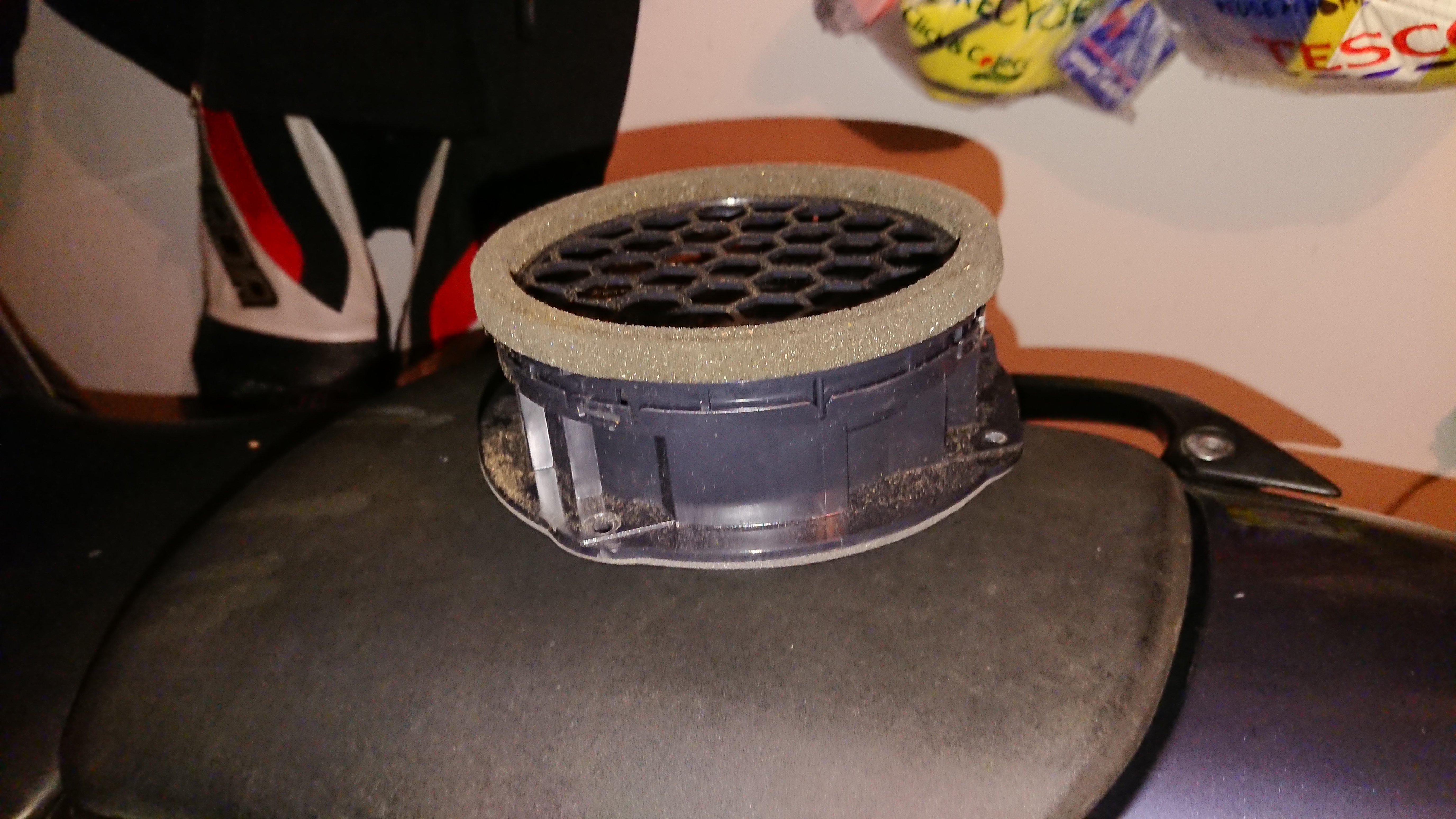

They look like this.  Basically they've got the adapters built into them and a grille that goes over the top to bring them up against the door cards.  If you've got the Canton system, the front 6.5s are 8 ohms and I think the rears are 2 ohms.  The front mids are 4 ohms, I'm not sure about the tweeters, but I assume they're 4.

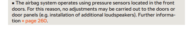

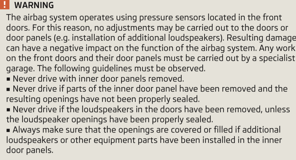

Piece of warning, manual states that upgrading speakers is dangerus because it can mess with the side air crash sensors. I wouldn't risk it. Essentially it means that sound deadening is also not allowed (which I did).

Hi, I'm having the same problem-the nearside front door speakers have blown. Have booked the car in to an auto ICE specialist, and he will be upgrading both doors with Audison two-way and tweeters-but I've just noticed a thread on here suggesting no upgrades should be done as it interferes with the air bag set up. Is this true?
18 hours ago, keneddy said:
Is this true?
Yes, it’s true, but read the entire text…
Basically, the door cavity is a sealed chamber, if there was an impact on the door the pressure increases and this is picked up by the sensor,
So yes, you can add additonal bits, but they need to be sealed to the door and air tight.
