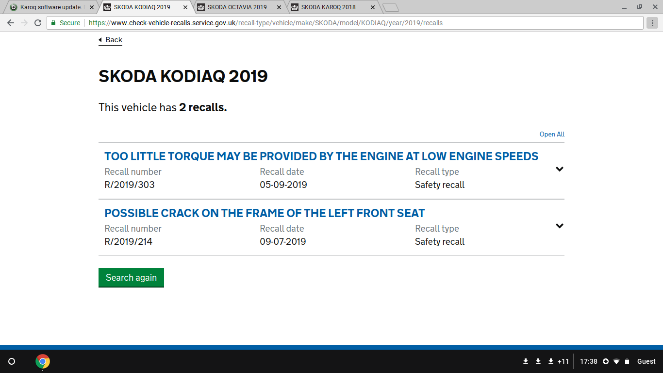

This seems to be the recall action on my Kodiaq (built May ‘19).
I’m told it’s a software update to correct low acceleration, which I guess is the ‘kangarooing’ affect people have reported. Haven’t noticeably experienced it myself, so hopefully it’ll just be a quick trip in for the update to be applied and off again.

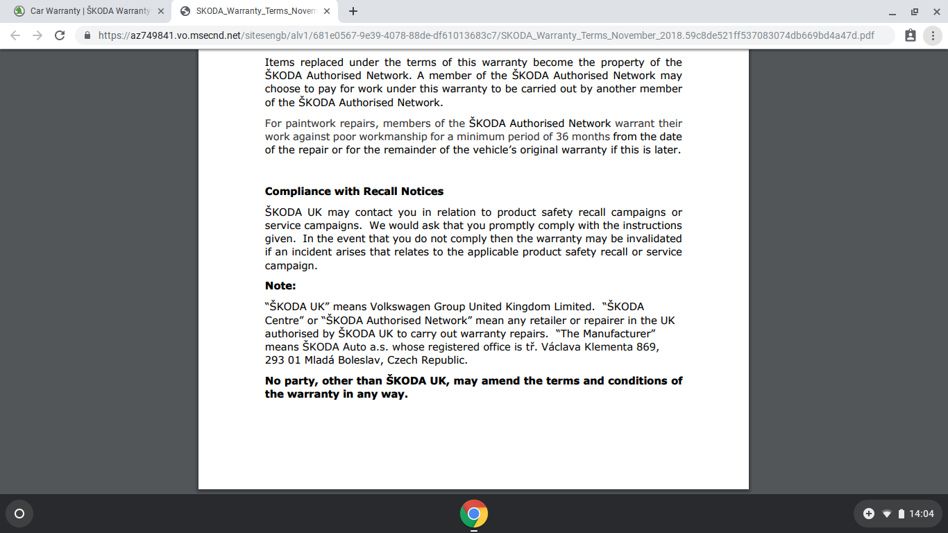

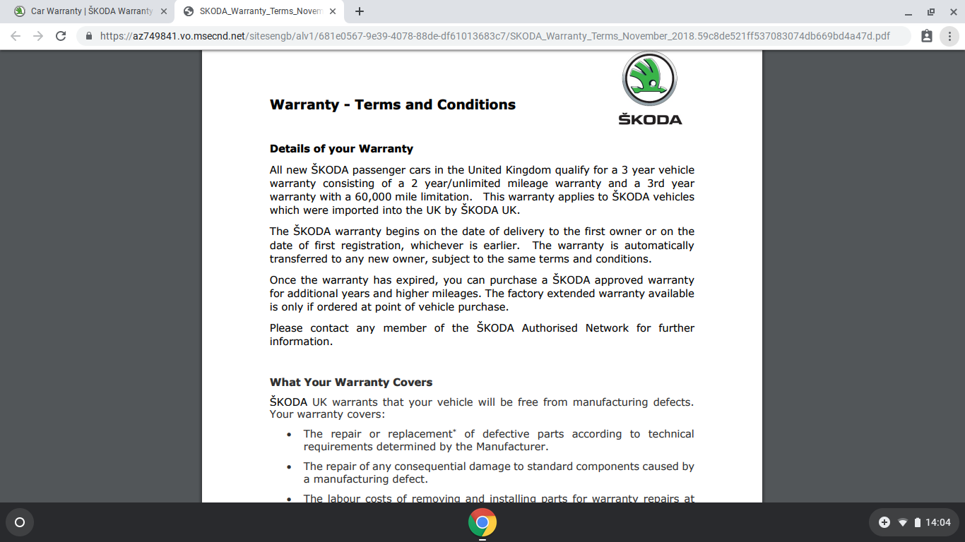

Is it not better to not have the Software Update carried out, especially on a vehicle performing as it should with no issues.
that is unless Skoda says your warranty might be void.
If they do say that, then they need to be giving some
'Peace of mind guarantee that if Updates are done and it ruins a vehicle, they will take full responsibility.'.  Financial Liability.
Nobody should take a vehicle into a Main Dealership to get a Service or some work with it running good and then a software update intoduces a Characteristic that was not present before.
RE
Recall campaigns or Service Campaign compliance.
If they are Contactiong you then that is that, if you do not know, then not really a 'Recall or a Recall Action.  It is a Skoda Secret Service Campaign..
