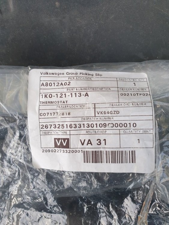

The part that needs replacing is the thermostat mounted on top of the oil cooler. Fairly simple job once airbox is removed. Have included picture of the part number should somebody need it.

One of the parts descriptions I have seen said this - which agrees  nicely with your experience : "This inline thermostat to the DSG cooler can stick open and cause the coolant temperature gauge to fluctuate and the coolant struggle to get up to temperature"
