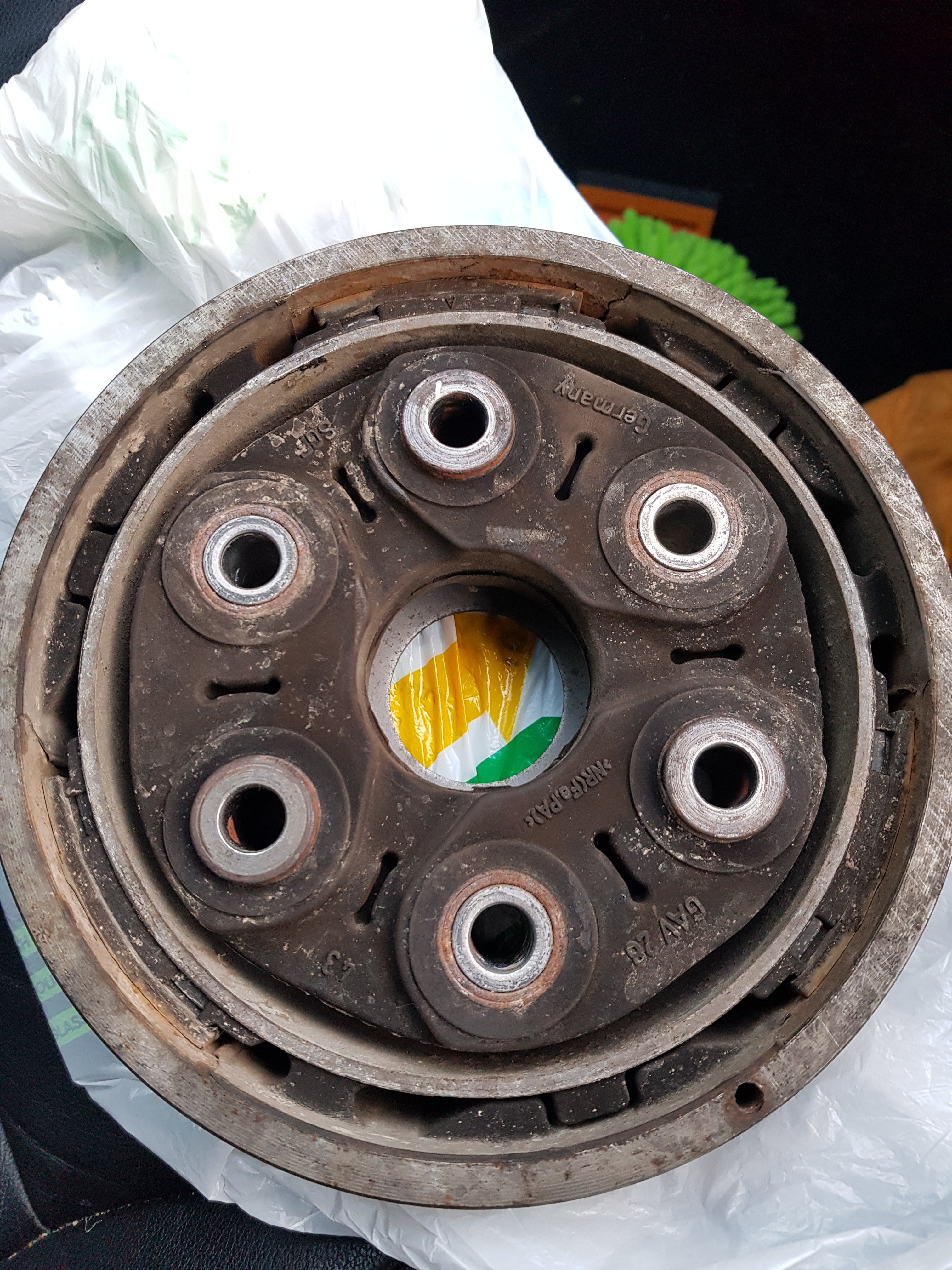

Had the car inspected at a local garage.  When it was up on the ramp, I had a good look.  The rear coupling has a metal ring around the outside.  It looks like this is almost free to do what it wants and there are lots of cracks in the rubber inside it.   Garage is going to replace it and see if that sorts the problem.

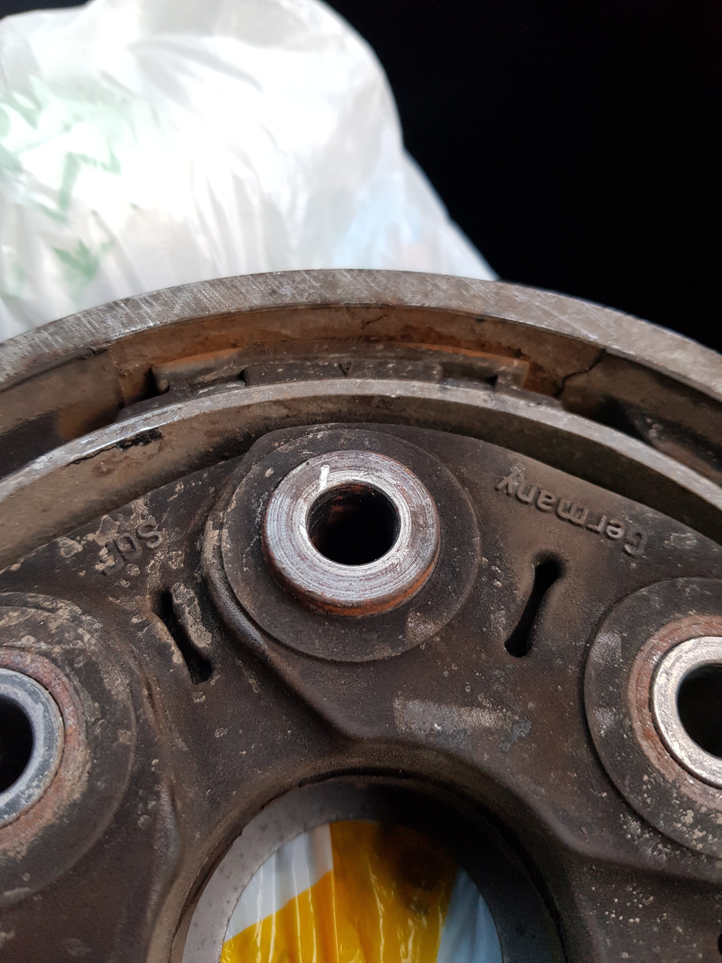

Problem now sorted. The rear coupling/damper has be replaced with a new one, and all the vibration has gone.
On inspection, the outer metal ring is bonded on in six places.  Three big and three small pads.  All three of the large pads were bot attached to the outer ring, thus allowing too much movement, and much vibration.
You can see the orange corroded areas on the outer ring on the attached pictures.  These are the pads that are no longer attached.
