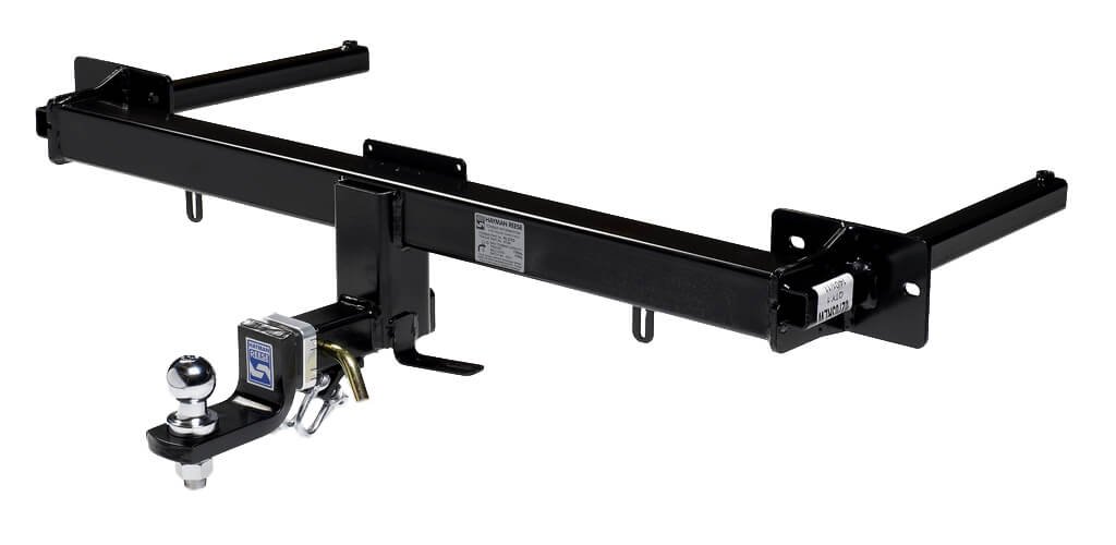

I thought the towbars in Australia were different to those here in Europe?
Whilst I was there all the ones I noticed had an interchangeable square interface...
Class-3-Standard-Medium-Duty-Towbar-40mm-hitch-receiver-Generic.thumb.jpg.e4323e42927763a093e03baeb7450d6d.jpg
This might mean that the Skoda OEM partner for towbars (Westfalia) isn't applicable in this instance.
